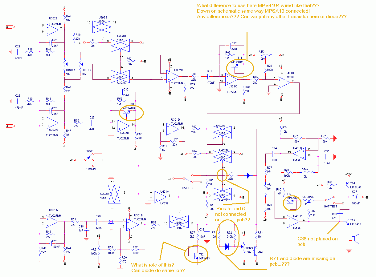

I am in the middle of building 1266....Some doubts occured now????
First, i noticed on many schematics that transistor is connected with
emiter and base togather(shorted) or in other case collector and base???
What is role of this kind of setup??? Can we use plain diode instead
transistor??? Also there are 2 cases on 1266 schematic where; on one place
MPSA13 is used with shorted base and collector, on other place with base
and emiter shorted ??? What is difference??? Also,on same schematic other
type of transistor is used in simillar setup - MPS4104 with base and emiter
shorted??? Is there any differences if we use other type of transistor with
shorted b+c or b+e...???

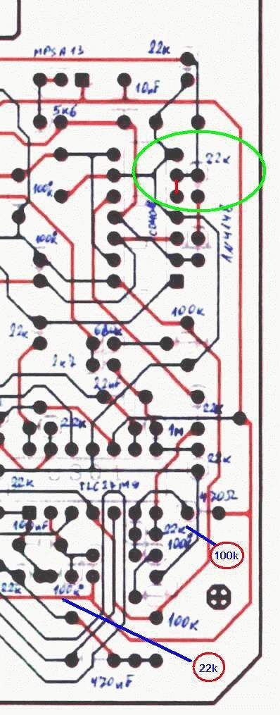

I also noticed few differences on pcb and schematic. On U402,pins 5. and 6.
are connected on schematic but NOT on pcb???
Or,R71 and diode are omited from pcb,also C36(47pF)....
Also i found out different values arround TLC27M9 (marked on posted picture).
It is very possiblle that pcb's have more mistakes (or maybe schematic?)...
So far i found those,mentioned...
Also i do not know how to connect VP0104....? Pin assign. is in S G D order,but
i can not distinguish which one is on schematic???
Posted photo of 1266 is blur enough,man can not see cleary....
I was thinking to replace those MPSA13's (with shorted b-c or b-e) with some
ordinary transistors.....which one? I would like to avoid BC517,since i do not
have those now....How about BC550 or 2N2222 ???
MPSU51 is easy to replace with BD138,only different pin assign.
So, anybody know answers??
:mad:
you have to be moore flexible. tranzistors are small signal pnp and npn and d'snt matter what kind.
schematic of sound is rely terrible thats why take another - i took from F1280
u402 6,5 is for batt check i dont make it all. bat check make with two npn and led - led go on when bat is low.
t12 and r71 are limiter you can trow them away.
would you like my version ?

Hi Ivconic.
Lets go
As i remember (if i remember good) transistor is connecting as low voltage zener. I have an article about it.. I"ll find it and write you again. So i think that you must put the transistors (no diode:mad: ). Now if you can put another transistor for MP4104.. YES but who transistor gives the same zener voltage:mad: ?
On U402 pin 5 and 6. Make a jumb on pcb (you must do it).
About R71 and diode try without them. I think there is not problem.
C36 (47pF) is for selfoscilations. Solder it on the back side of pcb.
I"ll write you again later (i must go out). Don't afraid
. 1266 will work.
BUT will work Better
than Fisher1266. I am sure. Try it
