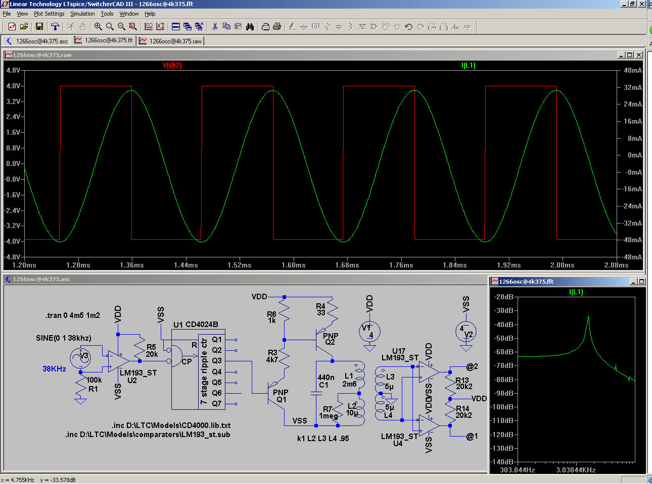

                  1266 frequency
                  Dear Satel-
                  If you use a 38Khz crystal and the CD4024 Q3 output (divide by eight) you will get a 4.75KHz output. The 1266 operator manual lists 4.8Khz in the specifications.
                  I don't have a clue what the 1266 coil inductance is, but 2.6mH resonates nicely with 440nH (two 220nH in parallel).
                  Attached is a screen shot from a LTSpice (freeware) similation. You can't see my cursor position on the spectrograph spike, but the lower left hand corner lists frequency and amplitude of the peak.
                  I used some models downloaded from the LTSpice user's group website. Unfortunately, CD4024 and LM193 models aren't part of the the basic LTSpice download. But hey, Linear Technology doesn't build metal detectors
                  Last edited by porkluvr; 03-01-2007, 09:23 PM. Reason: Smiley face displayed instead of desired text. Edited for clarity.
