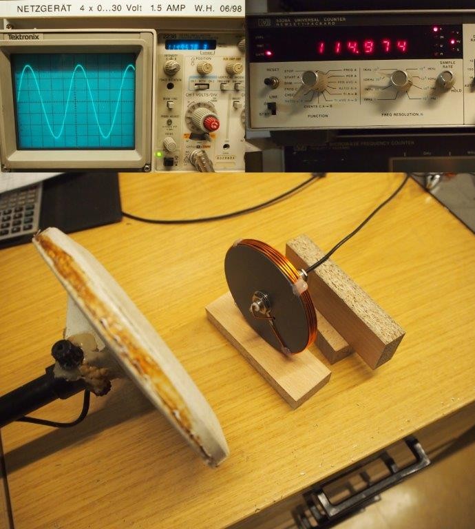

        Are you sure the frequency is 120 Khz ??
        Savvas
          Good evening Savvas
          Indeed... you made me a little bit unsure (would not be my first error in 70 years of live). So i double-checked. The HP-5328 is synchronized via GPS standard, TEX 2236 is on 2µs/div. Coupling was made with external coil. The osc is really working on 114...120 kHz. I can sleep well again tonight...
