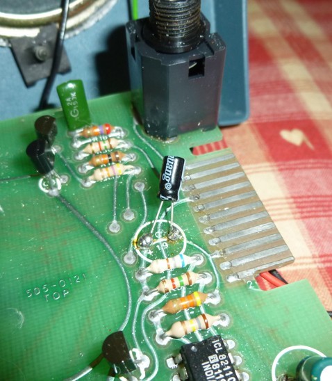

                  two things I noticed Click image for larger version
ID:	439050 Click image for larger version

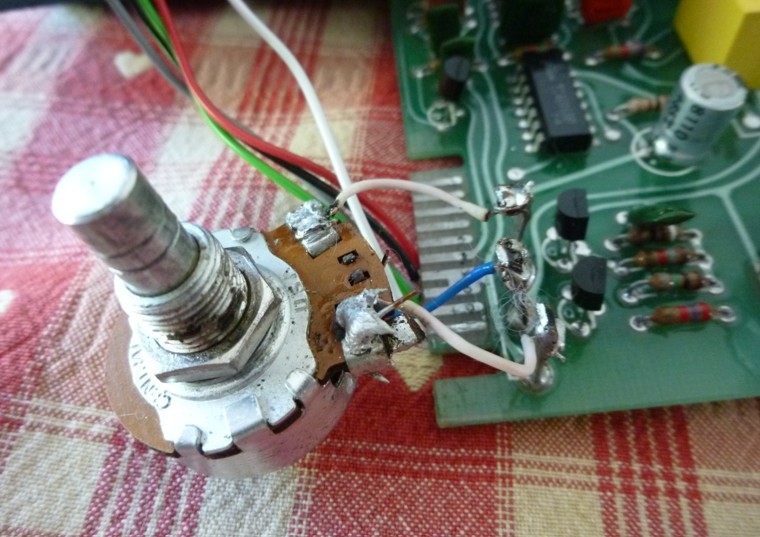

                  small capacitor not sold " factory " way
                  and so for that pot !!
                  obviously it had a life before death !!!

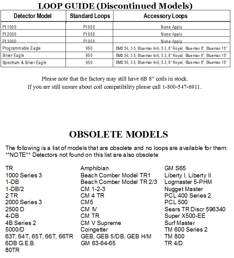

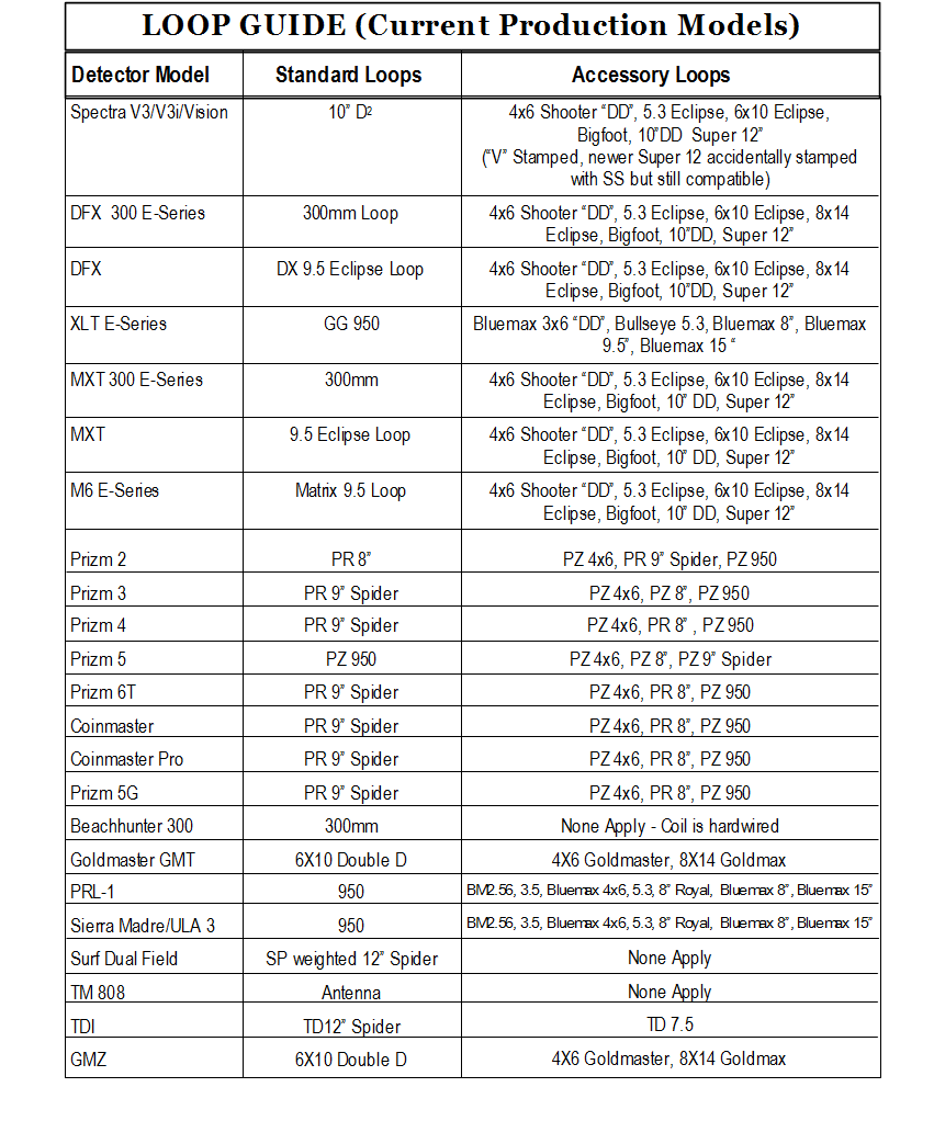

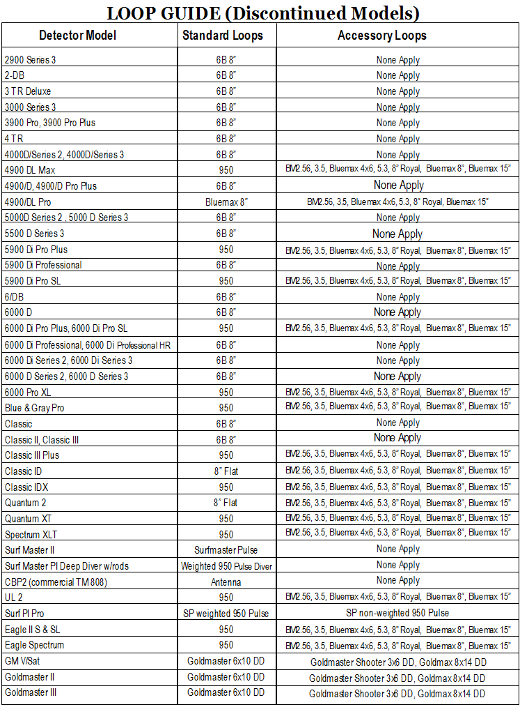

                    Curiosity sake, can you take a photo of its coil and what's engraved on the "ears" on it (usually left one)?
                    Usually it is the type of coil engraved there.
                      6B engraved
                      is that correct ?
                        yup
                          Yes thank you!
                          So 6B.
                          I have 4B and 5B!
