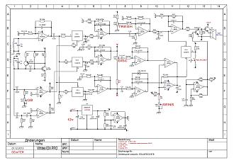

    Hello, colleagues, please suggest a scheme in which the pinpoint mode of the detector would have a ground balance, in this IDX scheme it is missing. Click image for larger version

    If you take another close look at the circuit diagram, you'll see what you're looking for. GB and pinpoint functions are available in this schematic.​
      Hello,GeoMax​ in the circuit, when working in normal mode, does not hear ferrite, but when working in pinpoint mode, it detects it. I want a circuit in which pinpoint mode does not detect ferrite.
        pinpoint mode and ALL METAL mode are same. this is just different names of a part of the circuit.
          Hi Algan,
          like KT315 already said Pinpoint mode is All-Metal mode. If you do not press the "pinpoint button" you can also pinpoint targets in normal mode. If you press the pinpoint button you actually switch the circuit only permanently into All-Metal mode.

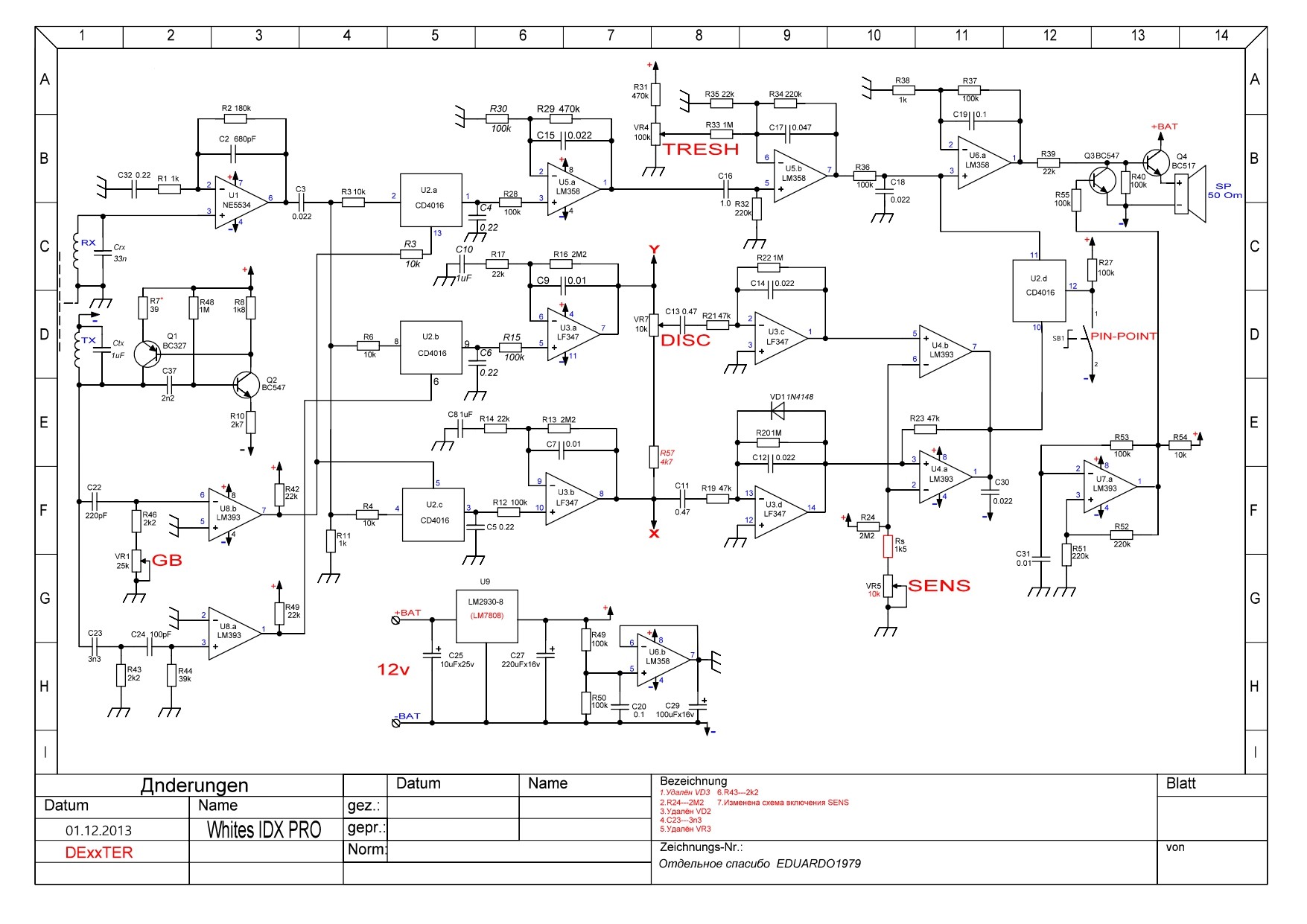

                  The IDX does not have a static pinpoint mode; the "pinpoint" mode only disables discrimination so it is in a motion all-metal mode. In this mode it should be ground balanced, if it is not then the GB needs to be adjusted. If you want a design that has a true static pinpoint and the GB works in both pinpoint and disc modes, then look at the VLF-Disc design in ITMD3.
                    Thanks, Carl-​, yes, that's exactly how it should be set up, first set the GB mode to ALL metals, then when switched to DISC mode, the detector should be set up and ready to go ,but that's not how it works in this IDX scheme,

                        If you short C11 and C13 you will have pinpoint mode but not stable balance for long time, that why is used ground balance button .......
                          I don't see why not... it is the G channel (via U2a) that determines the GB, and it is the targeting channel whether you are in AM or Disc mode. Are you saying if you GB in AM mode it does not remain GB'd in Disc mode?

                              I practice my hobby and do various tests with different schemes. I can check in the air with a stone about 10 cm thick that in air of all metals it detects a coin from a distance of 30 cm, but in discrimination mode the penetration drops drastically to 10 cm. On the IDX scheme I switch to "all metals" mode, the ceramic detects it as metal, and the ferrite detects it as metal. So I will look for another scheme.
