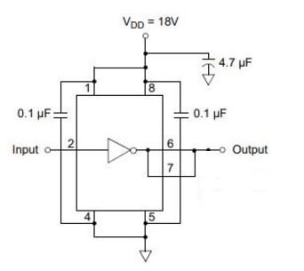

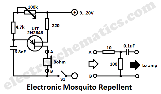

      This is Tx generator, you need to add TC4420 connected to 0.1uF to drive a Tx coil , (serial resonance ) tuned to approximately 200 kHz.
ID:	440251​ Click image for larger version
ID:	440252​Click image for larger version
      Tx coil 20 cm diameter 30 turns, wire 0.5.
      Rx receiver tuned to 200 kHz. First step is making Tx Rx hear the transmitter at distance about 50m then bring them closer to 60 cm distance and adjust Tx Rx antennas.

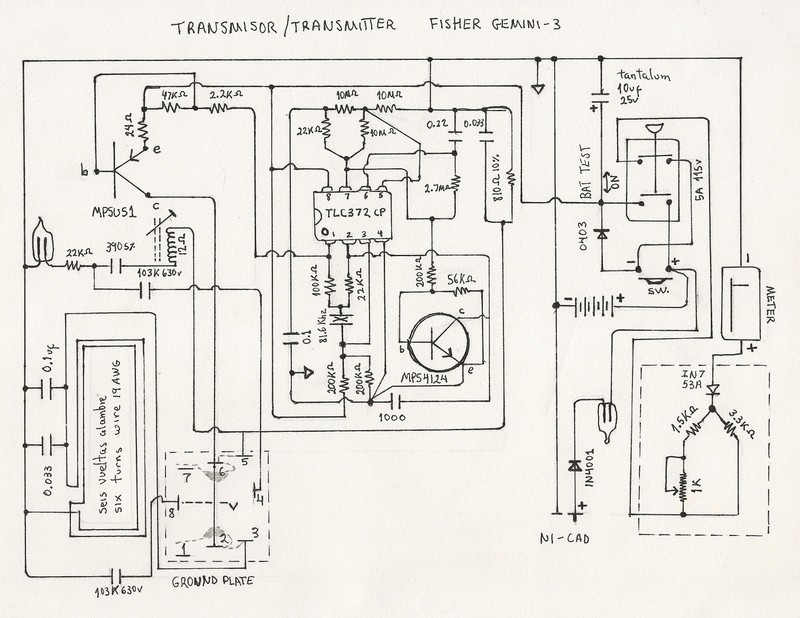

        Do you have a diagram of the Gemini 3 receiver?
        I'd really like to see it, but it's been removed from all the websites because the pages are outdated.
          I only have the transmitter.
            all pics of the boards were got from Koliaj. you may find his in md4u forum. Главная страница • Схемы металлоискателей MD4U •
