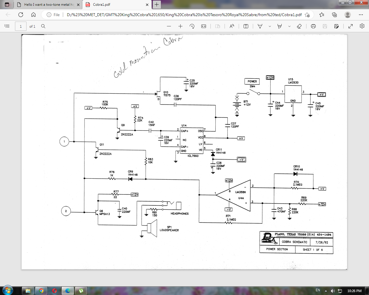

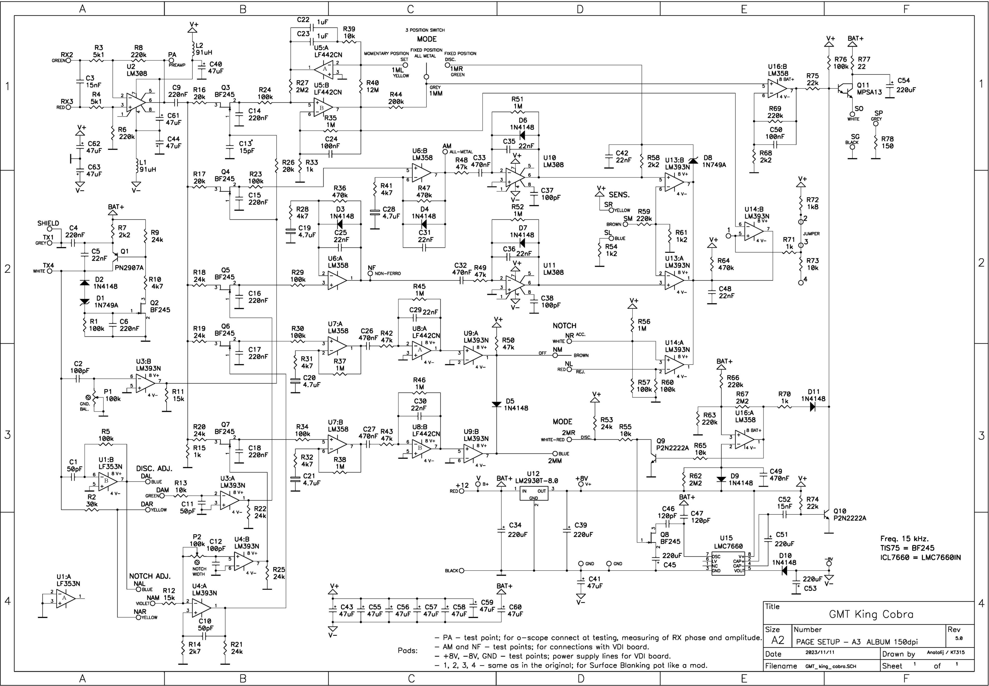

    Hi I want a two-tone metal distinguishing circuit for VLF electromagnetic metal detector so that I can. Mounted on Admiral, IDXPRO or SMW555
    Gold Mountain Tech KING COBRA has two tones.
      ITMD3 shows the details of a a 2-tone circuit and also the concept of a multi-tone circuit.
        On that GMT schematic, is the audio tone generated by the 7660 negative voltage generator, and the pitch of the tone determined by switching different caps on the 7660? Seems a little odd, 220uF in series with 120pF ?
          btw i got FIRM diggest of the schematic. no mistakes. thank you Ted for them again.
          Click image for larger version  Name:	image.png Views:	0 Size:	375.3 KB ID:	441122​
            Thank you for posting that schematic, KT.

              welcome. you will see left firm lists in the Archive. https://drive.google.com/file/d/1P4a...usp=drive_link
