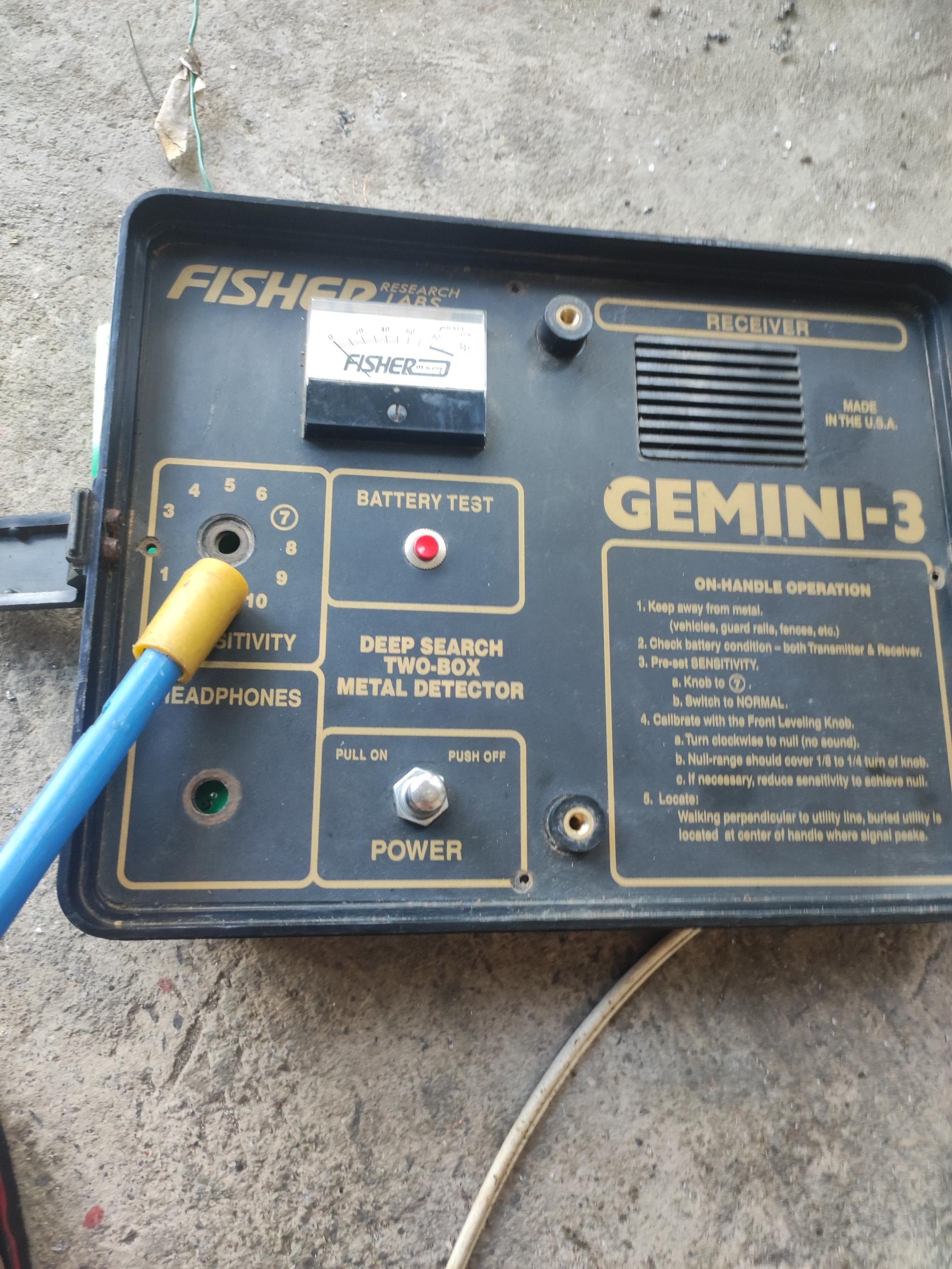

    Anybody have schematic diagram of gemini-3 help me for the value of sensitivity control of gemini-3 (2 box). tnx!!!
    100k
      Ok thank you very much sir carl-nc
        Do you have a complete schematic diagram of gemini 3 for voltage reference.
        Its seems that 100k is so sensitive full scale and if set in zero the needle of meter is on other side. likewise the battery check is full scale not even can control on preset rheostat inside the pcb.​

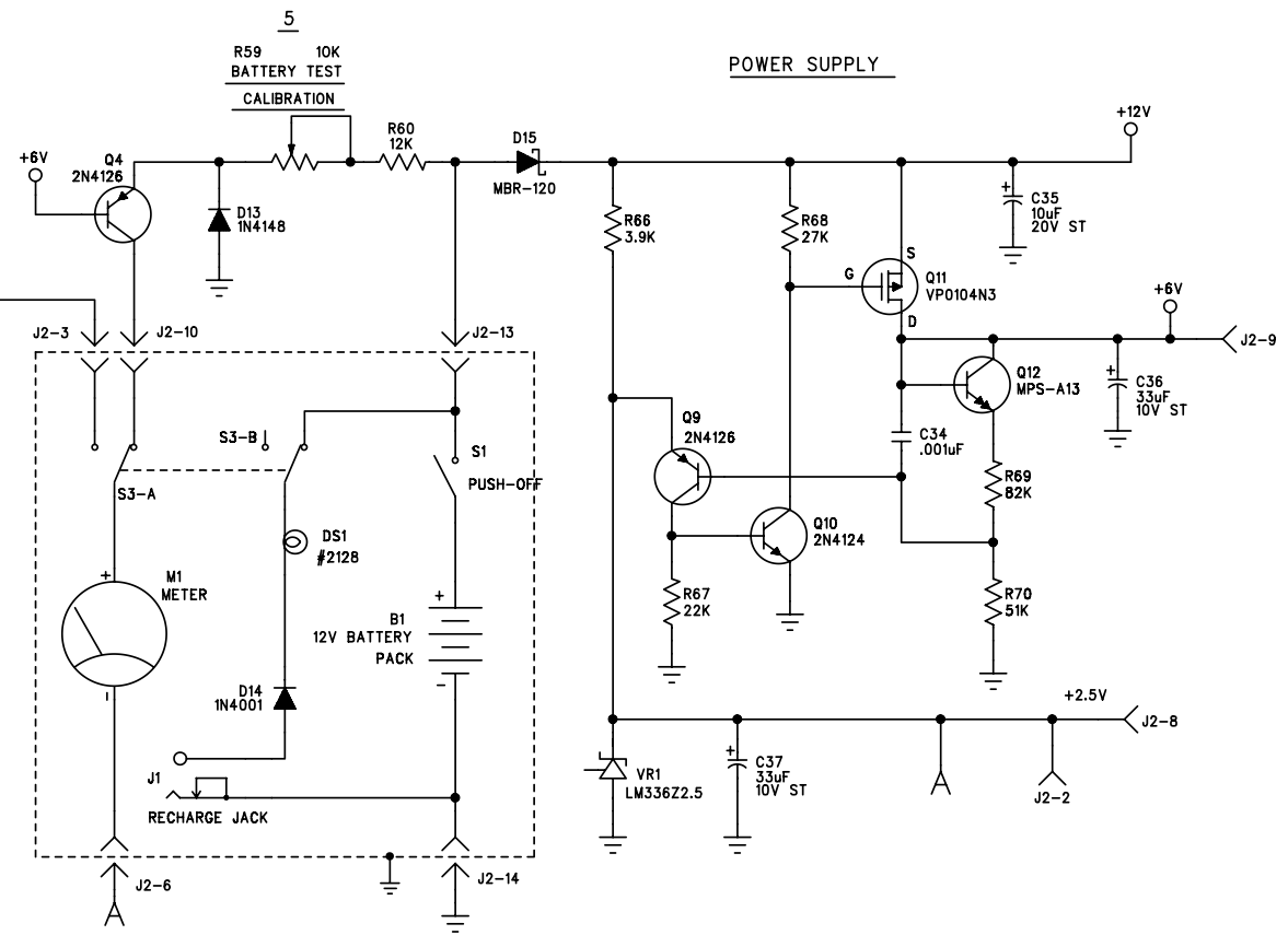

        The sensitivity pot has nothing to do with the battery check, something else must be wrong. Here is the power supply:

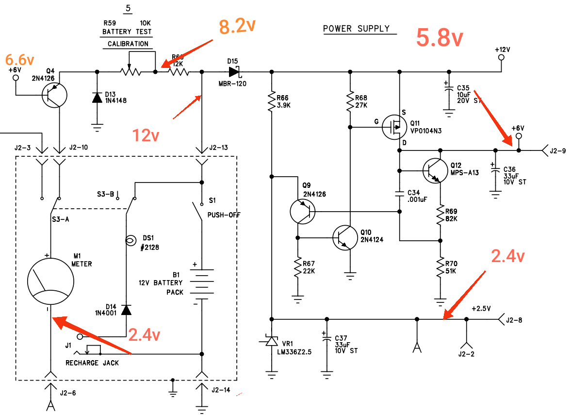

          Sir,
          Here the result of voltage upon checking
