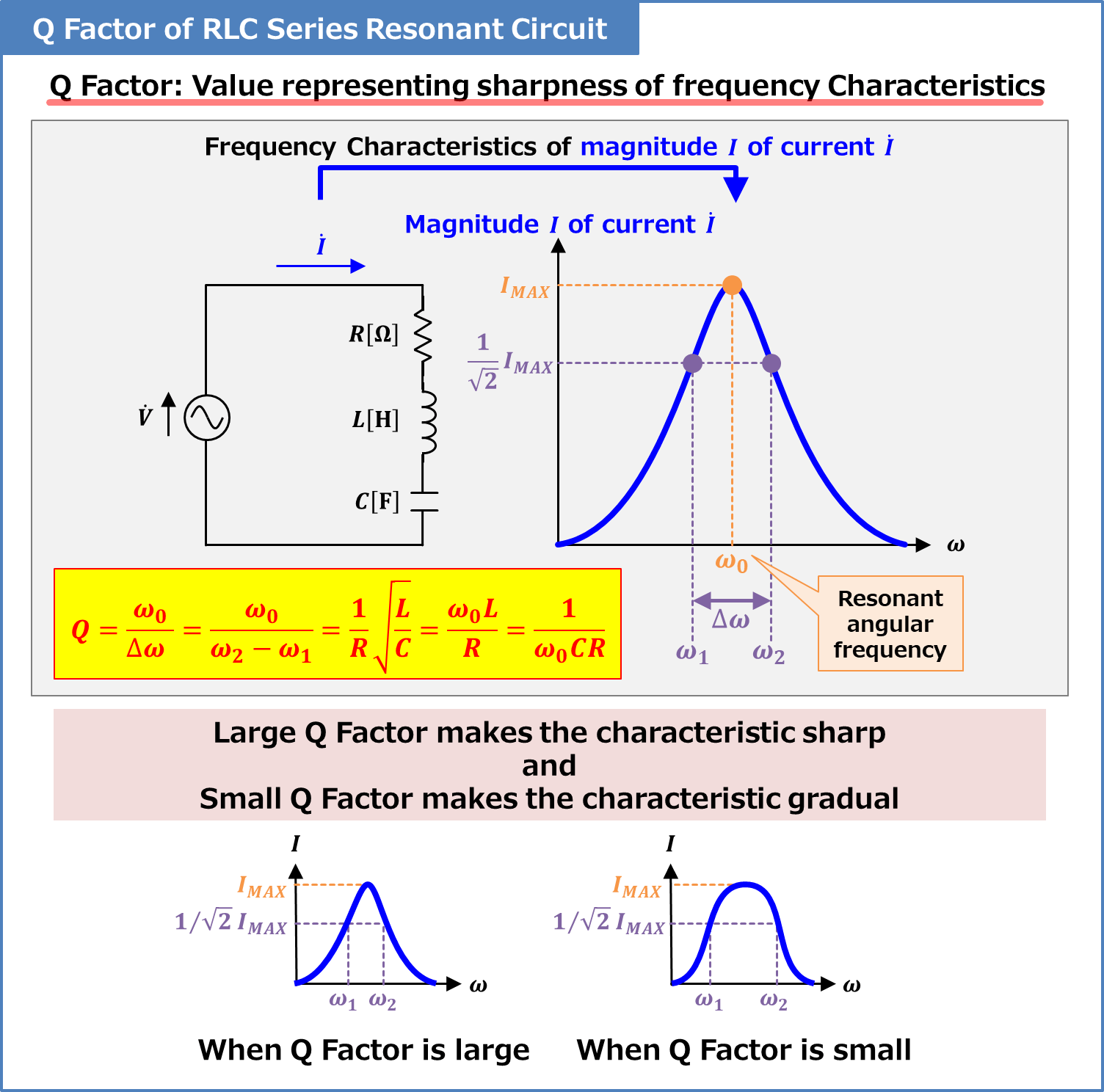

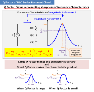

  • Sorry, "Q" factor. Typing Click image for larger version

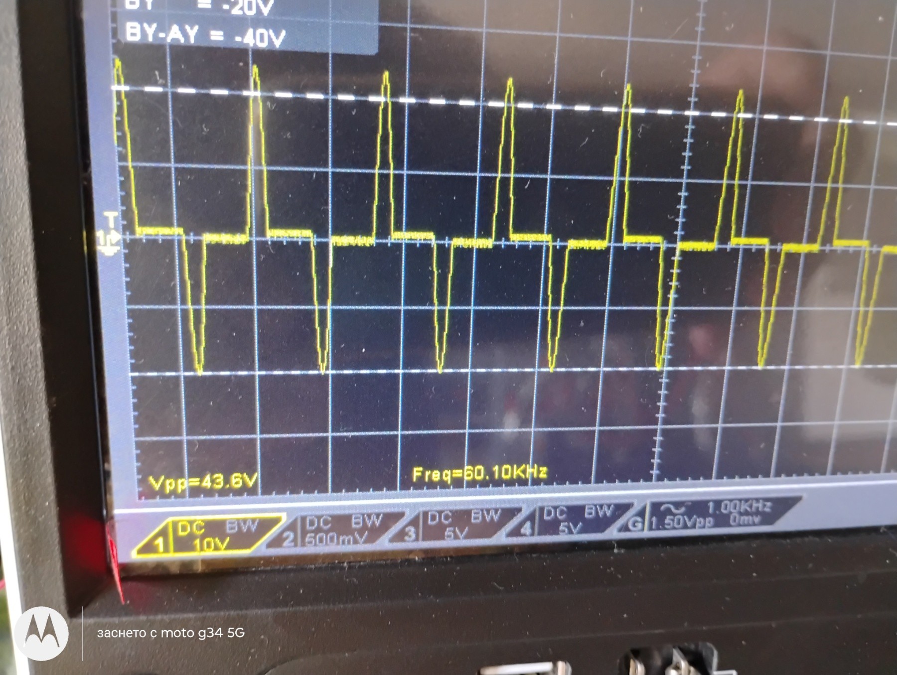

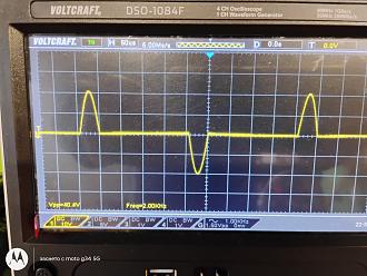

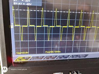

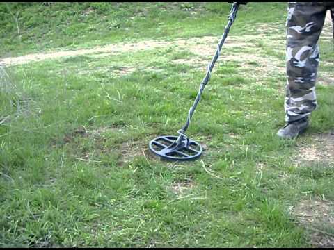

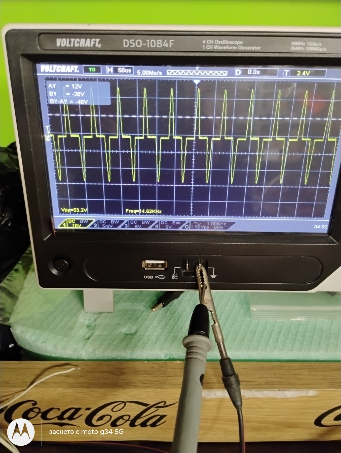

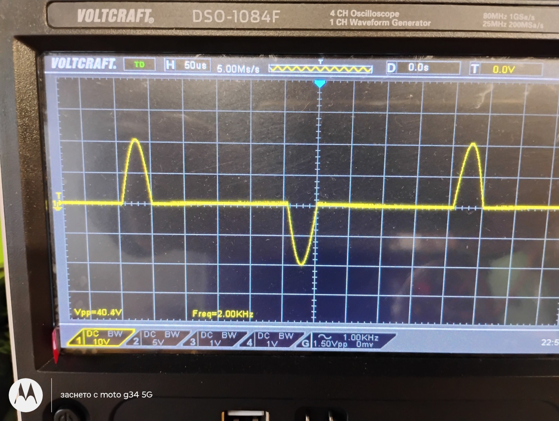

    • It's all a matter of compromise. In soil with ore, you work with a worse Q factor. Unfortunately, the sensitivity is worse.
      • Originally posted by scs-bg View Post
Name:	0-02-05-0d58c9c14bb1299b11c6679a954558179562b2cb0e8db6aad6353ee5728f5c0c_22c84967c38eb92e_1.jpg
ID:	448703 Click image for larger version
Name:	0-02-05-869a5bcc13d5da8883e817b5ab6bca4a5a576146fc75a894846af61e97210e20_594d7b8cc622dc85_2.jpg
ID:	448704 Click image for larger version
Name:	0-02-05-61a75b417a4fefac3b5a8b2665f91211a56d970c42f8337ee6781aa4ed55677d_1f880a2739087e5a.jpg

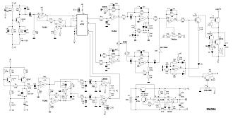

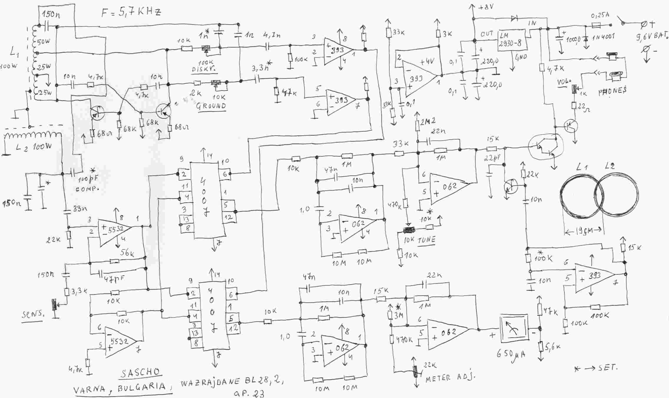

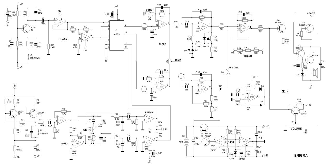

        • This type of generator works a little better in our soils.
          Practice shows it.

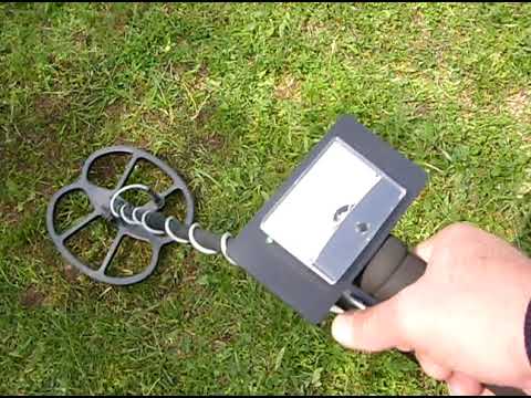

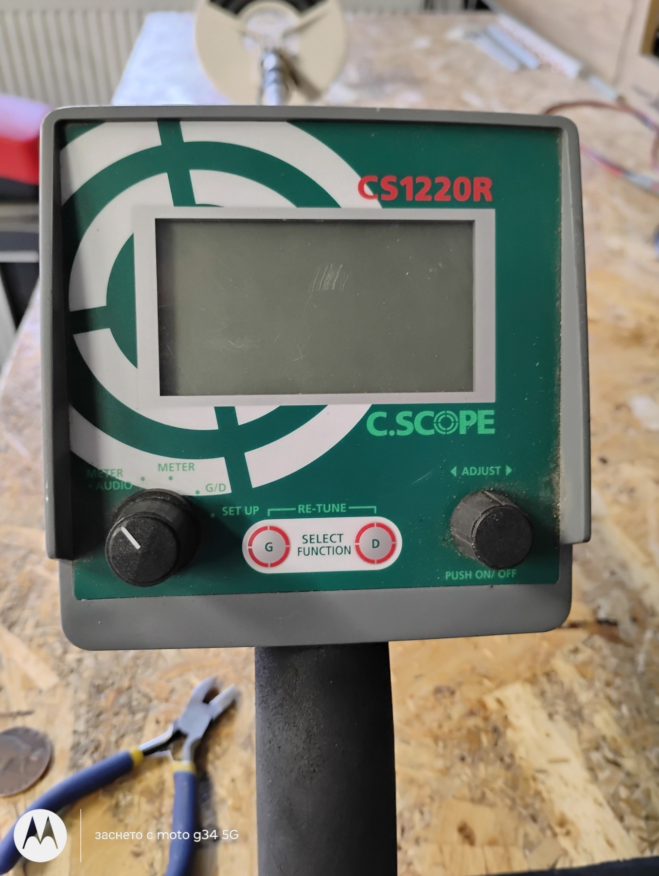

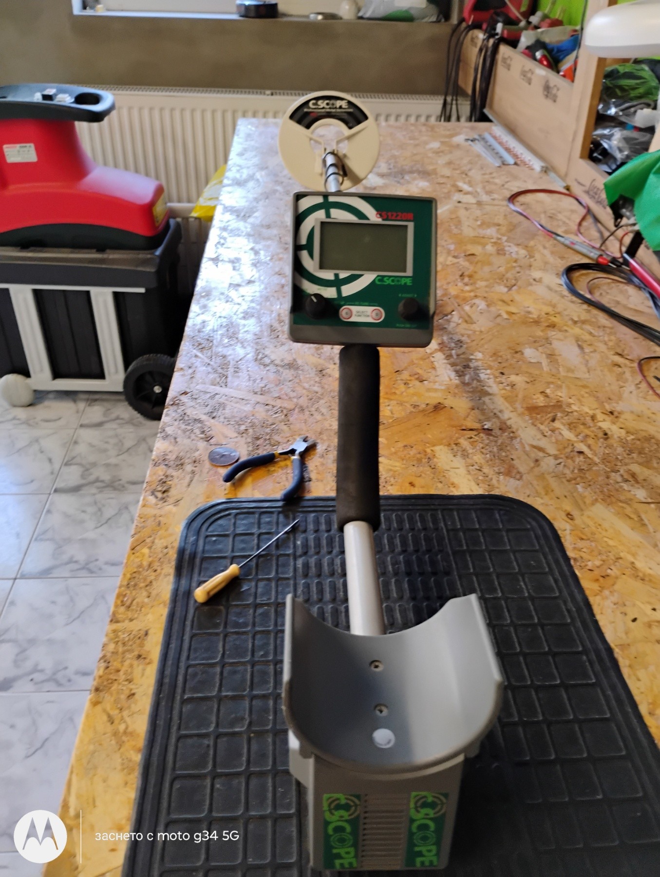

                        • The fields are plowed at 25/30 cm. Below this level, there is no soil balance.
                          I still enjoy shallow detectors.
                          This is my new detector.
                          Click image for larger version  Name:	viber_изображение_2026-05-19_16-43-47-861.jpg Views:	0 Size:	330.3 KB ID:	448785 Click image for larger version  Name:	viber_изображение_2026-05-19_16-43-48-257.jpg Views:	0 Size:	470.1 KB ID:	448786
                          • I dream about obtaining the 1220XD... though are rare , long shot!
