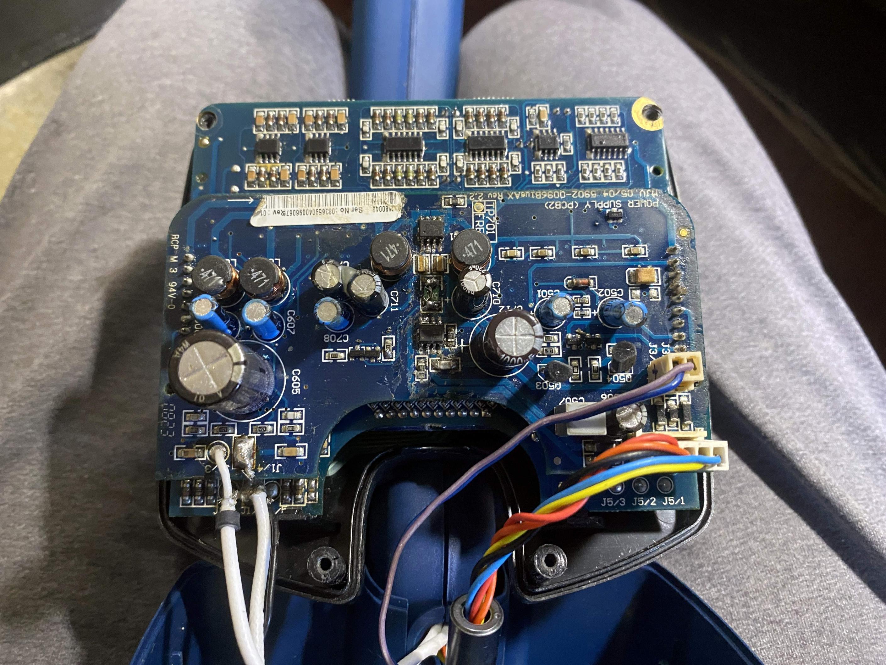

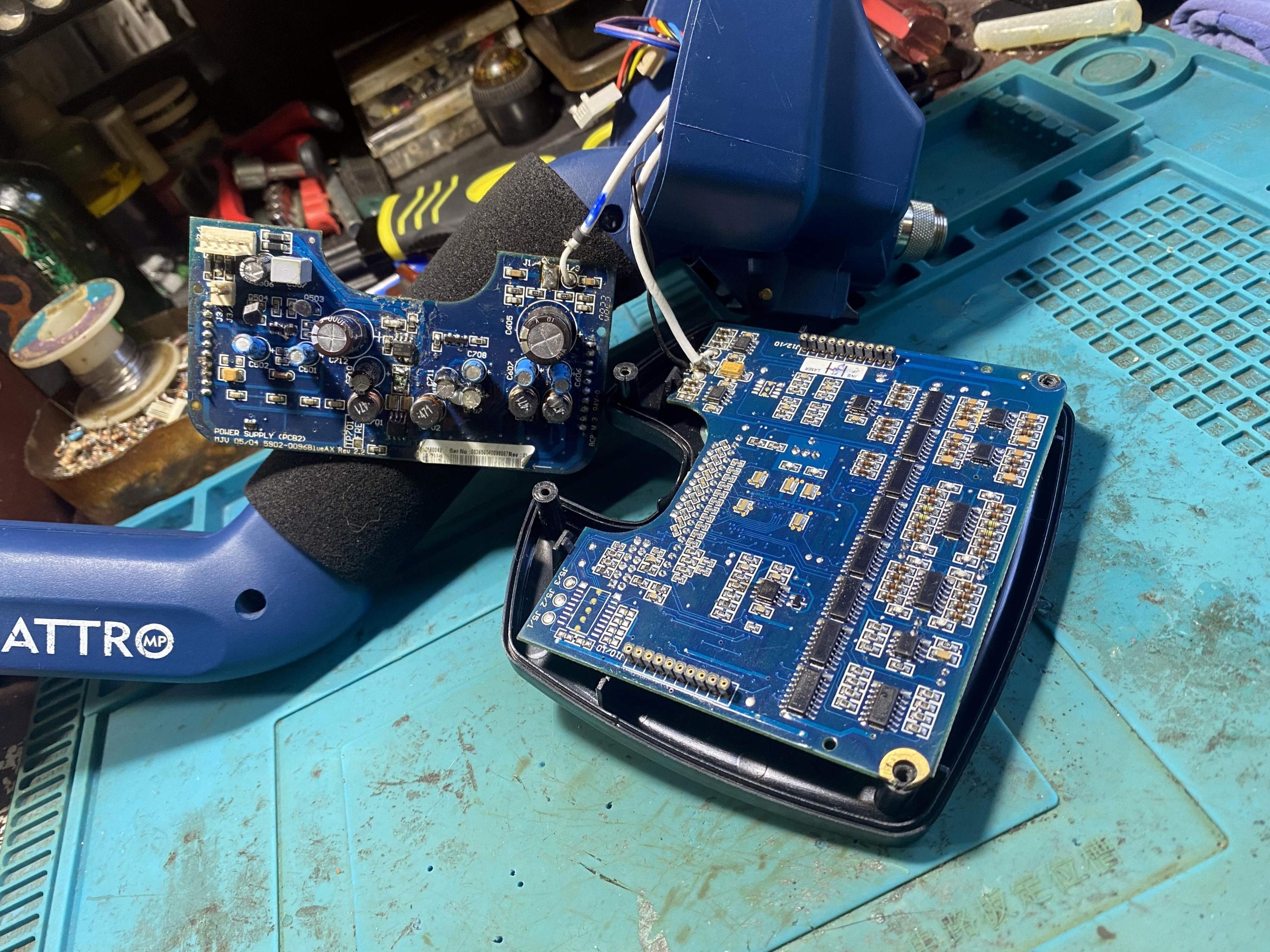

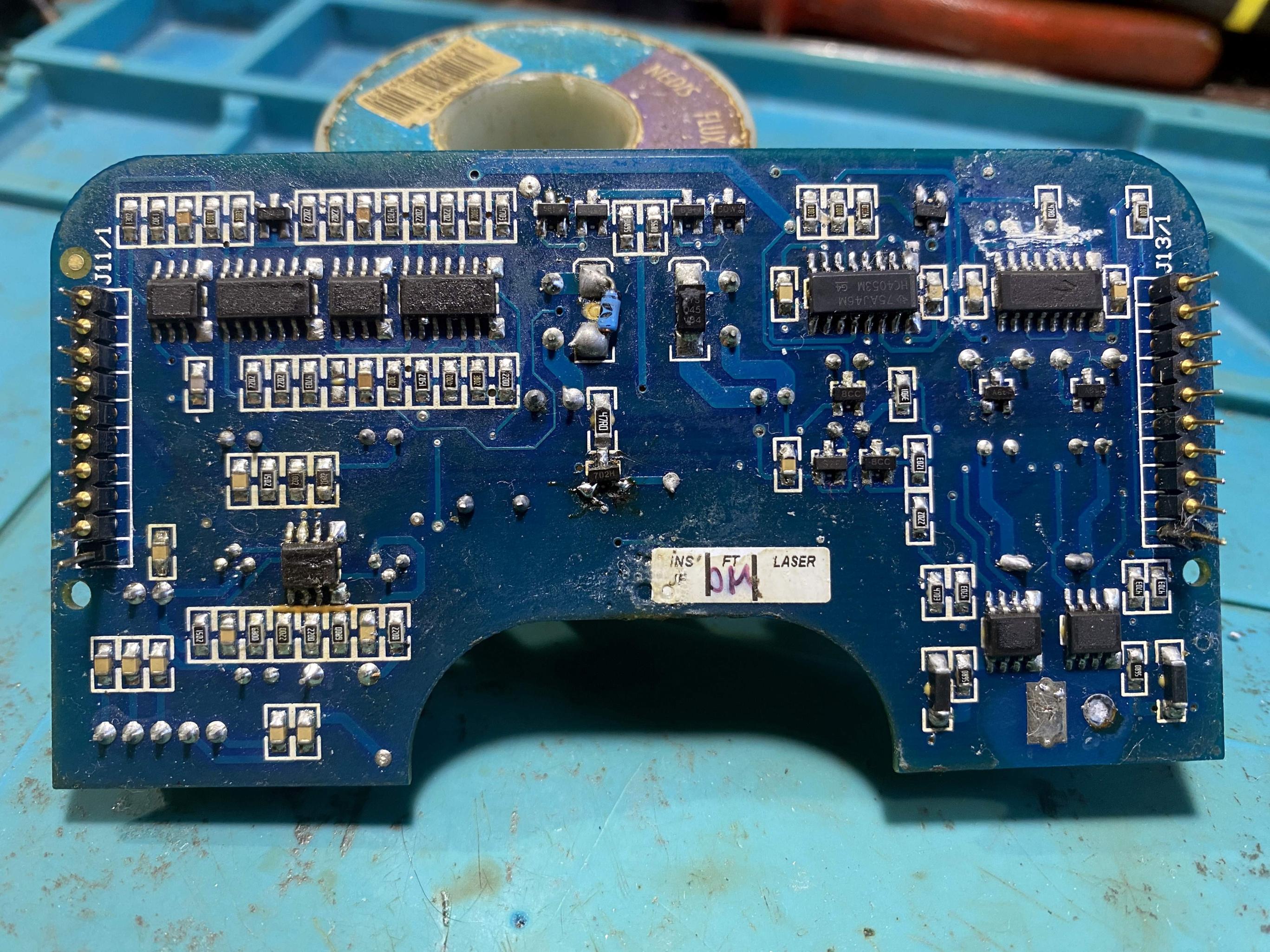

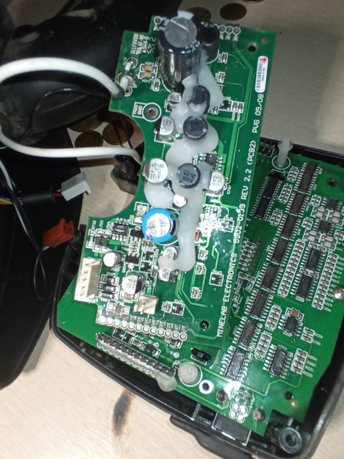

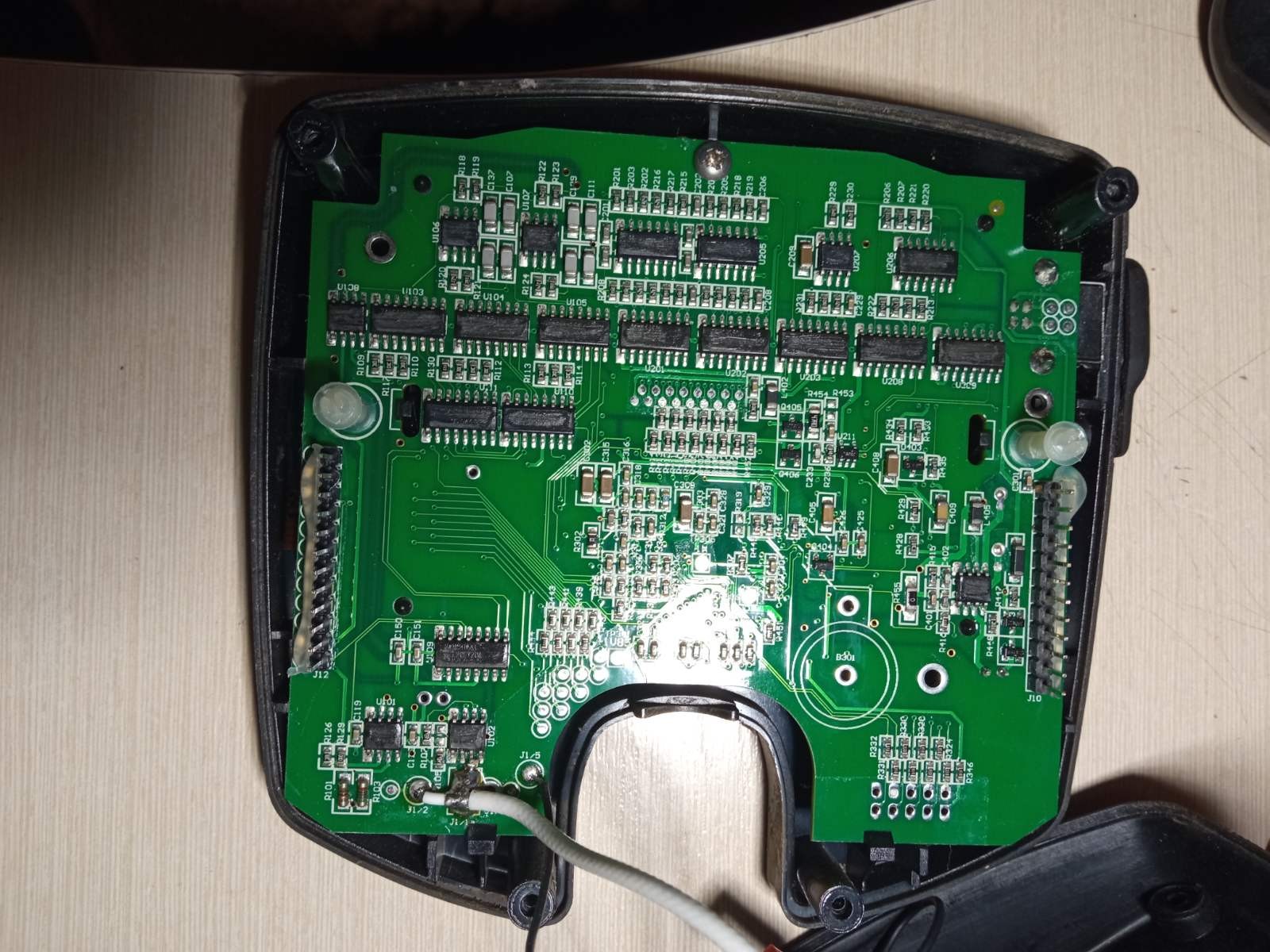

    A client just brought me a Minelab Quattro for service.
    But unfortunately, the detectors come to me for service often too late, when some "master" has already done his job and caused a lot more damage with his "knowledge".
    It is always much easier to repair a detector when nobody has touched it but it comes to me in its original condition.
    Serbia is full of overambitious "masters" who know everything. And that is why Serbia has become the world's largest graveyard of detectors.
    I've had an Explorer XS and an Explorer SE in the past, but never had to service them, so I wasn't really interested in looking under the hood.

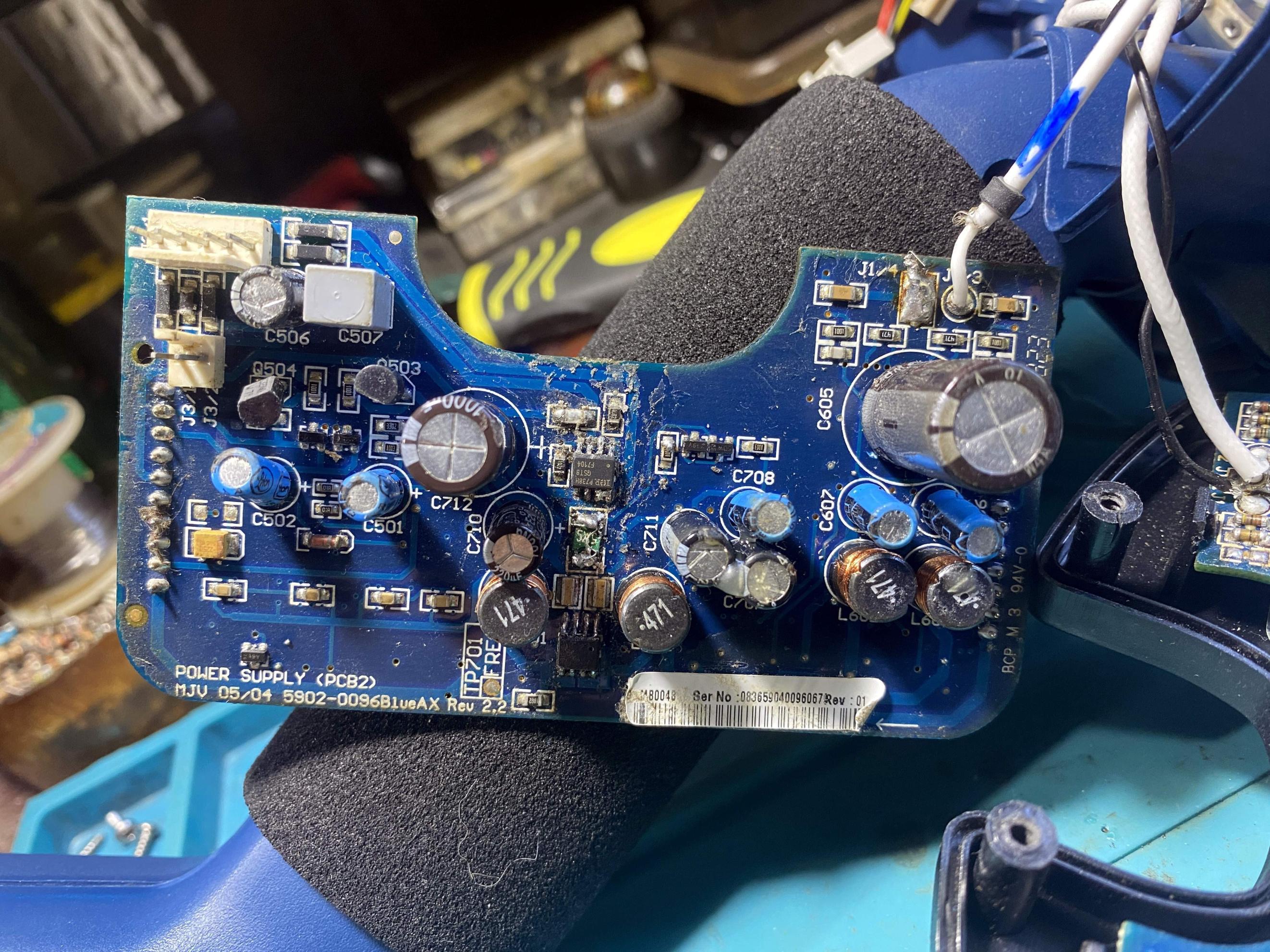

    Is it possible to find parts of the schematic of the smaller pcb of the two, which obviously houses the power supply part as well as the audio part?
    In the worst case, maybe a list of the original components and their position on that pcb?

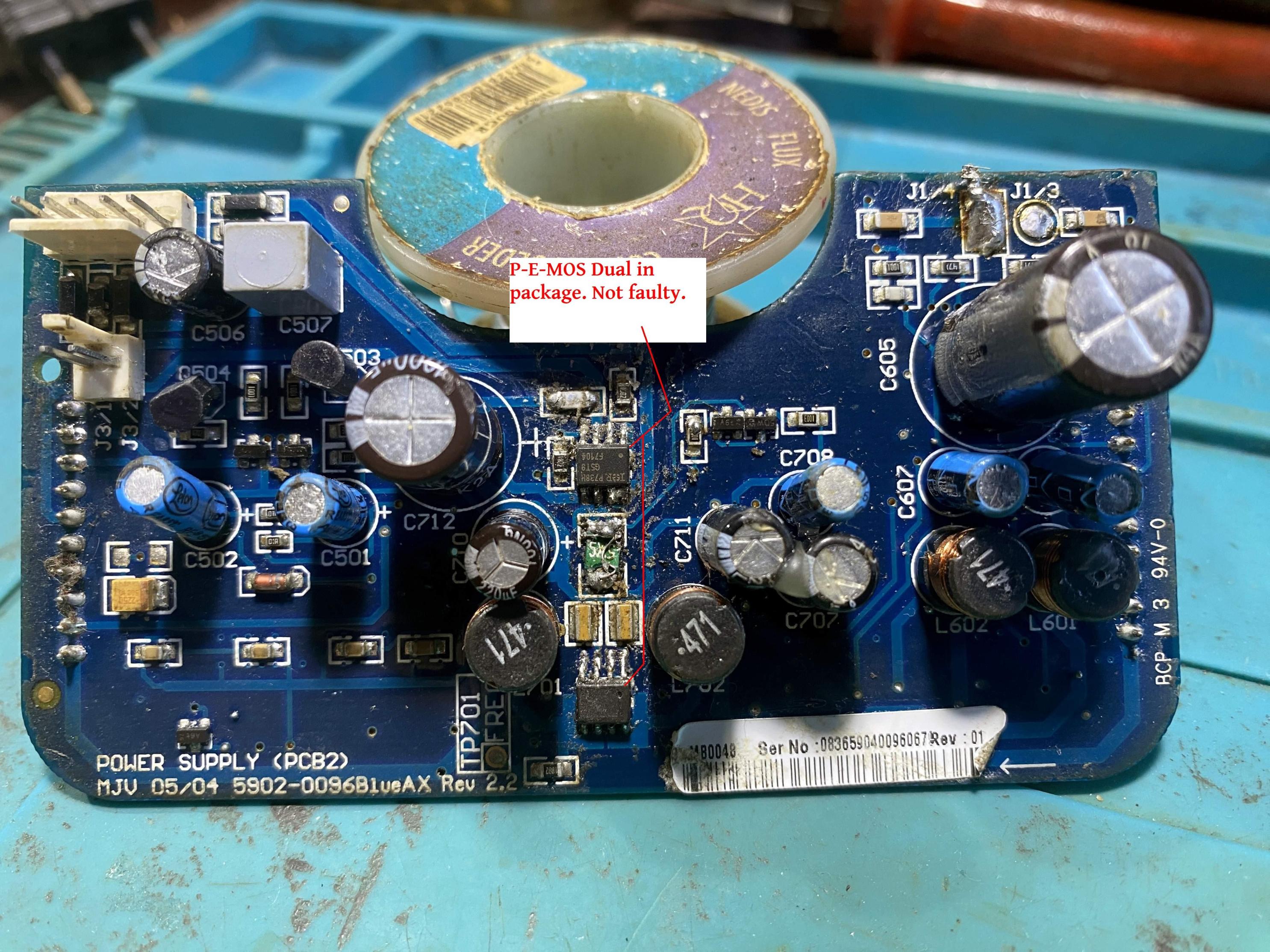

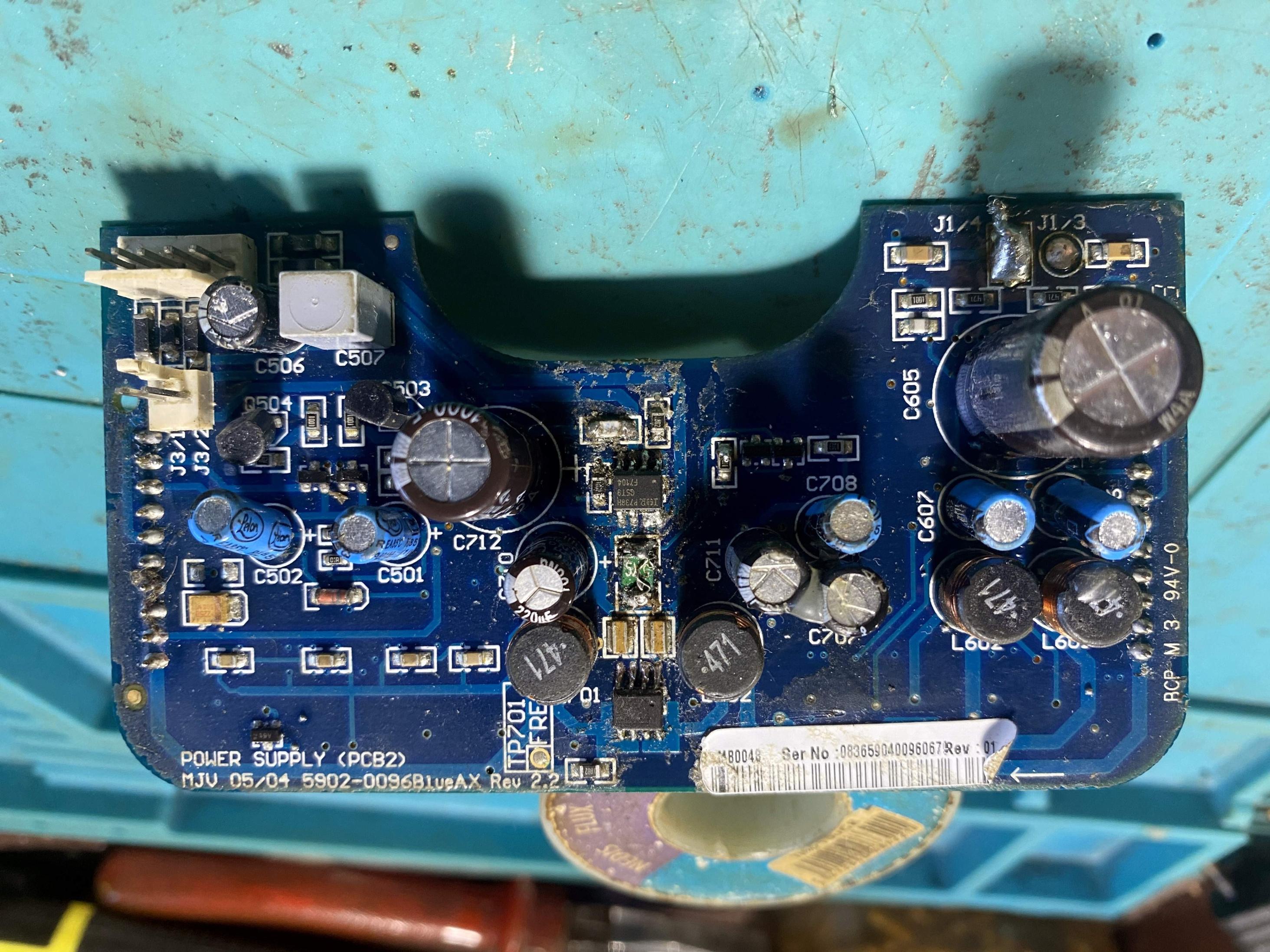

        So far I only eastablished this, also resetable fuse is blown. When jumped; nothing is going on, bad nor good.

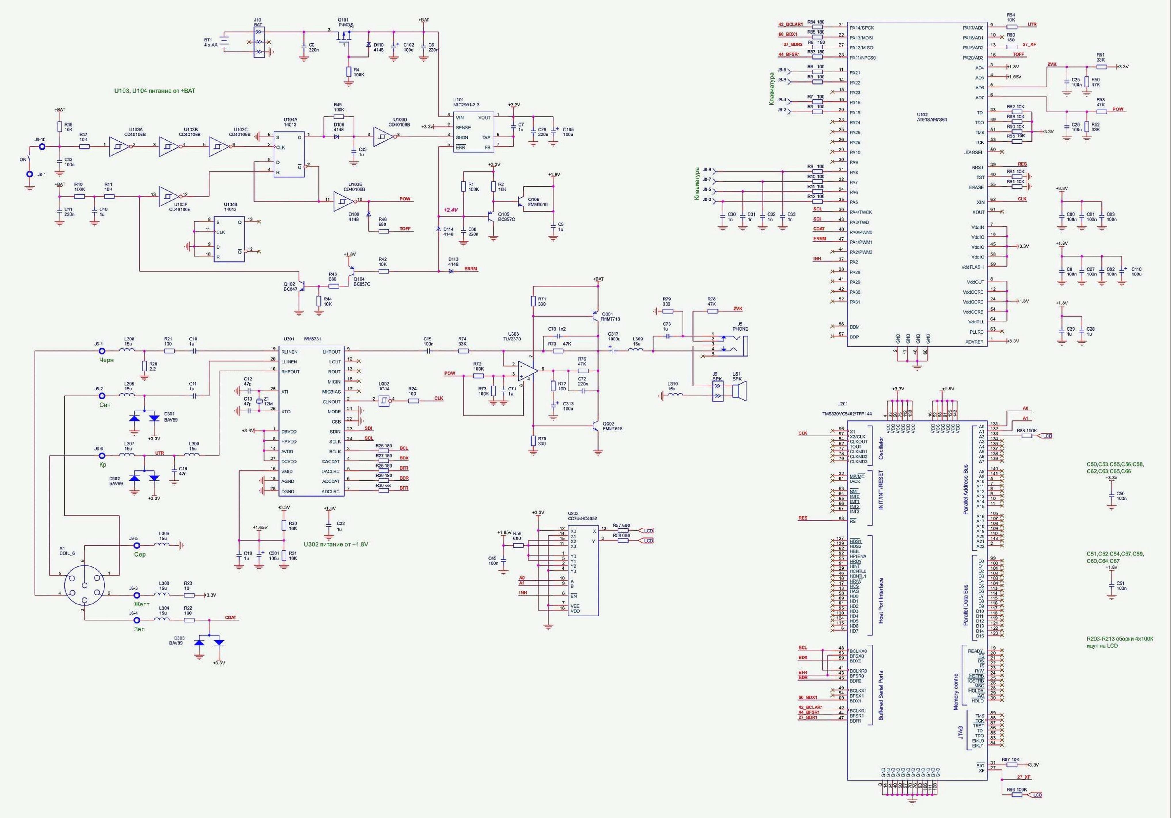

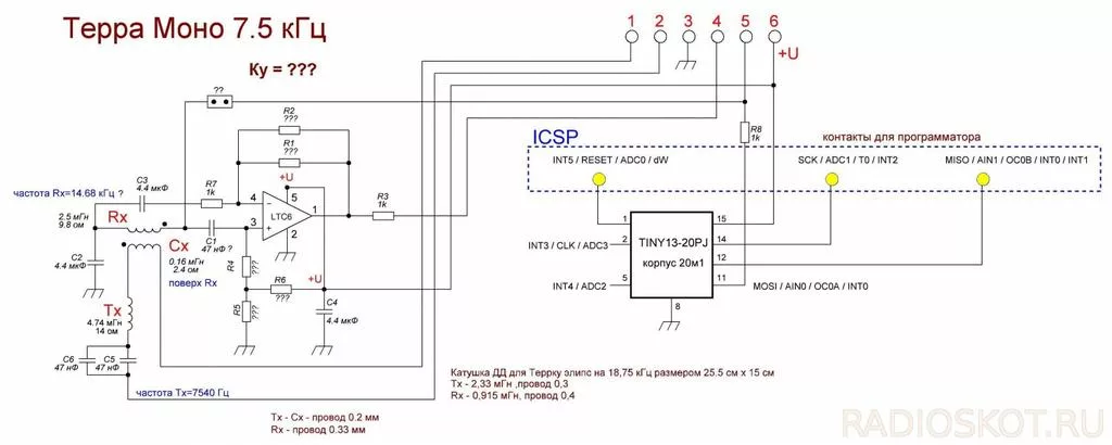

          Thanks for the pictures.
          Unfortunately, Explorer and Quattro differ in some details.
          I noticed that the rear and smaller pcb is quite different between Explorer XS, SE and especially Quattro and Safari.
          Schematic X-Terra bears no resemblance to the aforementioned models.

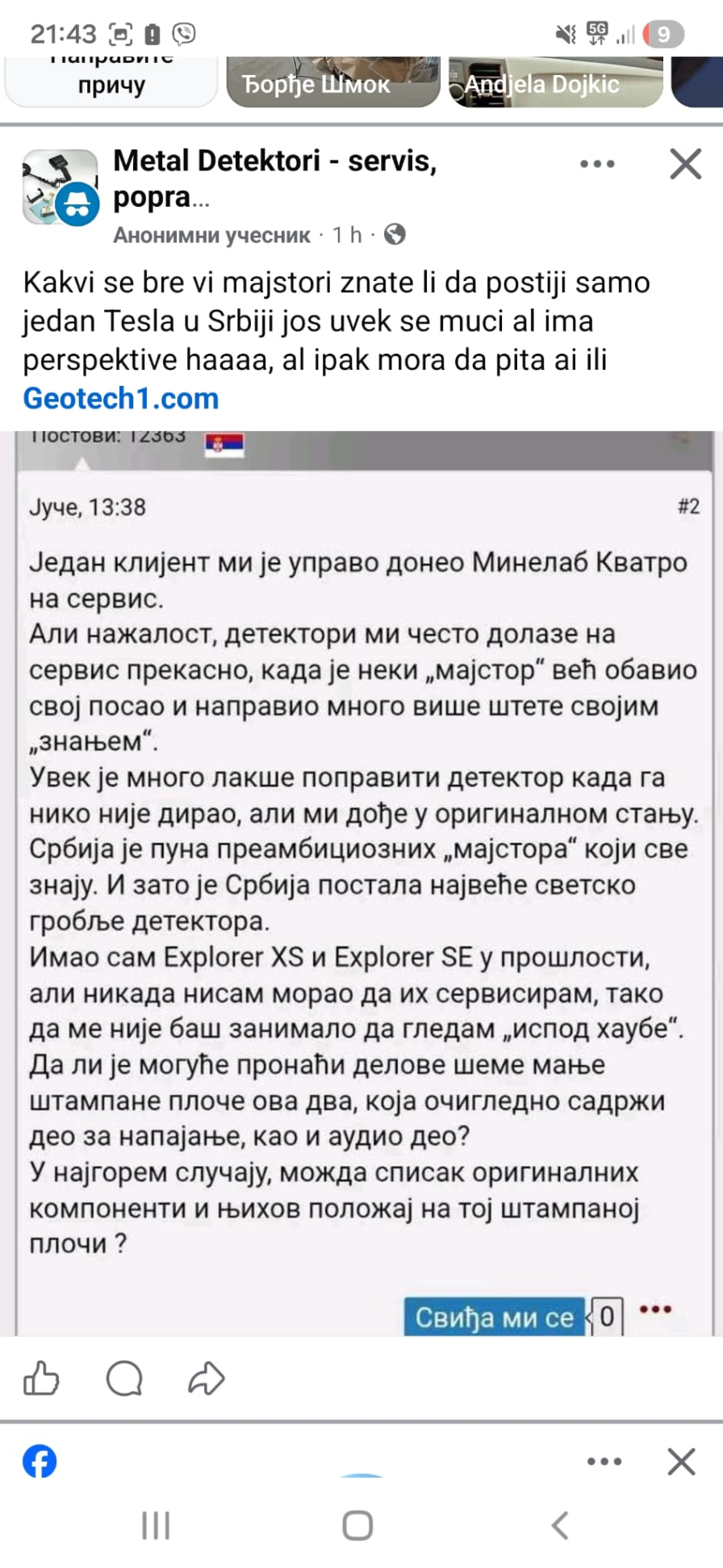

            In the meantime, a friend tells me that someone on Facebook is making jokes about this topic and making fun of my ignorance.
            Signed as "Anonymous Participant". lol
            Local mentality.

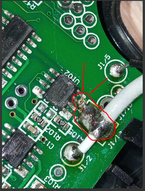

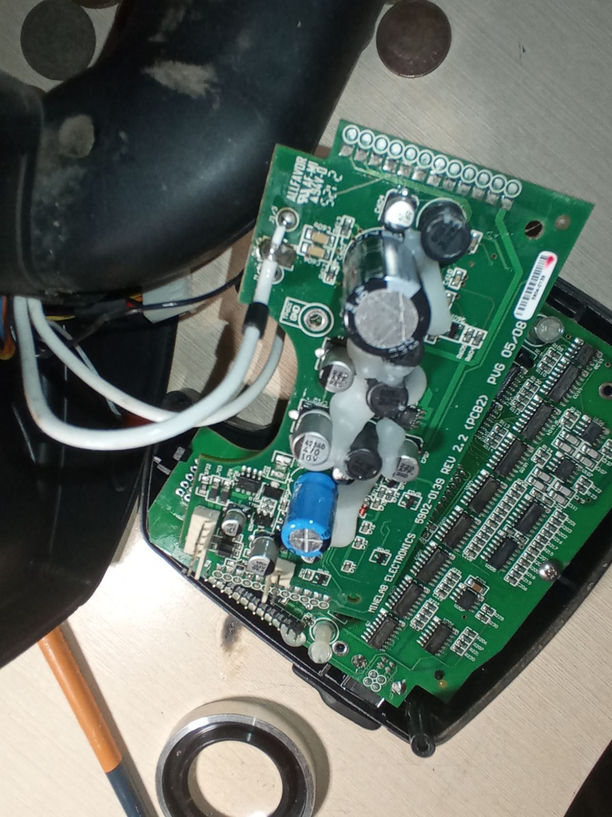

              In the meantime, while "Anonymous Participant" was writing his garbage on Facebook and gaining fame among lookalikes...
              I discovered most of the chips on the smaller pcb.
              Minelab unnecessarily removed the tags from the chips, it is very easy to find out which ones they are.
              The problem is deeper than I expected.

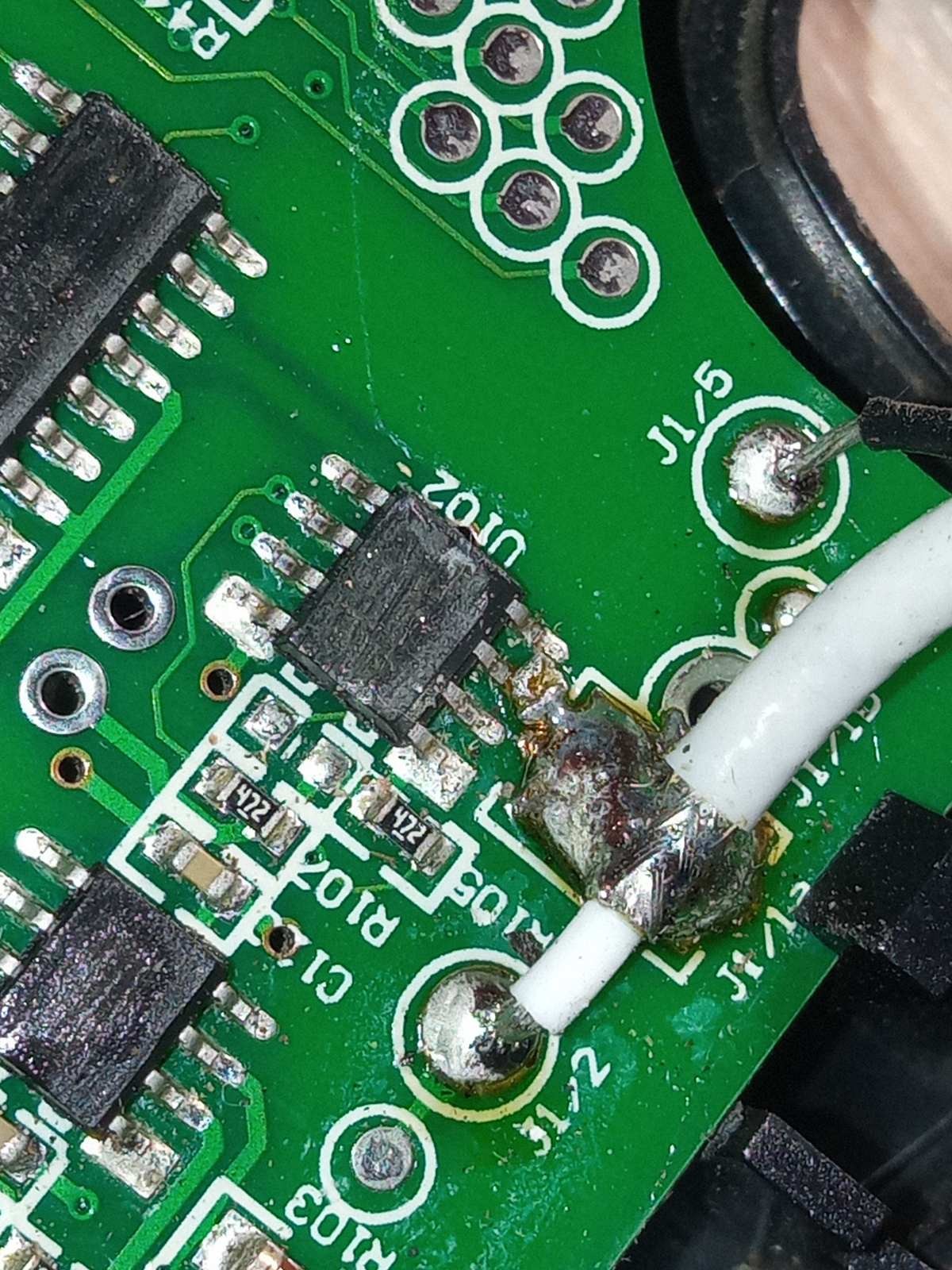

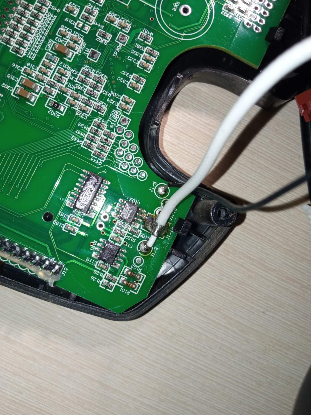

              By soldering the naked wire across the resettable fuse; the previous "expert" (maybe it's the "Anonymous Participant"?) did a lot more damage than I expected!
              In order for the smaller pcb to switch On and start work completely; a gate signal from a larger board is required and missing! Ouch!
              The total ignorance of the "Anonymous
              ​ expert" led to damage on the larger pcb as well. Ouch!
              And now I have come to the moment when I wonder; does it make sense to continue working? Because this is not even worth it now.
