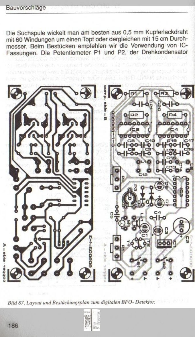

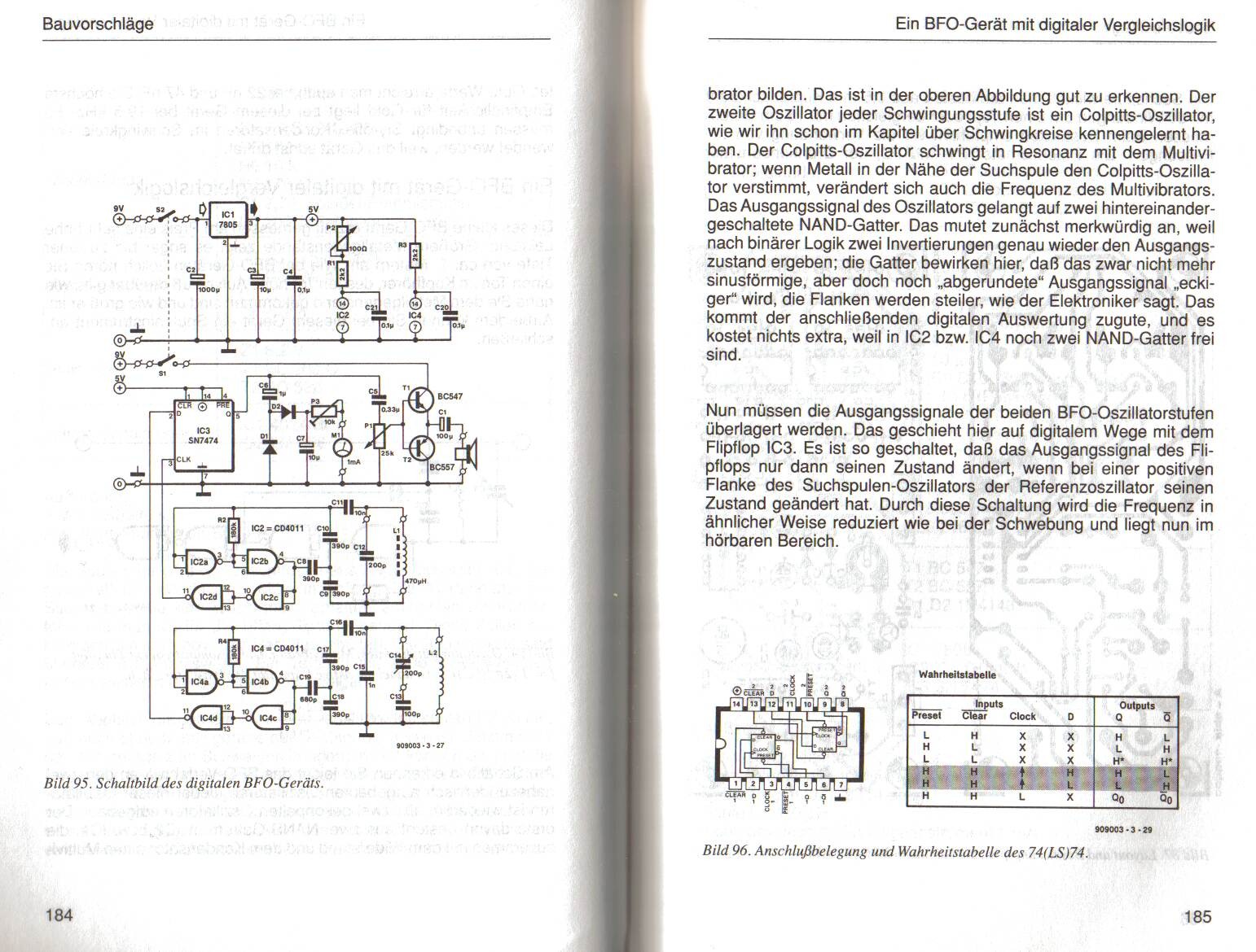

    This is a BFO circuit from an old German magazine.
    Does anyone have the schematic? Or does anyone know the name of the magazine and the year it was published? It seems to be Elector magazine.​
    Click image for larger version  Name:	photo_2026-07-28_01-46-40.jpg Views:	0 Size:	153.3 KB ID:	451342 Click image for larger version  Name:	photo_2026-07-28_01-46-34.jpg Views:	0 Size:	211.4 KB ID:	451341
    Unless someone has a copy of the magazine I doubt you will find this freely available.
    It appears to be called "Digitaler BFO-Detektor" from a 1987 Elektor magazine.

        It might be on about p183 ..of Andreas Gatowski, Schatzsuche mit Metalldetektoren – Technik, Selbstbau, Geländeeinsatz, Elektor-Verlag, 1990 (reprinted 1993, ISBN 3-921608-81-3)​
          I have a copy of that book. It's an Elektor publication.

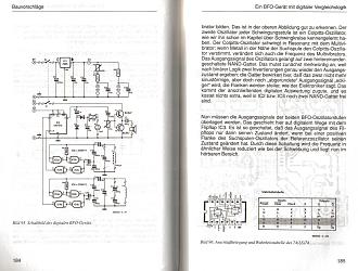

          Yes, you're correct. The images that aft_72005 posted are exactly the same as the ones from the book. The schematic is on page 184.

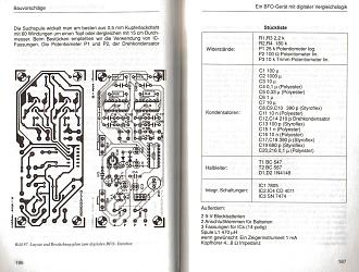

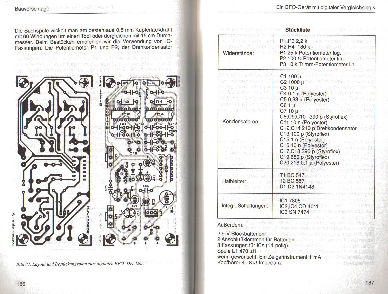

            Hi aft_72005,
            if you have the archive from KT315, check out the folder "Andreas Gatowski_Schatzsuche mit Metalldetektoren_1990" there is a complete scan of the book. Below is the BFO project.

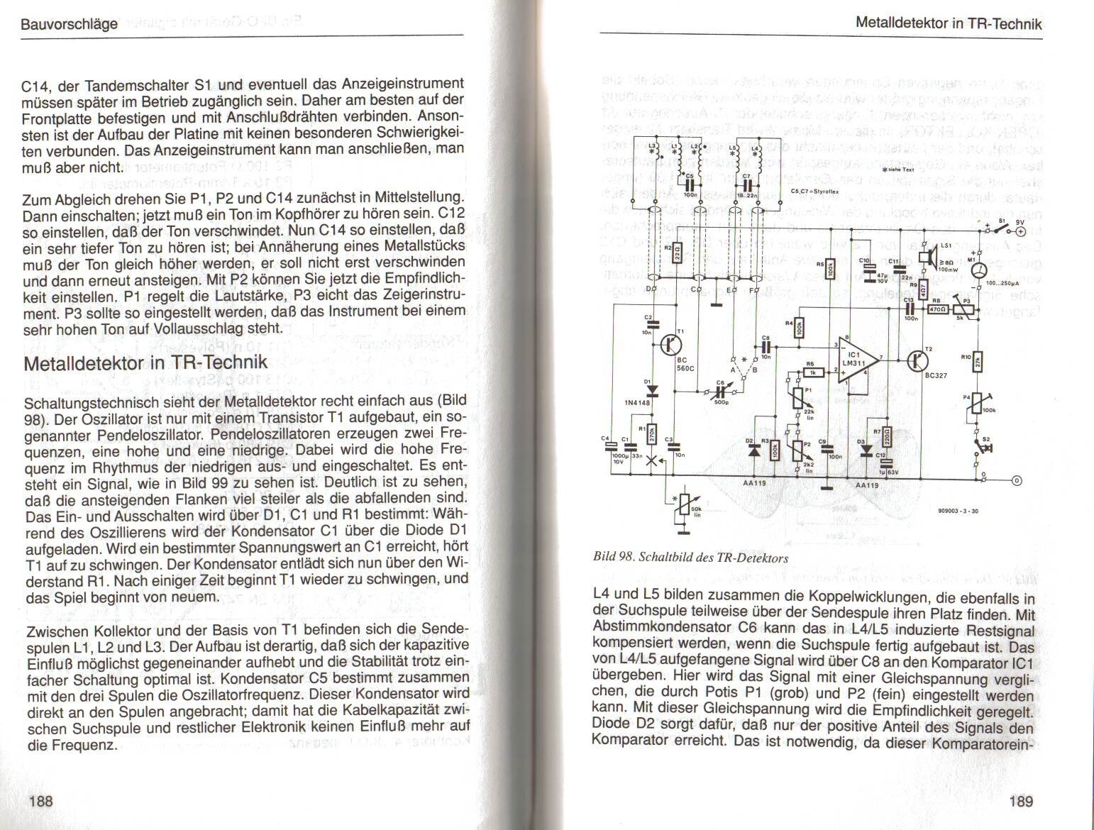

                Hi all,
                the book "Andreas Gatowski_Schatzsuche mit Metalldetektoren_1990" was my first book on metal detectors and I loved it.
                I have built the BFO. It is a toy and can not be compared to a serious metal detector for field use of course.
                It is better to build the PI detector published in Elrad or so in the 80' - 90'th. This worked much better.

                  Hi all,
                  BTW, here is the PI metal detector I have mentioned published in Elrad dated to 1985/9.
                  Link: https://www.mikrocontroller.net/atta...AD_1985-09.pdf
                  Don't waste your time with BFO's. They are not useable in the field.
