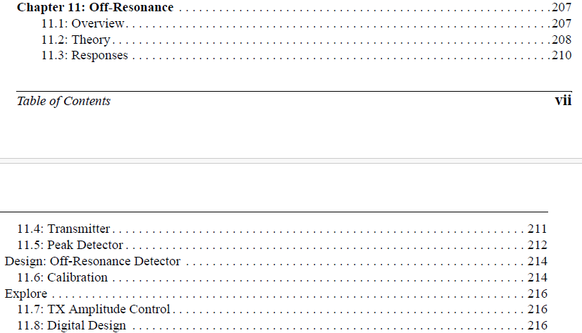

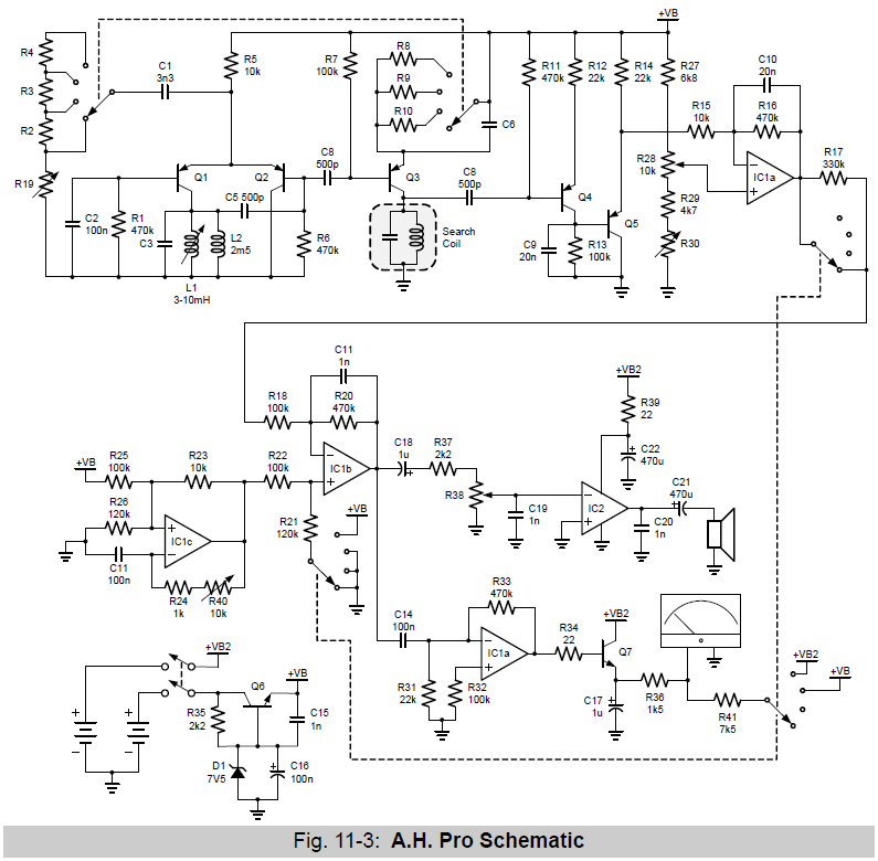

One of the Heathkit models is off resonance. To much drift, works on the bench but even sun shining on the coil case makes it drift. Not really worth the time when there are better ways to do things.
