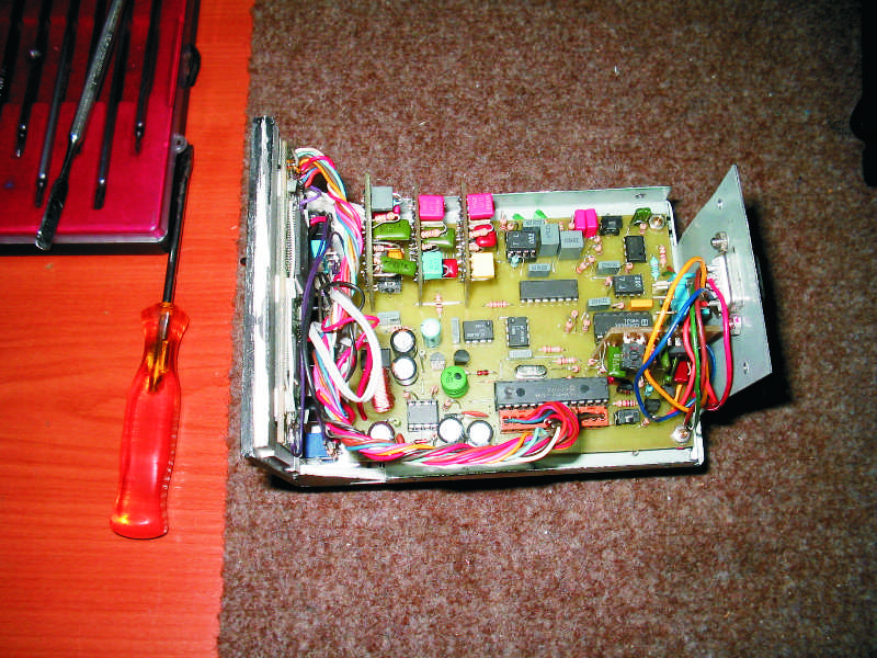

                    for me schematic is very useful to take idea and to make with up to date parts.
                    i made this with high speed PIC and some renovations and now my unit is better than XLT (for test i bought one from ebay)
                    much faster displaying metal type and signal level - dept
                    dept is 5 cm moore - coin 2 cm XLT -35 cm , my -40 cm
                      Hi rumensat
                      Are you having xlt schematic?
                      Can you upload it , here or sending to my email ?
                      [email protected]
                      Regards.
                        i have same schematic giving above
                        schematic is clear about connections but w/o parts.
                        parts you can take from eagle spectrum - analog parts.
                        digital you dont need becose it is syupid idea to use such old and slow processor.
                        for my project i rebuilt all filters with more effective high Q band pass filters, it took me 1 year to adjust this filters, every time going to mountain for test.
                        in the laboratory you can not fix them rite way - so much noises.
                        for this you need scope like Game Boy DSO.
                        menu - USER 1...6, frequency 6khz...8khz, ground balance -88...0...88, tresh hold 1...88, transmit boost 1...2, amplifier 1...7, discrimination reject 0...190, battery voltage.
                        sound - high and low freq.
                        LCD 2x16 , 3 buttons, power li-ion from 4 to 9volt
                        head -22cm concentric tx33 rx300
                        discrimination - iron 110 -130, cu -95-80, bronze -50-35, al -20-25, au-3-18, ferrit 190-160

                              here is the picture
                                sorry system is not working for pictures
