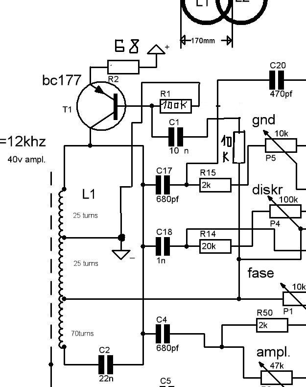

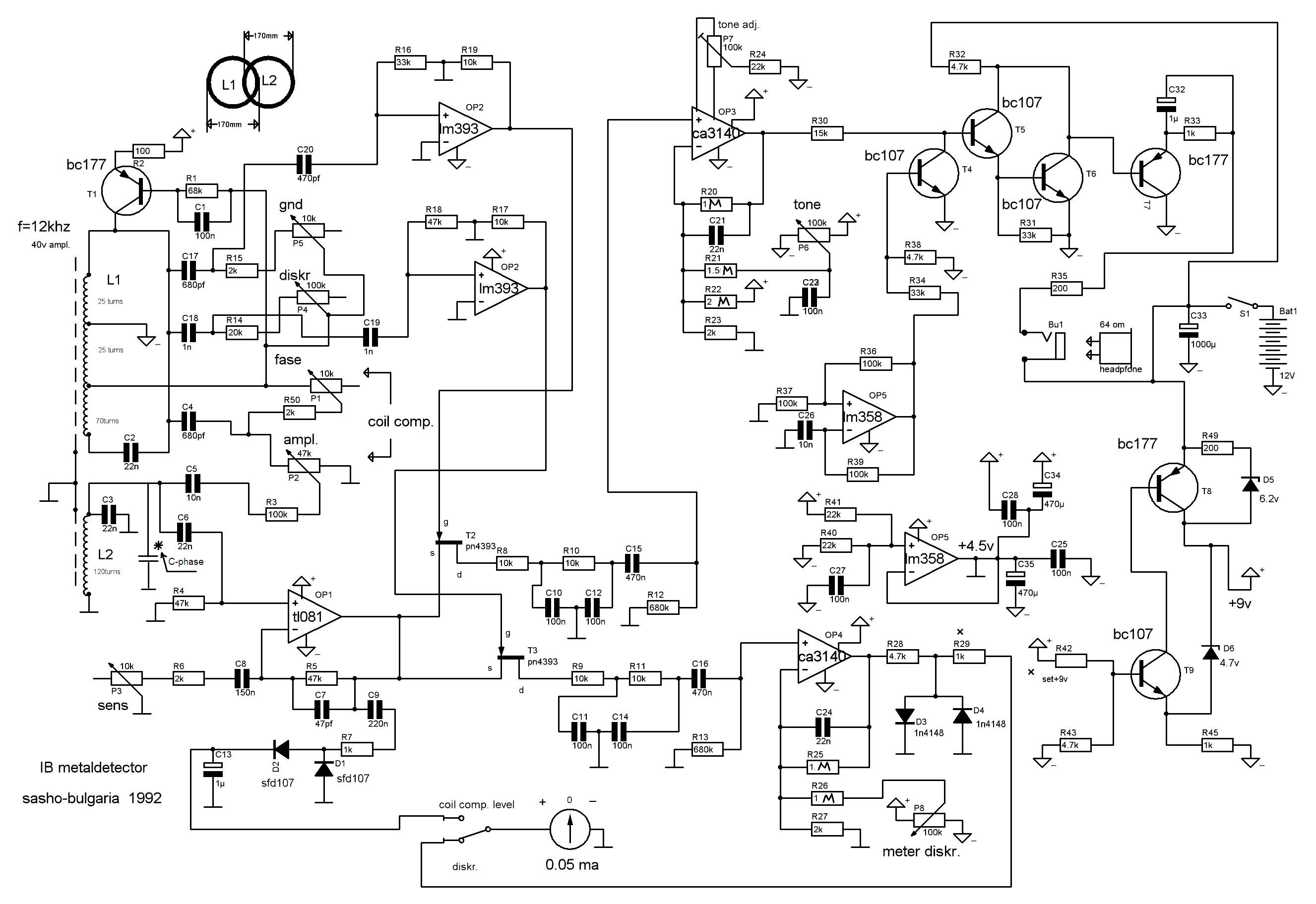

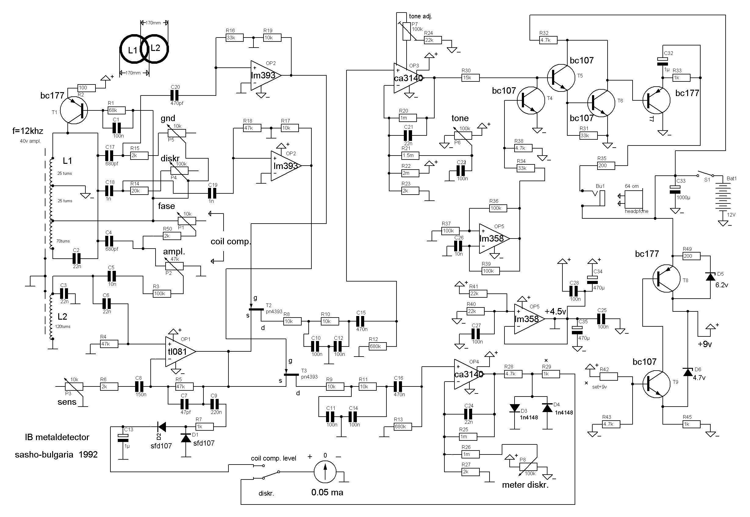

                    This is my schematic from 1992 year. Works better from many modern detectors:
                    Does anybody still have the schematic from first post ?
                    • #85
ID:	345534 images from saho-bg 20070523 without mistakes
                      • #86
                        Working schematicClick image for larger version
                        • #87
                          Thanks Sasho
                          What tunning procedure you suggest?
                          • #88
                            Coils is fixed to a minimum output signal op 1 .Regulator amplitude of the compensation coil must be at minimum.The detector detects very deeply coins.
                            • #89
                              Originally posted by scs View Post
                              Working schematic[ATTACH]35924[/ATTACH]
                              Thank you Sasho.
