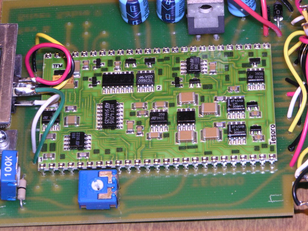

    I have a SS2 that is a little different because it uses SMT and a hybrid PCB. I reference this SS2 schematic, but also the Bandito, and Golden Sabre. My unit's components and circuit falls somewhere in-between these, as near as I can tell. Many components are unmarked or unreadable. Resistors look like ink spots. Is this a "MicroMax" predecessor?
    I have posted a picture of my MD. It's called Silver Sabre II, but notice the HCF4016 and two LM308 opamps. I haven't seen any one schematic that cover this model.

      So this is a Silver Saber 2?
      Interesting design. From your extremely clear photo you can see that the screened resistors are also laser trimmed. I wonder if this was a very cost effective design.

          Whoops, mistake. I had caught this error before, but went ahead and posted errata anyway. The zeners are 1/2 watt units, not 1/4 Watt as I stated. Pride hurt: I hope to make this post before sombody else catches my mistake first.

          Thanks for the compliment on my photo, Qiaozhi. Tesoro made such a darn fine circuit board, I almost hate to cut it up! That, plus the fact that it's almost inscrutable - well, I may finish a Goldscan IV and a Golden "Puppy" before I even add a simple GEB pot to the front panel of the my SS2. (Well, maybe not.)
          So there are both SMD and through-hole versions of the Silver Sabre II and they have significant changes in circuitry. Interestink, no?
