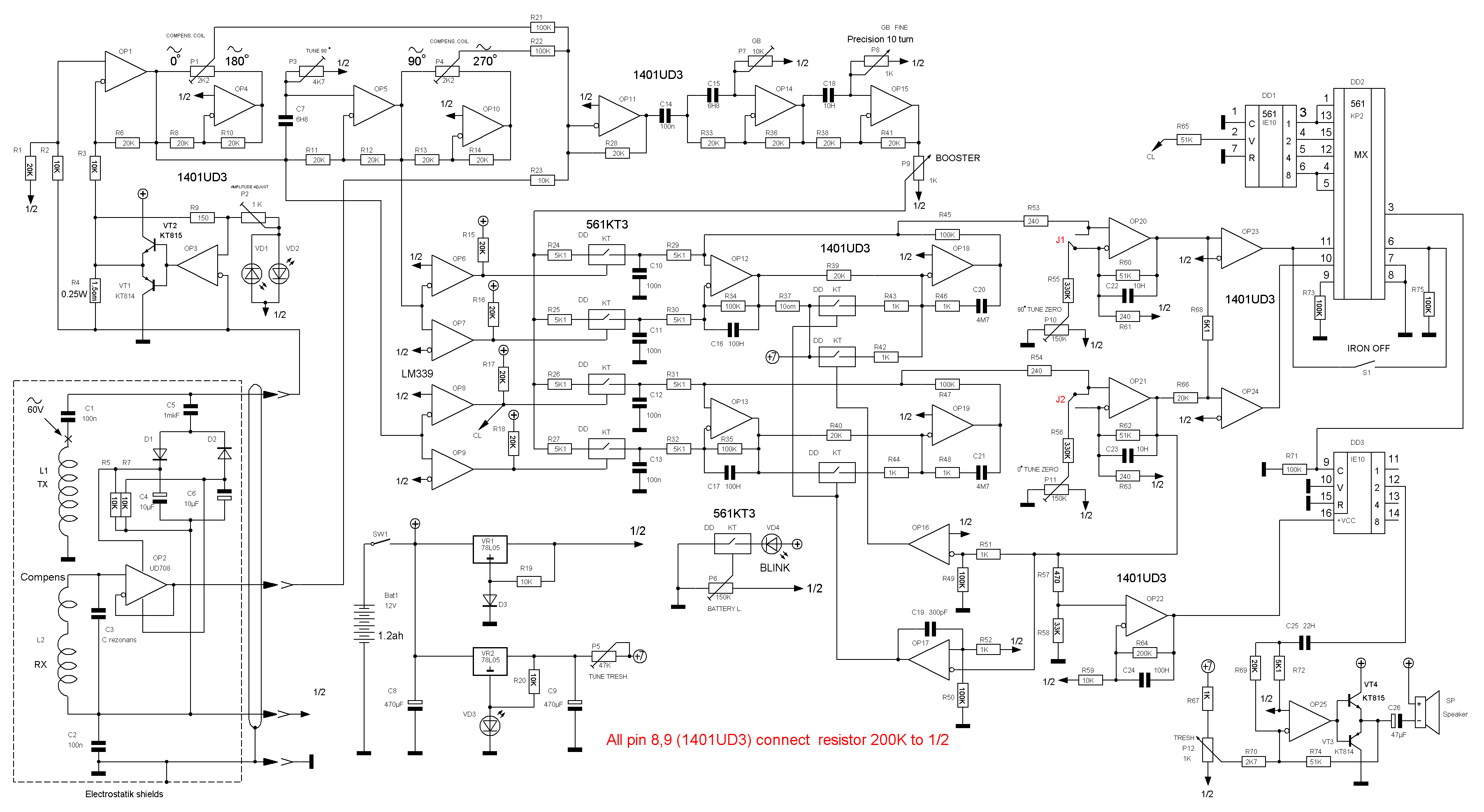

            hi Geotechers.
            I offer for the exchange this shematic of STERCH-7232. drawn by Anker.
            hh

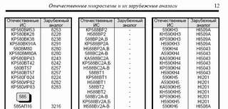

              Now, this looks interesting! If i can only know .ru IC's substitutions?
              Do you have pcb?
              I am already asking for pcb cose those are hard part for me. The rest is piece of cake....
                no, I have not.
                are you able to see text in russian in this PDF?
                  WOW!!! Cross reference...!
                  Thanks a lot KT315!!!!
                    I am confused again!
                    According to this cross reference i found 1401UD3 can be replaced (among other ic's which are impossible for me to find) is LM392...!?
                    Actually it means whole schematic is "populated" with LM392!!! Except 561KT3 which is obviously 4066 or 4016....Wherever you take a look....LM392 is there??
                    I dont think you can use LM392 all over the place like it was noted on schematic.
                    I think this cross reference is good to approximately find substitution for ic....but there must be more proper substitution for 1401UD3...as example.
                    That's why i think; the best way is you to place substitutions on schematic, cose you have more experience - know which ic is sutable to replace present ic....etc...
                    Might be some job for you....but we will be gratefull much!
                    Best regards!
                        LM246. look due to. simple rule is - use better replacement than noted in the file and will not be mistaked. the data is not so fresh there.
