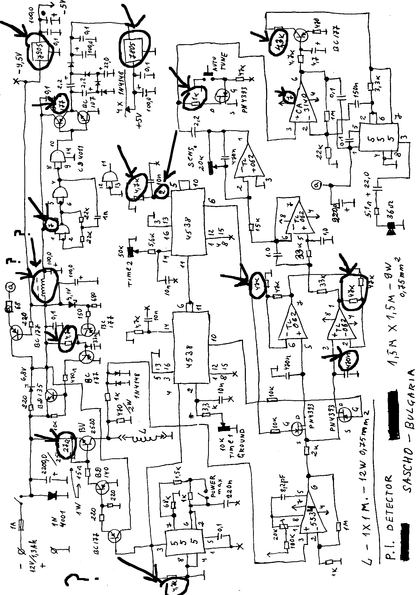

      I can't see schematic?!
            Here long range mean high depth?. Coil is 1 X 1 m 12 turns, wire 0.75 mm. For biggest coil 1.5 X 1.5 m, 9 turns, wire 0.75 mm.
            Is in previous page:
            https://www.geotech1.com/thuntings/s...t=13383&page=2
              Sascho-BG
              Hello Sascho From BG !!! Do you have a better copy of YOUR schematic ??.......Thank-You..............Regards.........Eugene
                No.I'm Sorry.This is old schematic.
                ?= drossel
                  ?= drossel
                  Sascho
                  Hello Sascho , Glad you are still here , and I hope you are Doing Good !!! I guess 4.2 K ohms are really 4.7 k ohms . I will re-draw schematic for practice , it is not to hard to see........... Anyway , Sascho if you have a better P.I. Schematic for DEEP-SEEKING "Long-Range" , Please post post here !! ............Sascho , have a Happy , Healthy , Prosperous New Year 2009 !!!...................Eugene52/amtech2005/From U.S.A.

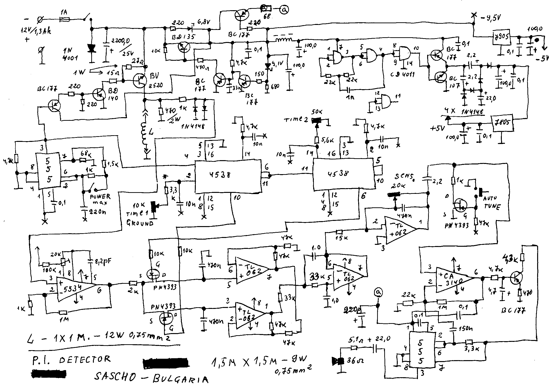

                    http://bgcenter.net/users/p.i..JPG
                    Good quality schematic.
                    Please,save in Geotech thread.
                      http://bgcenter.net/users/p01.i
                      Schematic here.
                      Sascho

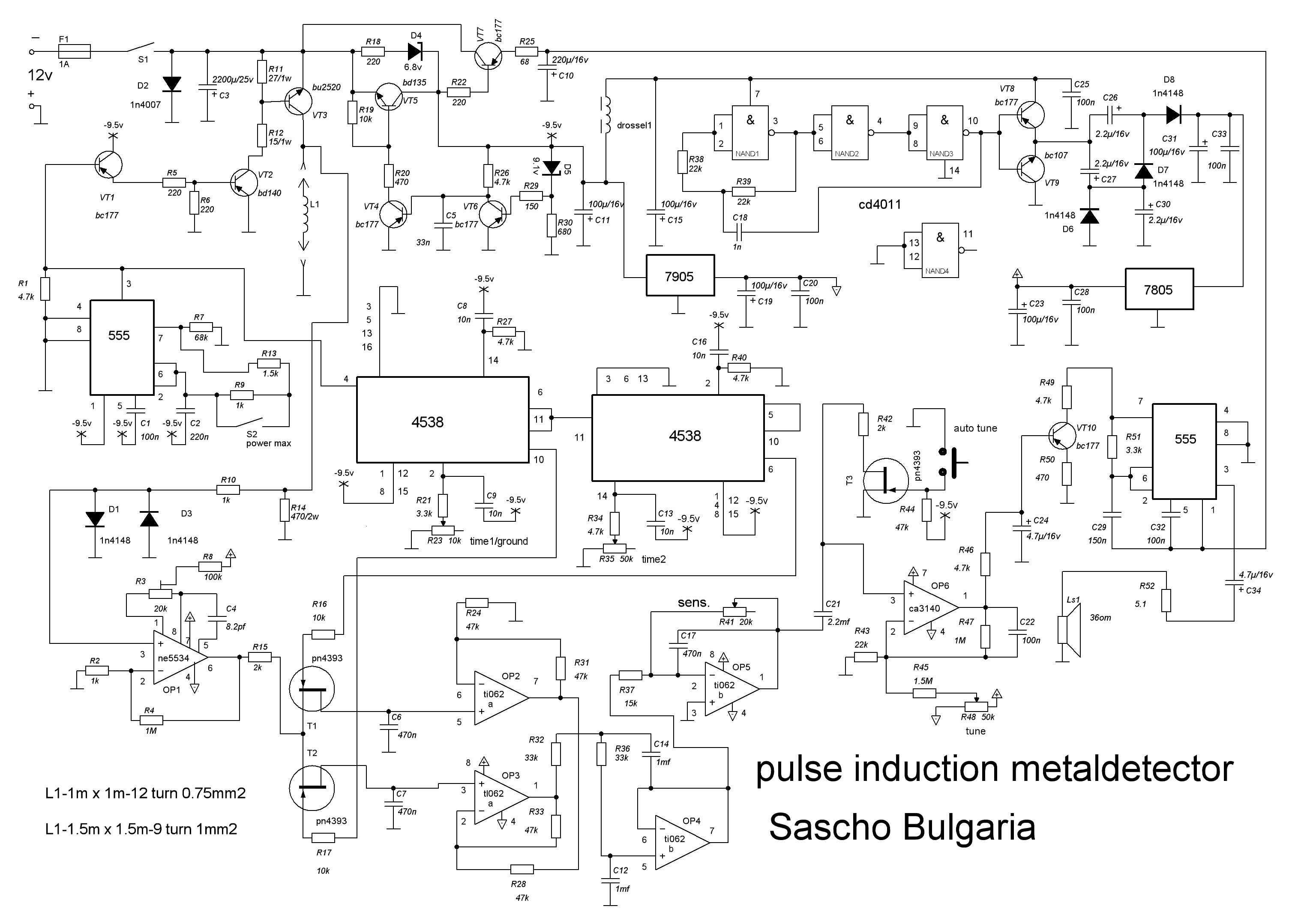

                      • #41
                        http://bgcenter.net/users/p012.i
                        Schematic here.
                        Sascho

                            Are you built LRL yet?(long rang locator)
                            San indigan antenli detector dozatmisan?
                            • #44
                              This is normal pulse induction metaldetector,NOT long rang locator.LRL is principle not seriously.
                              Sascho.
