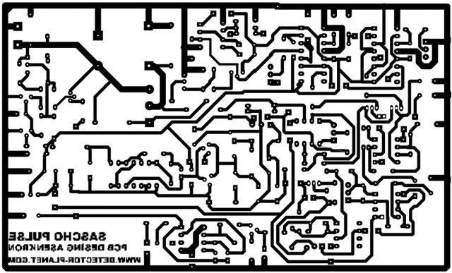

            Hello
            PCB drawn by Asenkron at Turkish dedektör site.
            Please check it,nobody built it yet.
            Best Wishes
            Erol

              • #67
                Sasho,
                Please give little help here.
                Now the only thing that left is the value of drossel1?
                What we should use? 1mH?
                Is resistor like ok there.
                PCB looks rely good.Can't see mistakes.
                So I will begin making this unit.Looks like good first PI to me.

                      • #71
                        Hello
                        Part placement diagram attached for pcb.
                        Please be cerafull blue line connections on this Pdf
                        which Not shown before.
                        Thanks to Asenkron for good Pcb.
                        Erol

                              • #75
                                Thank you very much!
                                Except few unknown capacitators and the upper conection around NE5534/where is conected this resistor to pin 7 and 8 or just to 7?
                                Every thing else looks cool.
                                Very elegant PCB.
                                If anyone spot mistake please alert.
                                I am in the middle of collecting parts.
                                Found those damn 4393
