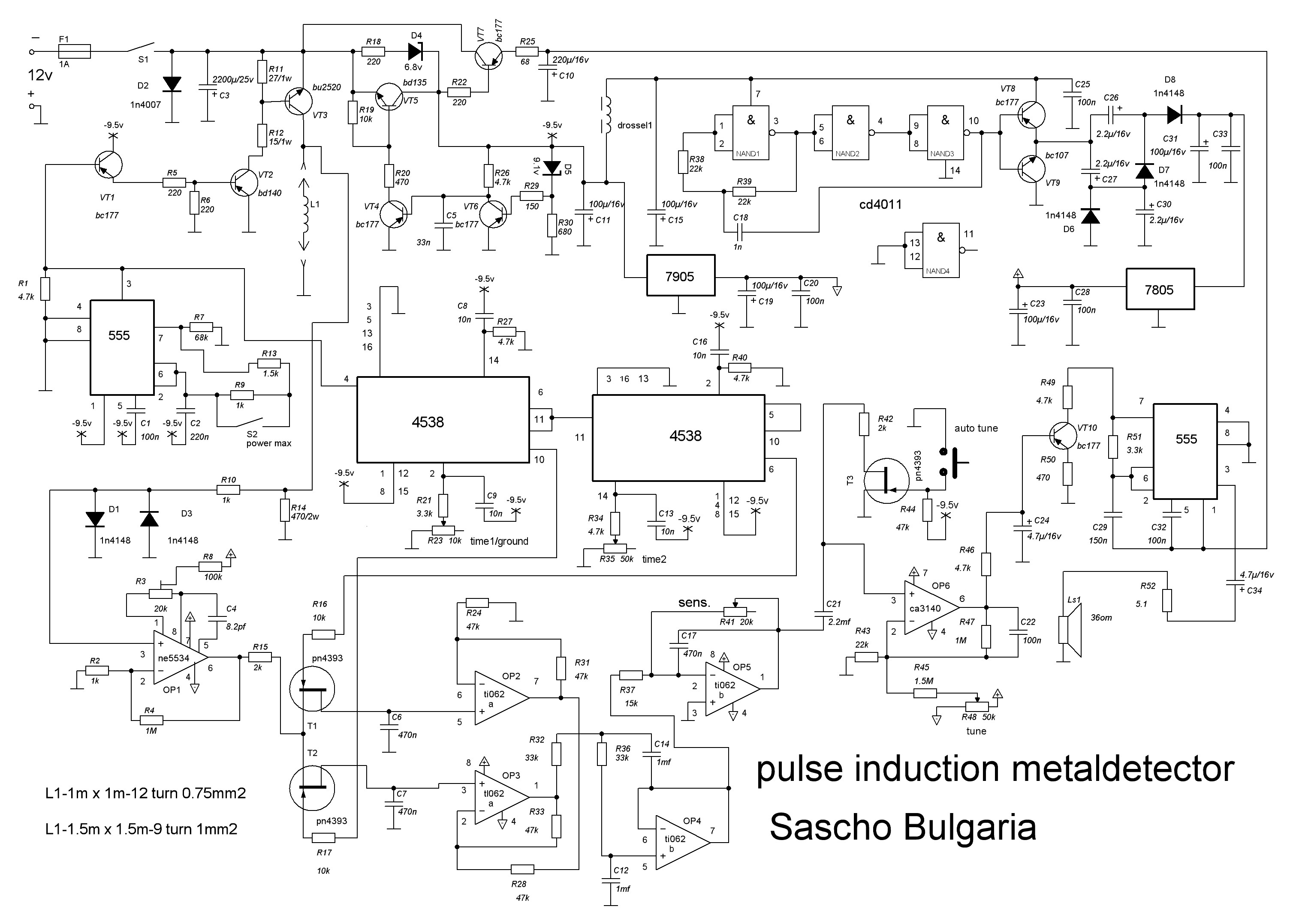

    Hello Jsk
    İf you say where are the faults asenkton ready to correct Pcb.
    Best Wishes
    Erol
    • #92
      A few bugs. Instead of 7805 and 7905 use the 78L05 and 79L05. OP 5 foot 3 must connect to GND, CA3140 output is 6 rather than 1, cd4538 (right side) exit 6 shorted to GND. CD4011 power supply must convert, at 555 key compact R13 and R9. I mentioned what I found in red, is perhaps even more bugs.[IMG][img=http://img44.imageshack.us/img44/6724/pcbr.th.jpg][/IMG]
      • #93
        And one more thing. The diagrams are the differences, the transistor VT7 otherwise connected. Which is correct? What the transistor is there to do? It is a stabilizer?

          • #95
            pcb nın kaynak cizim dosyasını kaybettıgımden duzeltmelerı yapamamıstım.tekrardan pdf indirdim cizmeye karar verdım.pcb de bulunan hatalar veya bazı kısımlarında yapılmasını öngördugunuz modıfıyeler var ise bana bıldırmenızı rıca ederım. erolunal , humhum tercume konusunda yardımcı olun lutfen.
            • #96
              A blast from the past, project looks dead,
              as pointed out, I have made the CA3140 output to show as pin 6, c24 looks fixed.
              Fixed pin 6 on right side 4538 should have been pin 16 to Gnd.
              My only interest in this schematic is the integrator.
              • #97
                Zdravei Sasho!
                Kakva e rolqta na praktika na vtoriq strob ?Spored mene povi6ava KPD-to kato cqlo na integratora.Nai ve4e me interesuva kakvo da slu6am pri nastroika.Po kakav kriterii se nastroiva?

                                Still being a PI design it's either motion, non-motion or both. Wondering which one is it planned to work with?
                                Looking at the schematic, it appears to be non-motion. Also, it would need to be non-motion with a 1mx1m coil.
