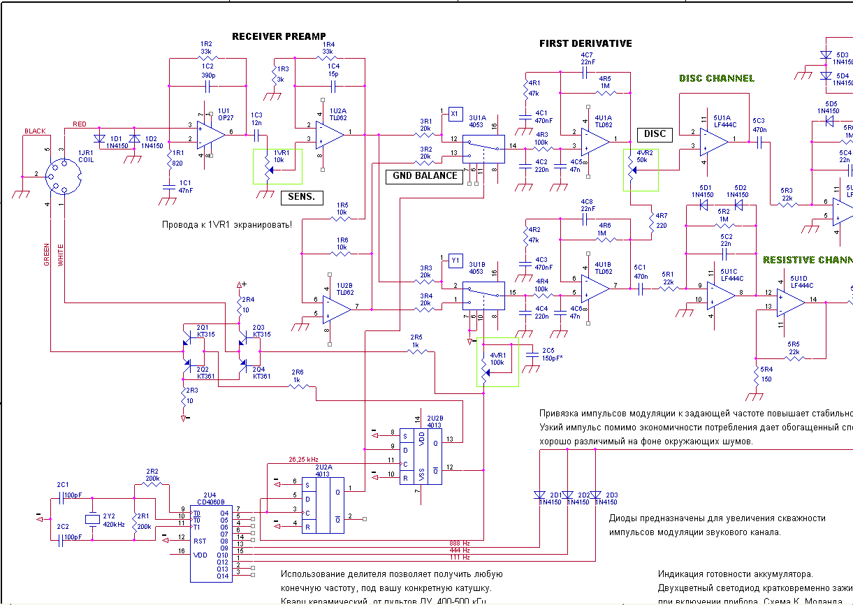

      AFT... you posted oscillator part from 6000DI/Pro...latest of those.
      Previous debate was on old 6000...without simillar oscillator...
        Coinmaster 6000DiPro with 3.2768 Mhz X-tal modification.
          rael, more better way is to use a ceramic quartz. they are meeting on 420-500 kHz, used in remote tv set control panel. not unique rare thing in a shop.
            Thank you. KT315

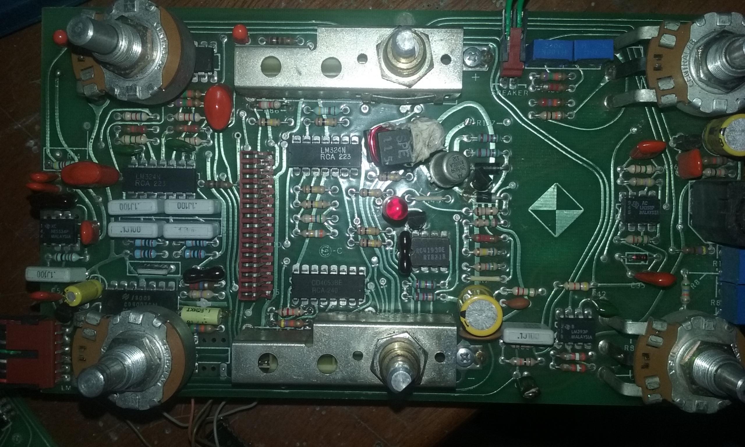

ID:	346334I have the same problem I cant found the rigth shematic, coinmaster 6000 DI 2 version, its only have 4 batteries each one of 1,2v, and in this version dont have 78S40 for up de voltage, somebody have this..?
