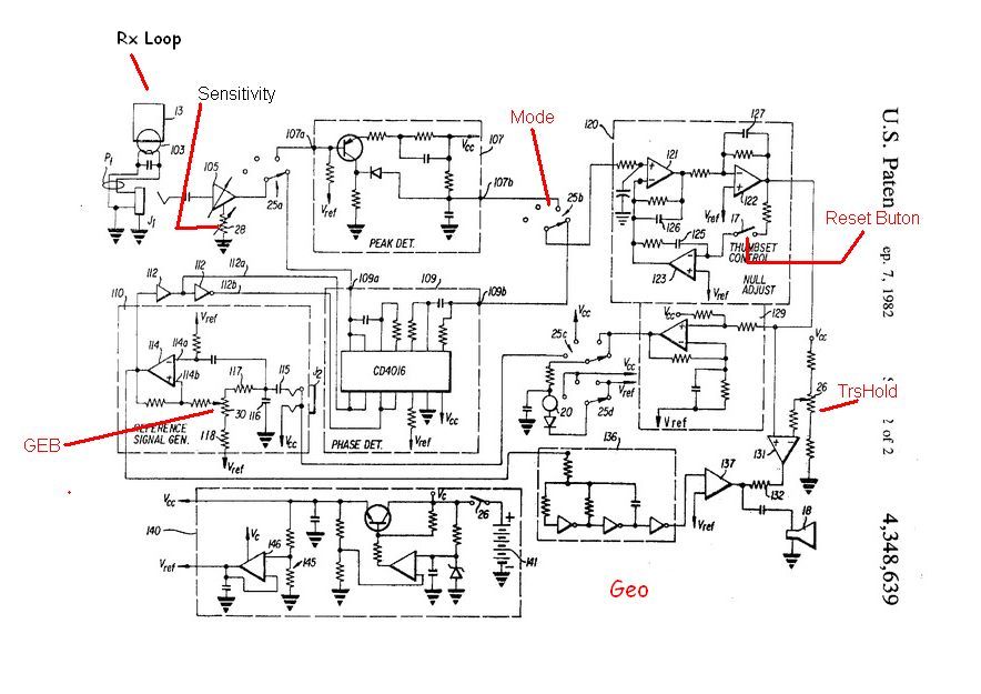

            Hi.
            Can you write the numbers of the IC's??
            I think that it is the same with the TF900 and TM800.
            If it uses the same ICs then there is a schematic (but without the component values).
              Hello Geo:
              1-CD4069CN
              2-MC14016B
              3-LM393N
              4-MLM358P
              5-CA3 I 40AE
              6-MLM358P
              7-MLM358P
                hola jose antonio, en el esquema no pusiste en donde se debe colocar la tierra de la bateria
                in scheme, where should i put the ground? or baterie negative? here i see 3 possible, points of (- ) thanks in advance
                dman
                  Hello, in the number (3) wires to voltaje and to shield.

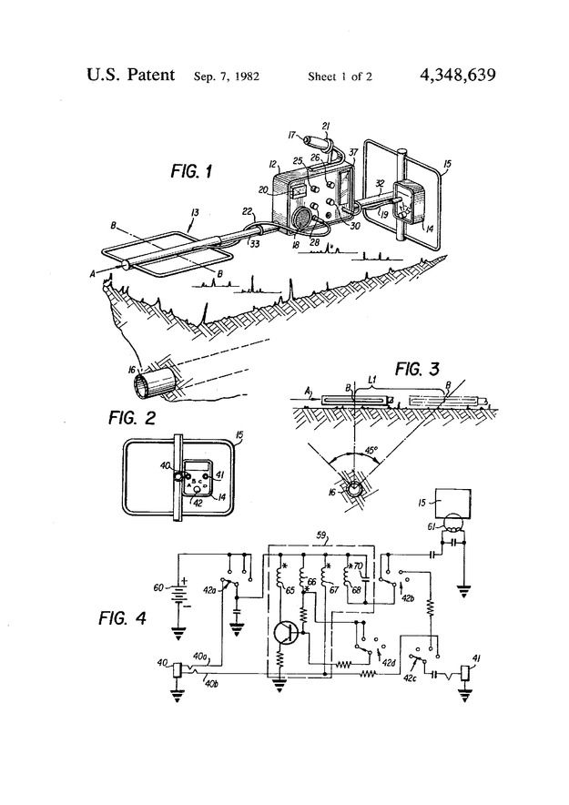

                      Very good article.
                      TF600 has the same ICs with the whites TM800. I have read that TM800 is the same with the TF900 but now i see that TM800, TF600 and TF900 are the same.
                      I will try to give here the block diagram of TF900.
                        I attach here the block diagram.
                        Also you can download the patent article
