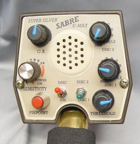

    Hi to all
    Anybody have circuit diagram ?
    Best regards .
    cool like seems machine... transformered from Compadre I believe. all are in your hands... but hands must be skilfuled.
      yes it's a mod of existing stuff... look at knobs they aren't by tesoro... then the two switches etc
      I saw it on a thread "super silver sabre..." on this forum some time ago... but man that made it haven't posted any circuit for mods as far I remember.
      But you can made too... just have to mix some of the schematics already here as KT315 suggested.
      It's easy... (for skilled people).

            don't remember about compadre schematic, I think I haven't. But I think that original thing was a SilverSabre not Compadre... then with mods it has panel geb and two disc pots... so you need SilverSabre schematic... you can find in its thread in the Tesoro section.
            I think he just mounted a pot for GEB on panel thus removing the trimpot from board... so he can adj geb on soil... and gain better sens and less false signals.
            Then he add another disc pot and a switch to commutate from one to another... making maybe something similar to manual notch disc (first use one disc setting, then use the other to guess what metal target is).
            Seems very easy to replicate... look at schematic of silver.

              Hi Max
              Thanks ,I had SilverSabre circuit , I also thinking similar you about
              What we see in picture .

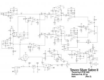

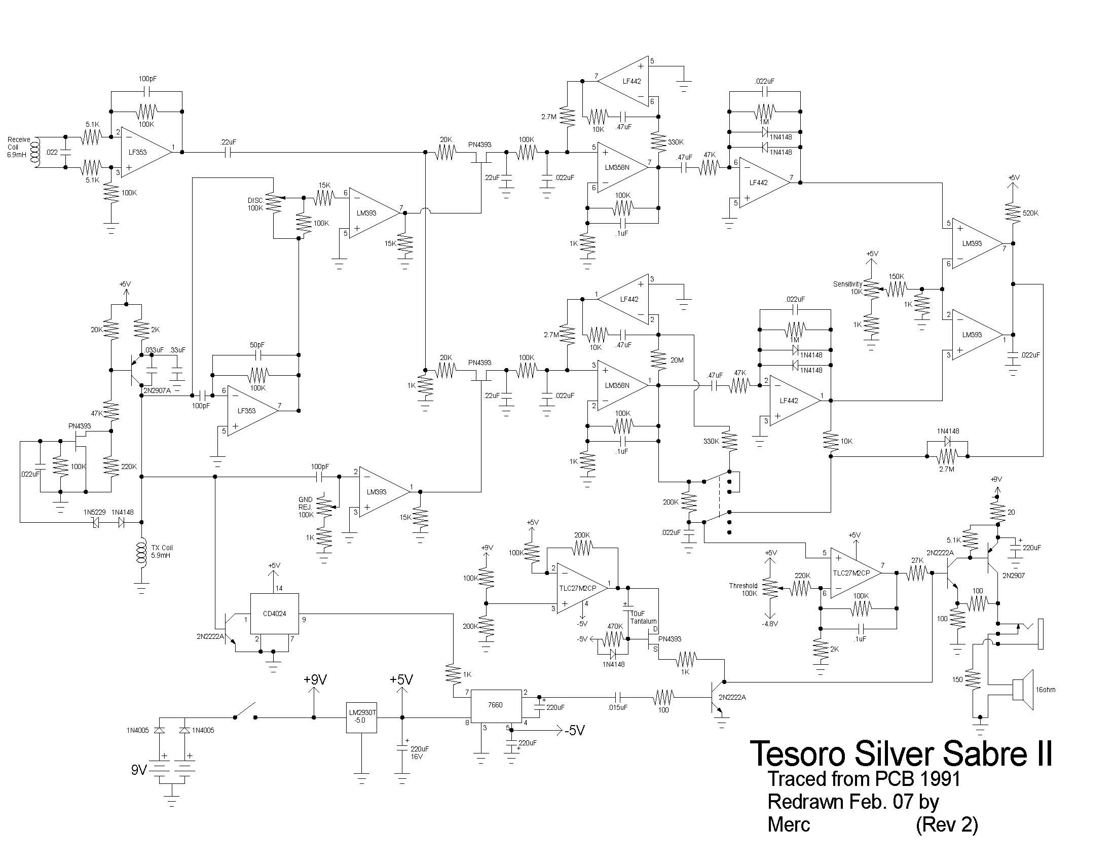

                Hi
                SilverSabre II circuit by Merc.
                  Excuse , SilverSabre II with better resolution.
