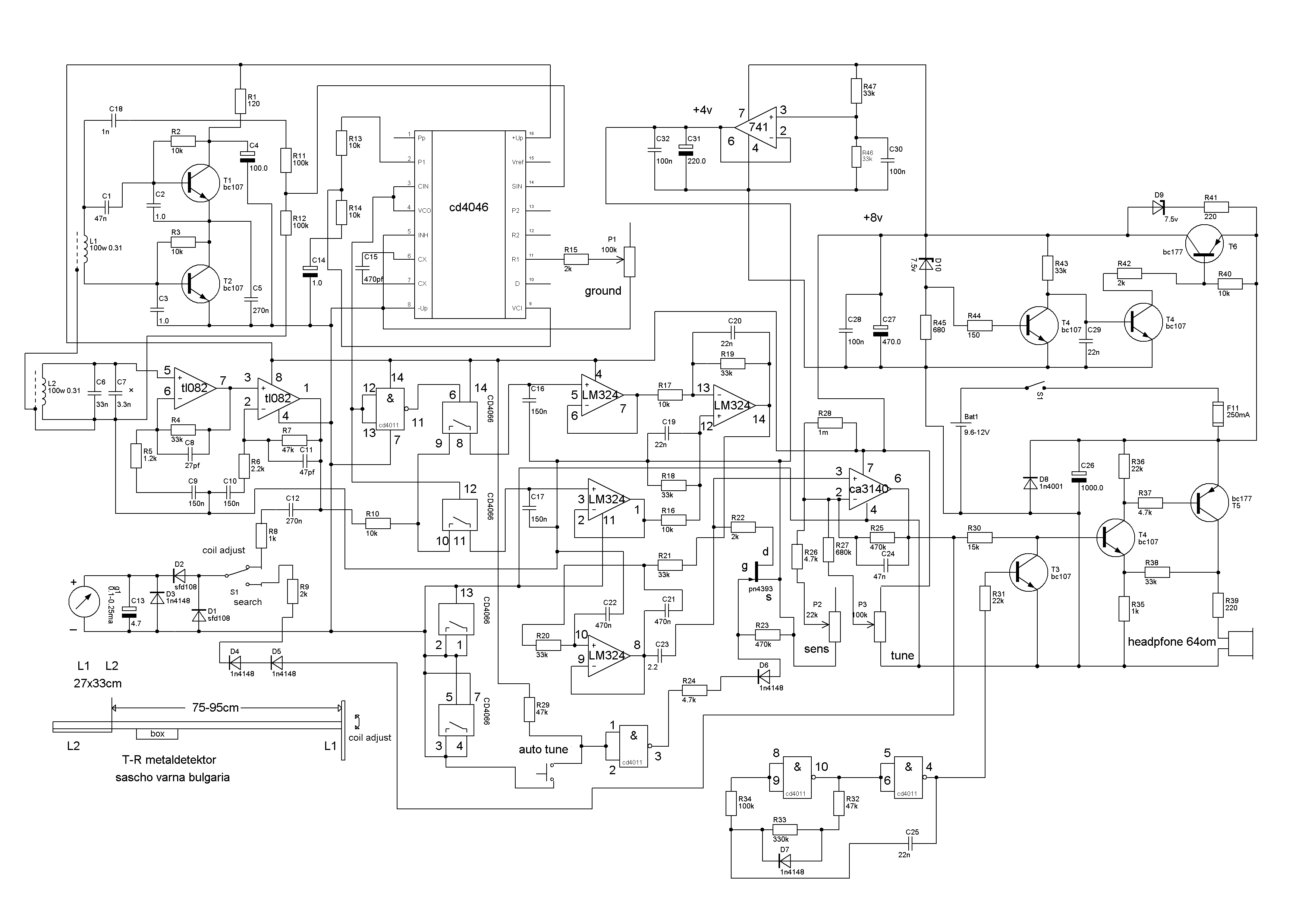

    I need "Deep-searching R-TR metal detector Sasho- Varna, Bulgaria" schematic.
    Hi Kiki
    This is Sascho diagram .

          2 box explanation
          If you are Sascho, why change your name?[COLOR=black]
          Hwllo Sascho...where are you, helloo...hell...hell...shoo shoo... can u explain the 2box schematic pls, If I understand its seeing the carrier waves detected by PLL4046, why there are sooo many IC's and many transistors Mr.Shooshoo, whats wrong with the older 2box in the projects section.Do u have good single PCB layout........explain the circuitin blocks and part numbers

            hi can you send me some image of working detector i built many more t/r detector. but i'm didn't surprise any one.i found very loose sensetivity and too much fluctuation.
