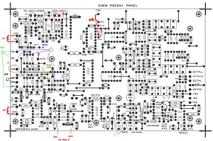

X14, PCB A, "aku vybity" is connected to PCB B, K2, pin "signal aku vyb"
AM/FM is really not used, so dont place part U100 and parts with index 100 and more around it.
Coils - end of TX coil is connected to begin of COMPENSATION coil, end of COMPENSATION is connected to "last turn" for final compensation of coil. All of it is TX coil and is connected to TX oscilator (PCB A, X3 and X4). RX coil is connected to RX pre-amp (pcb A, X1 and X2). If you want external pre-amp, so make same RX pre-amp as U8 and parts around and place it everywhere you want (for example 30cm from coil on holder).
Tuning - find R7 on pcb B and add Dt1(yellow). Then break link between R7 and pin 3 U4-A on pcb B and add R7-A (blue). Then cut off R21 and add same rezistor between point R7/C11/Dt1 and +8V.
