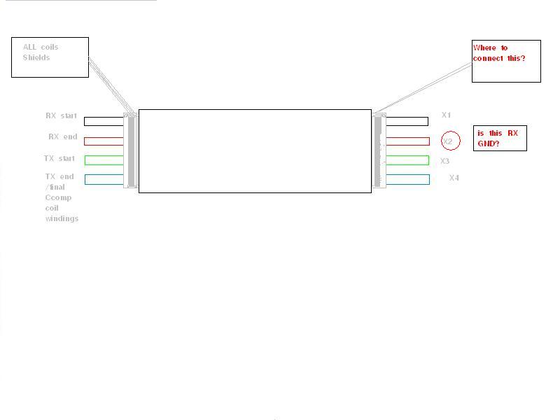

        Please check this picrure too.

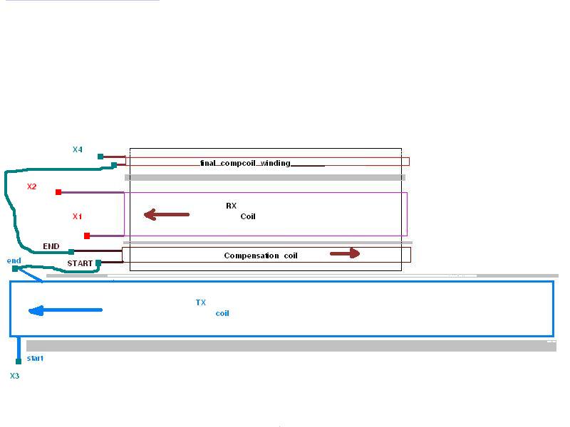

              Please revise all!
              So where should I conect my multimeter in ACV to read nulling?
              And then buy fixing FinalWinding of Comp.Coil/direction/I null this coil!?right?

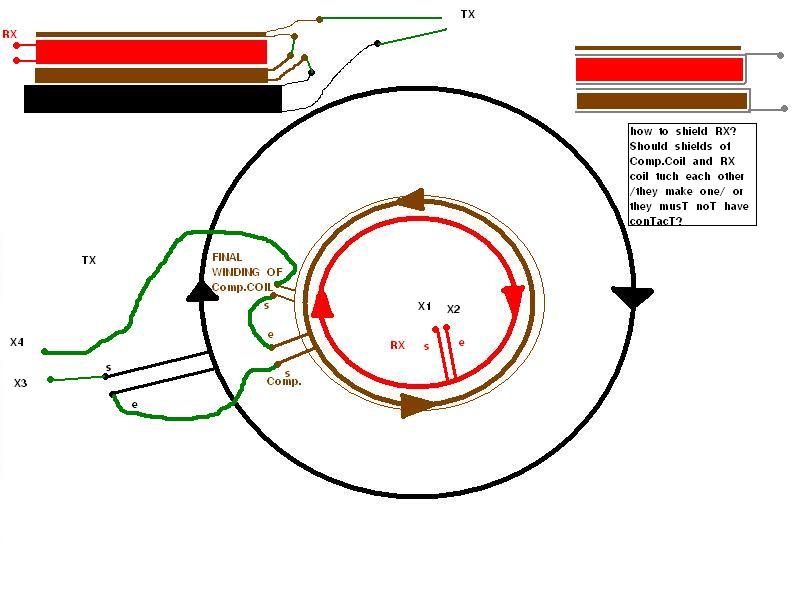

              Is Compensation coil same wire d as RX?0,25mm bare wire!?
              • #67
                You can use for all coils 0.25mm wire, but for TX is better 0.4mm.
                You can use only alu-stripes over the TX and RX coil, but better is alu-COMP-alu-RX-alu (like a sandwich), all alu-foils have a split/space about 2cm around terminal leads of coils. Use only one layer and for better connection you can use bare Cu wire, which is wind with alu foil (must be splitted same as alu-foil).
                Dont forget to glue all coils with varnish between you wind a alu-foil and next coil !

                  I cant understand how you make conecions between the f.cage layers?
                  I cant solder foil,so I use thin copper wire.But I usualy wind around the winding stripe of al foil forming shield.So as you explain me I cant get it,but first to build unit I will think again for coil and will contact you.
                  And in pictures I have insered a small questions!!!Will be glad if you answer this too.

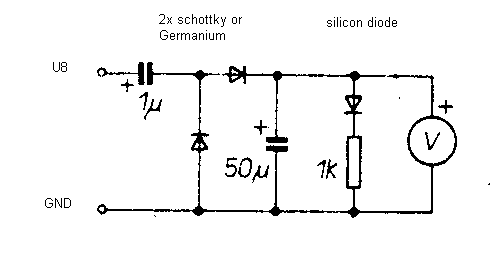

                    • #70
                      Here is some preparation for coil zeroing with multimeter.

                        Right?
                        Please explain.
                        And I will be glad if you post more pictures of the ready unit!
                        • #72
                          schottky diode is a fast diode
                          http://en.wikipedia.org/wiki/Schottky_diode
                          1N5711, BAR42 or 43, BAT42 or 43 or another
                          1N4148 you can use instead silicon diode. You are right, read smalest DC value on your multimeter....

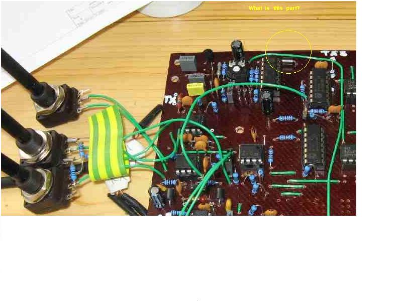

                            Can you tell me what is this part?
                            I can see.
                            • #74
                              It's only anti-interference ferrit core (perl) with cooper wire (if you have'nt use only jumper)

                                Where did you conect speaker?
