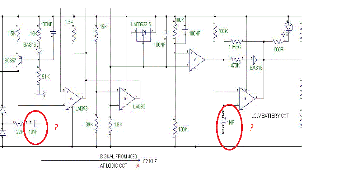

                • What type of capacitor ?
                  1Nf = tantulum capacitor true ?
                  10Nf =ceramic capacitorClick image for larger version
                  • 1 nanoFarad is not be tantalum electrolitic. somewhere is mistake.
                    • maybe 1uf electrolitic
                      • Originally posted by serci78 View Post
                        Correct
                        • If you look at the sd2000 pcb in the schematics, there is a tantalum capacitor within the power supply section. I believe the polarised capacitor marked as 1nf on the schematic is this tantalum capactor and maybe should of read as 1uf. I have tried with an 1nf mkt capacitor and an 1uf tantalum capacitor and my machine ran ok with it with no noticeable difference. I wouldn't be to worried about that capacitor as I think it serves the low battery monitor.
