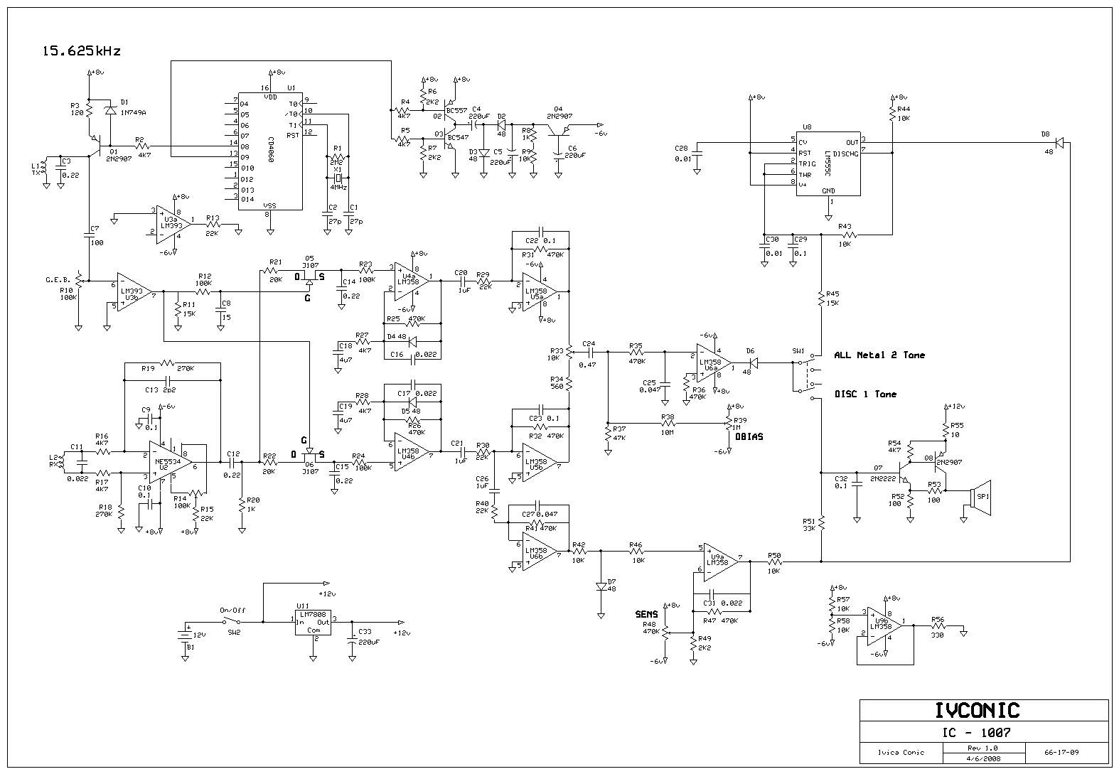

    I "designed" this schematic combining various stages from various projects, taking from accurate,already workable devices.
    I liked 2 tone Rimatron option, Quiaozhi posted a while ago here.
    Also i took oscillator from White's 6000 DI Pro, but this time driven by CD4060, dividing from 4MHz crystal, which is easy to obtain everywhere.
    TGS look-like RX is good enough,although i used NE5534 taken from Sean's CoinHawk. Better solution than LF353,for sure.
    And of course again from Tesoro - audio stage.
    PCB not drawn yet.
    First need your opinion here about this.
    Quiaozhi, i would prefer your opinion mostly, due your epxeriences with Rimatron, already.
    I "played" a bit with power potentials here.Not sure i did right.I could omit chopper stage and generate "virtual" ground with that extra op-amp, yet Tesoro chopper design still have more advantages.Major should be general
    synchronisation applied to all op-amps here.
    So ... need opinions.
    If no remarks i will draw pcb and made prototype for testing.
    Regards!

    May be have a conection in base Q4 and R8 ???
    DIRCEU
      Yes indeed, i missed that.
      Regards.

        A 2.2 pf cap around C18 to make truer differential.
        Also pin 3 output of 7808 as +8 volts not +12 volts.
        all I saw quickly.
          R18
          I meant R18 not C18.
          duh.
            all I saw quickly.
            Yes it is trivial mistake, switching 8 to 12 volts. So obvious.
            Other...i will see.
            Thanks.

              The 2-tone mod seems ok to me. I cannot see any errors there.
              This "design" looks like it has a chance of working. Go for it!

                    Nelson thank you very much for those words. Yet i feel vexation cose i am not ultimate constructor here. I also learned a lot from others here.Just because i learned from many others, i do not want to write names here. I am still learning.
                    This schematic is not my intelectual product. It is just a mix from various schematics, by which i did some devices in the past.Proven. Yet, fact that those stages in schematic are already proven,doesn't mean that this mix will work excellent from a start. I have fears that signal is not synchronised well passing from one stage to other. Mostly i have doubts in power potentials, which are wired "on the fly" here.
                    Quiaozhi is very conversant electronician, yet devil ... wanna see me again pretty disapointed here, when finish device and realize it wont work the way expected!?
                    But it doesn't matter, i will draw pcb and make device. Later i will post results here.

                      No - seriously - I think this has a chance of working ok, although I don't expect it will work first time. No doubt you'll have to tweak a couple of things.
                      OK - you could simulate the whole thing, but I know you don't like doing that, and the simplest way is to build it.
                      Good luck.

                            Nice work!I am shore it will work!But will it be as expected no body will now until we test it.Yesterday I have tryed to draw a PCB but I am still to slapy and dont have a nervs to do this.If you draw a PCB I will get to soldering right NOW!
                            What is the cristal in the original?
                            Because I saw here many?
                            What is the coil?

                              With only one GEB channel and high gain ground balans in tone discr. is problem.Use two GEB channels.
