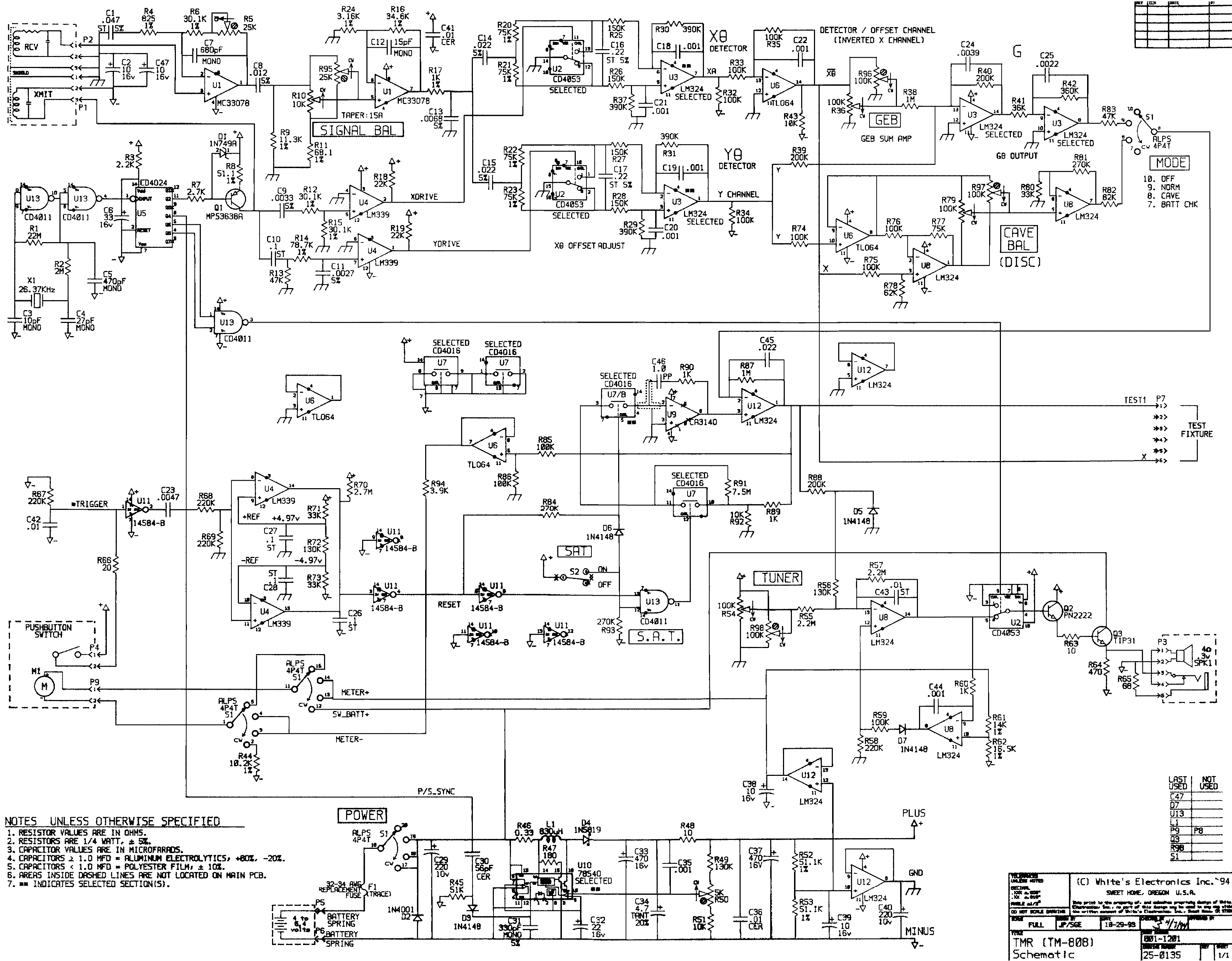

            Here schematic found on forum

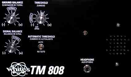

              Esteban. I check Erolunall photos and i think one: its not the same detectors!
              TM 808 have 13? IC's - on Erolunall PCB i found only six! TM 800 is totaly different
              Erolunall better tell us what is wrong?

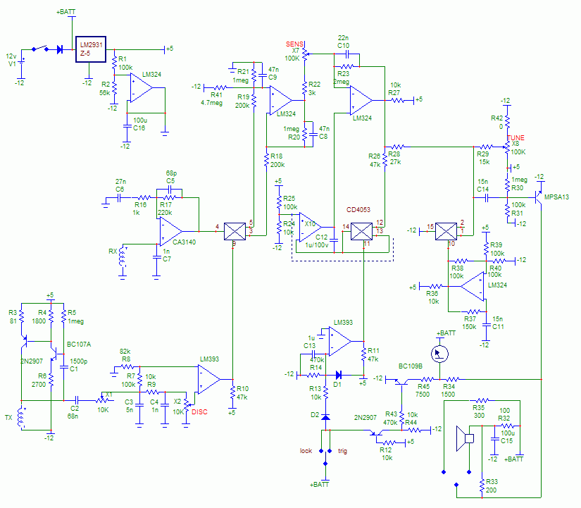

                Here is my contribution , Eugene
                  Im sure so TM 800 it is not a the same detector like TM808. Check Picture048.zip.
                  Where is XTAL there used in TM808? ICs lost in action?
                  Maybe its a RC bridge like this?
                  Looks smiliar but its not the same md - but TM808 circuit can be useful here. Youre right...

                    Yes There is TM800, TM808 and TM900 . I posted TM808. We still need TM800!!!!!!!!!!!!!
