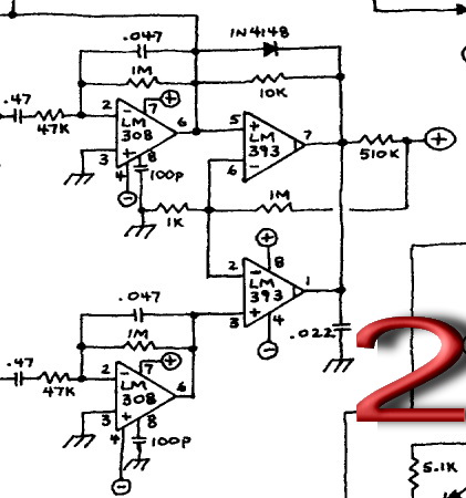

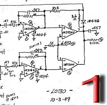

Finally copper wire arrived! it's 0.22 mm.
I started same fast test and seem i have same problem around disc channel.
All metal seem working in good way.
In disc and gb channel i can follow signals with oscope on second lm358 and they are good but i lost them around 308 and 393, it seem i have same problem in this part of schematic.
I hope solving problem in the next days.
