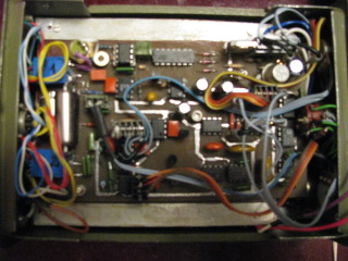

    I try very schemes, Lobo was the last before TGS, but I like and the sound of real life into LOBO, discriminate cool and contaminated land, land with no problems, also holds temperature dobre.Dalbochinata also good.

      Hi Tchoci
      I found on my board that rx phase must be a little positive respect tx signal for best ground balancing and disc, may be +20,+30°.
      What about yuors circuit?
      32 cm look very good! on my board i detect a 50 eurocent no more 25 cm in air.

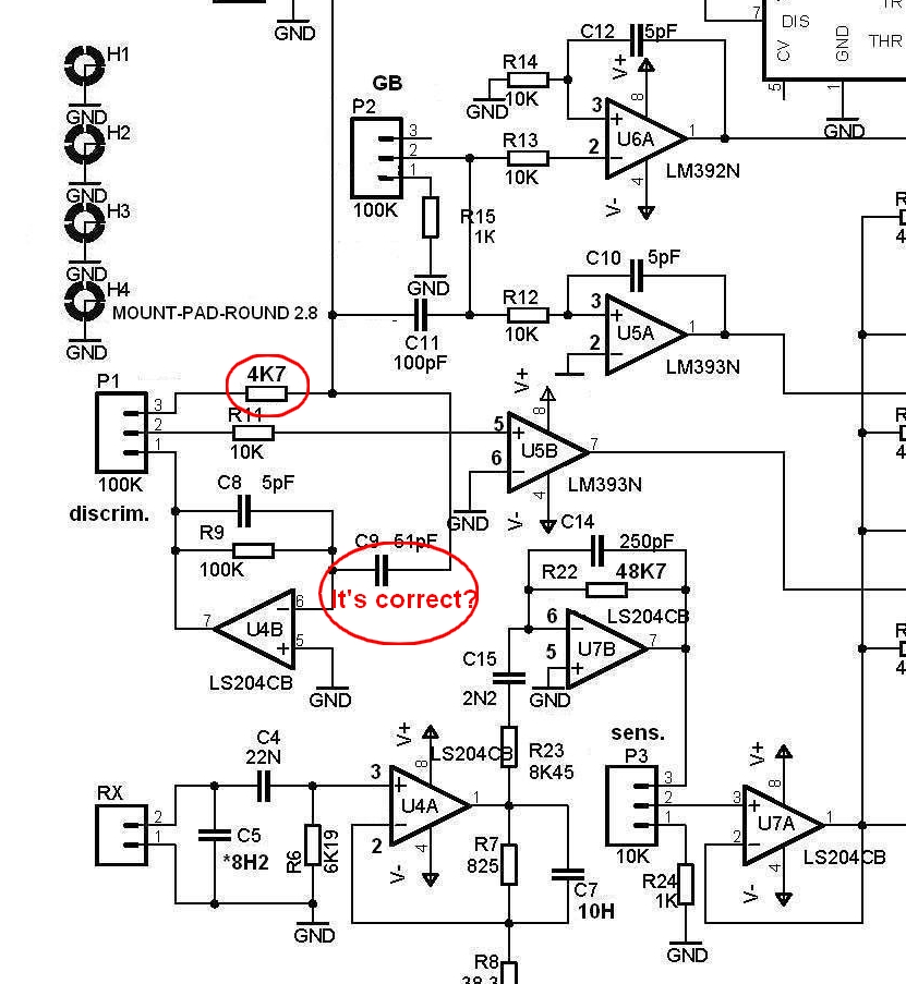

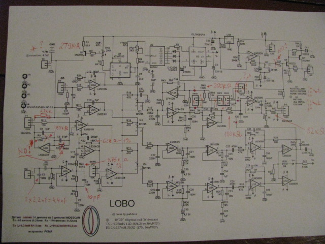

        Do not forget that the efforts of a host depends on the amplifier OOV for each school should be carefully selected resistors OOV.V case of U4.
        • #94
          In my case, a R7 = 1,25 kom.Probvah a higher value but started to do curves and land.

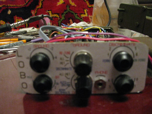

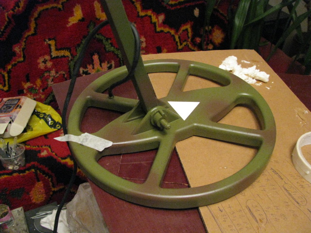

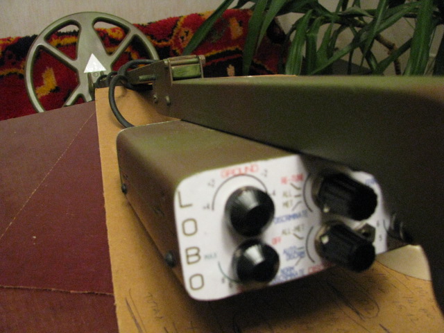

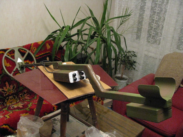

                  • Lobo Improoved !!
                    Originally posted by tchoci View Post
                    Hi Foma, are amendments to the final version shemata.predniya still worked well, but these small changes work better with a black stone and orudena pochva.Izpitah it before the big snow.
                    Hello tchoci , Excellent work with your Lobo !!!! I really like the military-camo color and the battery pack location .
                    Thank-You again tchoci for some really Great postings here .......Regards..........Eugene52

                      • Lobo modifications
                        Hello
                        Can you tell me if the modifications on my attached file are good
                        many thanks
                        Legaucho

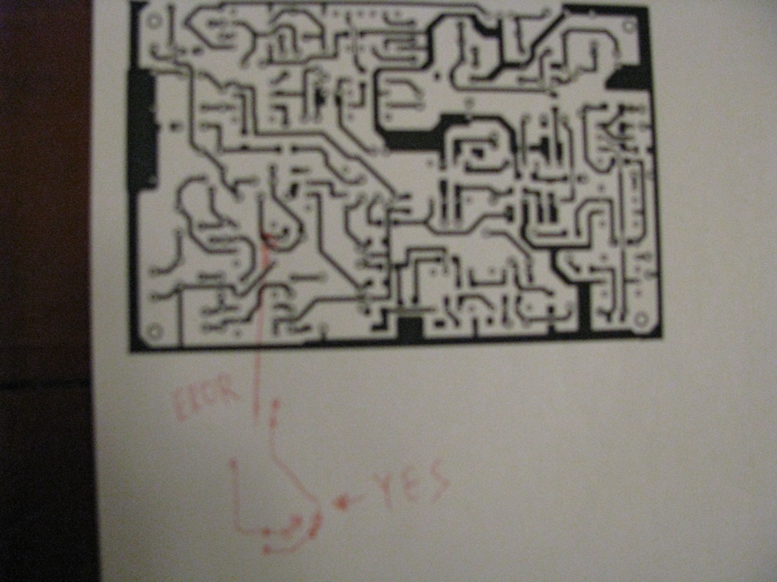

                        • 4,7 Kom with its regulated limit of that black failure metali.Az personally am starting to let me pass because strong mineralization in the soil gives error color / some bronze.
                          Zavravih that the PCB has an error of diskriminatora.Prilagam korektsiyata.Uspeh all colleagues!
                          Tchoci.
                          • lobo improoved
                            If you are not using an "original Tesoro Search-coil " when building your PCB-circuit board , then the problem is with your Search-coil and winding directions and is not correctly nulled .
                            Great Work so far and Best Regards..............Eugene52
                            • HI thcoci.
                              The Mistake I have corrected. Thank you.
                              Scheme is bad seen.
                              S1 and S2 has not understood.
