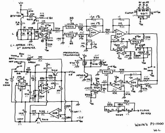

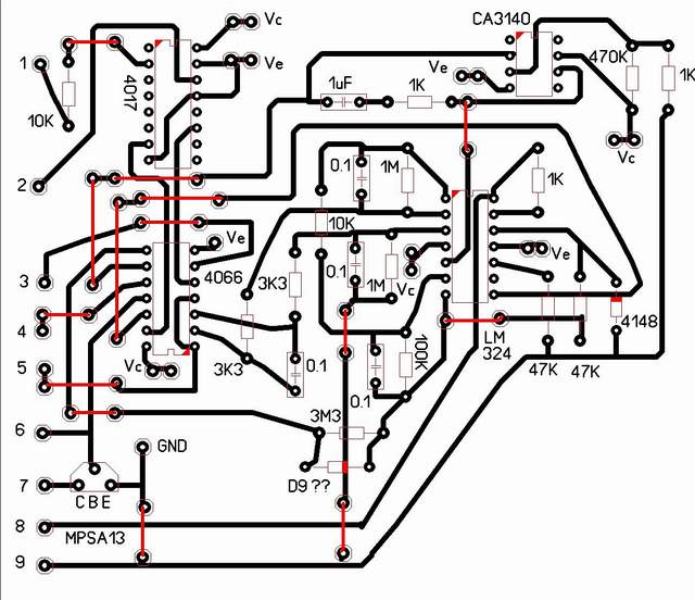

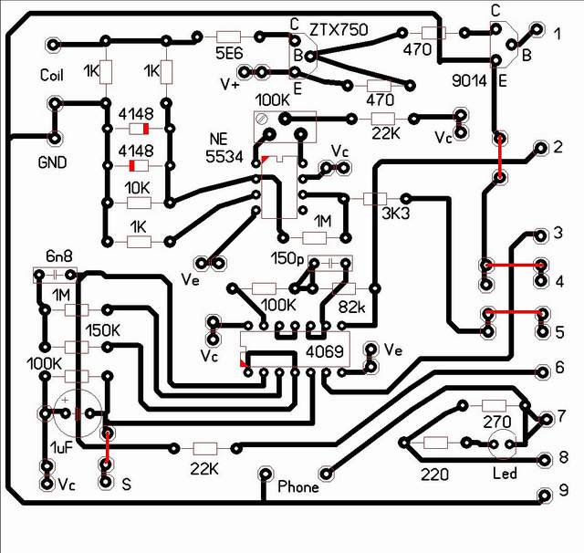

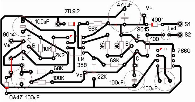

    Amtech 2005 posted pcb's and hints about making this detector. I was interested and performed detailed checks and comparsions with earlier posted schematic. It has some differences from schematic. I am wandering are those two versions? Looks like pcb's are from older version. Anyway it is enough interesting to be inspected more.
    And schematic...

        WOW , Amazing !!! Look how PROFESSIONAL and Better looking The PCB "layout" looks !!!!. Great Work !!! Taking old Stuff and "REBUILDING" everything again !!!! IVCONIC VERY COOL..................Bye.......Take care.......Eugene

            Are those 0.027, 27pf or 27nf?
              If there is no label, then it means 0.027uF. i.e. 27nF.
