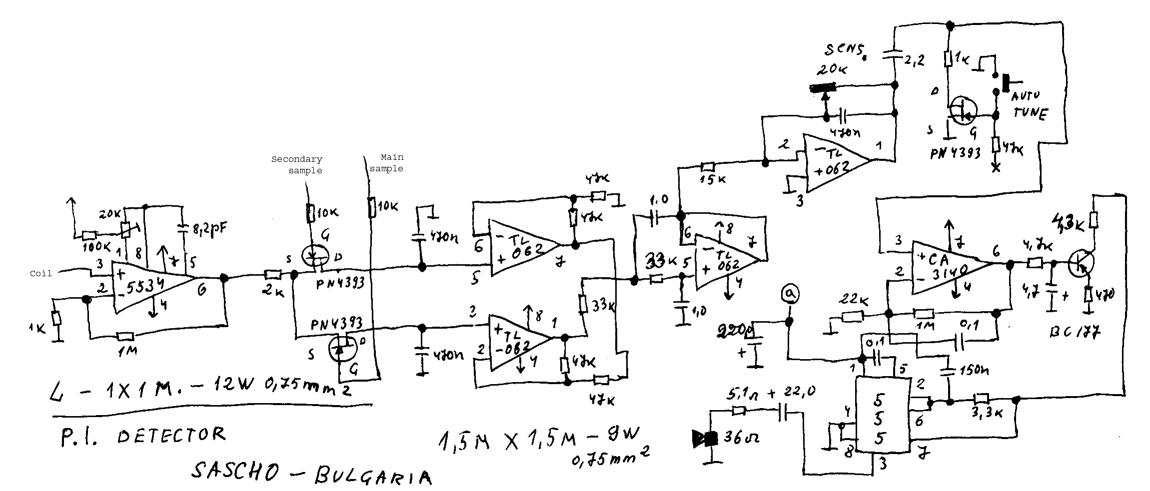

    Schematic:

    LRD
    Hi Sascho,
    Can I know why did you use TL062 for the your PI? A TL072 with much lower noise can be used...

    1843
      To1843
      TL062 work in low power DC amplifer.Consume power is problem.Noise is no problem.Input amplifer ne5534 is low noise.
        Ok! but I got more than 100mA of current from the your PI DC converter!!!
        Anyway thanks,
        1843
