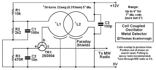

    Hi ALL
    please does any one have a schematic of CCO metal detector from Thomas Scarborough Book 3
    thank you very much

    Is this what you're looking for?
      it's a BFO
      But what's the name he proposed for it ????
