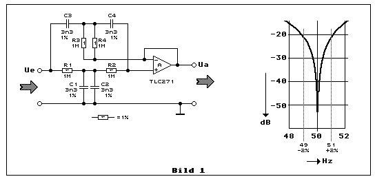

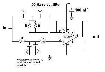

    ı need 50/60hz noise or notch filter for ZAHORİ (ivconic) device.
    This is a good filter. Other figure the same filter with pins of the IC.

            For small signals, it might be usefull to reduce the 1 M resistor and increase the capacitor instead. 1 M resistors have a big thermal noise.
            For the cut-off frequency take the following formula:
            fc=1 / (2*PI*R*C) [Hz]
            Taking R=1M and C=3.3nF:
            fc=1 / (2*PI * 1.0e+6 * 3.3e-9) = 48.23 Hz

              Aziz you got the point. However, sampling frequency at Zahori is adjustable in wide range, so...it should be hard task to establish proper filter to cover all the range there..hmmm? Dont have a clue?
              So as i noticed, there is one "sweet" spot at 2M2 pot. where Zahori starts to work very clean.
              Never tried to examine that more...sheesh! Lazy me!

                Yes, but with 1% film resistor noise will be reduce.
                Esteban
                  Hi all,
                  yes, 1% metal film resistors have lower noise characteristics. Ban all your 5% resistors from your metal detector!
                  See additional (thermal noise):
                  http://en.wikipedia.org/wiki/Thermal_noise
                  The lower the resistance, the lower the noise!
