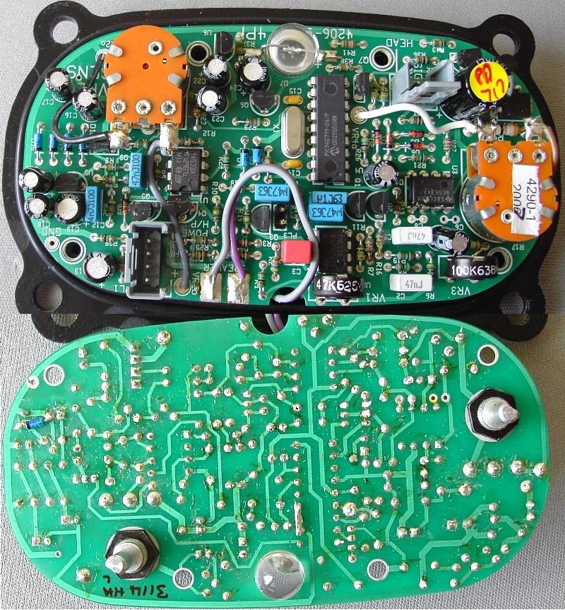

        I have did share this not-mine photo of Goldscan-5. MOS-FET in DIP-4 also seems. I do not know Eric has opened new era in PI or, more probably. we are pepithecanthropes in these PI perspectives on the 'hight' ohms coil.

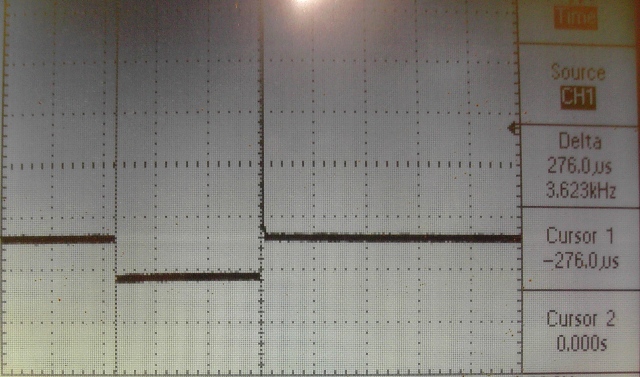

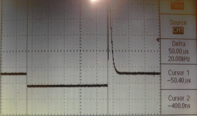

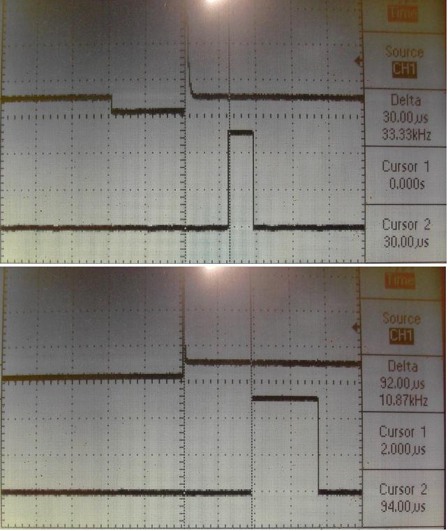

              cs4pi oscillograms
              cs4pi working frequency 1.049 - 4.651 khz
              Sample delay 30µs - 92µs pulse transmit to coil 50µs - 276µs peak amplitude about 90 volt

                So this is the Goldscan -5 ?????
                nice n small , compact
                would love the schematic of that
                anyone ???
                cheers
                  CS6PI
                  Goldscan 5 , I am pretty sure only 2 people have that Schematic . Eric and Mr. Bill !!
                  But , I sure would love "crystal-clear" digital photos of both sides of the PCB circuit board for personal use and testing only !!!!! [email protected] I never ask for much Eugene

                    Jonas , thanks for posting the oscillograms of the TX pulse parameters from the CS4PI . So frequency is = to 1.049 to 4.651 khz the sample delay = 30-92 u.s. , which seems slow . and transmit pulse width = 50 to 276 u.s. . So you now have the Data to construct this machine without needing a pic-chip or the trouble to find the locked "software" . Because I believe you can build a pic-chip "Equivalent Circuit" , that will work just as Good , and without the pic-chip !!!!!!!! Just my opinion , any other comments please respond...........Thanks................Eugene

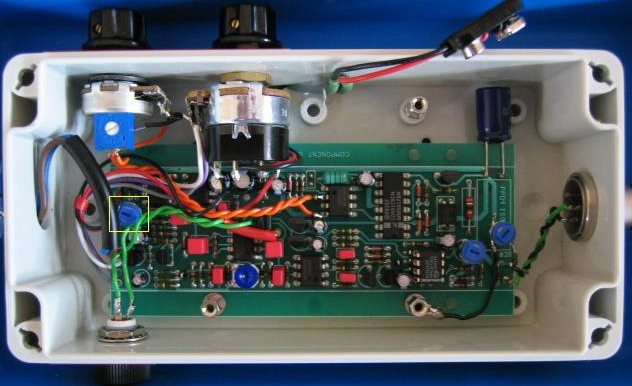

                                There are two variable resistors vr1 and vr3 on CS4PI but I do not know what they do they and if they regulate the ground effect?
