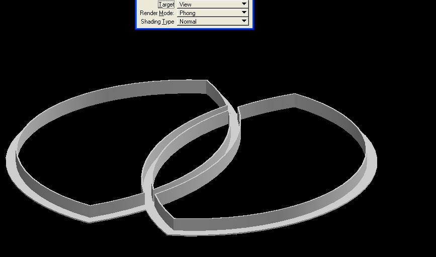

    yes one up and the other down, but if you have an idea. post a draft I will try to draw it.
    I used AutoCAD, but I realized is not possible to export in .obj or .3ds , formats asked on the website to print them. so I ll have to try other program.
    Try using Google Sketchup. You can export your design in various graphics formats, such as bmp, jpg, tif or png.
    • Originally posted by ledoc View Post

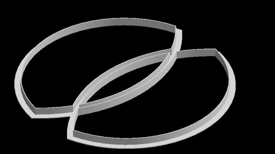

      Iwill try to make it today my friend
      • Tarsos Coil 3D
        Hi Ledoc see if its ok or not
        the complit file in Attachment
        Microstation copy and Autocad
        • Nice work anwar2! but my idea at the beginning was to use this guide to wrap the coil. and to have a good reproductibility. In the case of your design it s not anymore possible :-( (see here: http://www.youtube.com/watch?v=uw2m7UfyvSM)

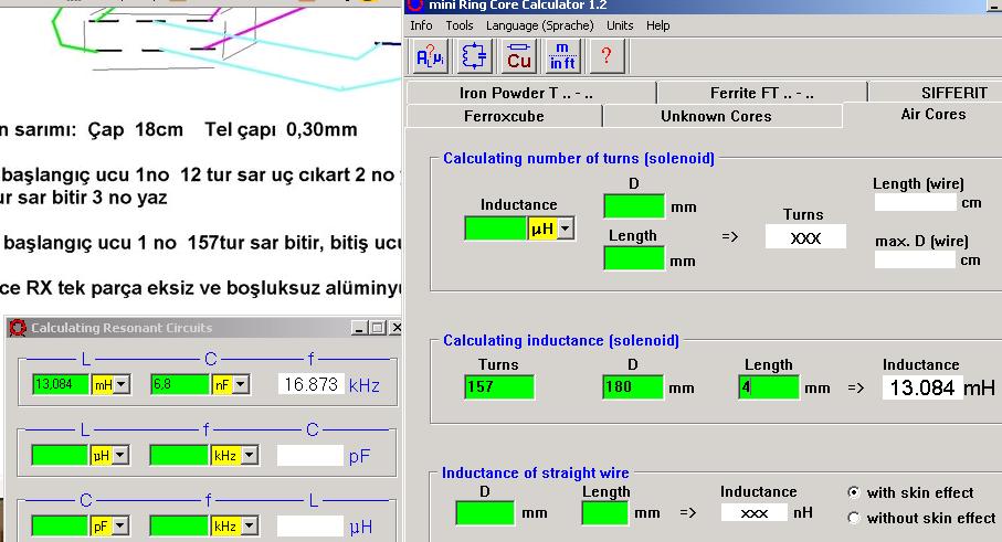

          I finally received my RLC multimeter I measured for my coils these values:
          RX coil : 12 mH
          TX coil : 10.8 mH
          normally the normal values are (source: asenkron):
          RX: 11mH and TX: 10 mH (to confirme!!)
          Do you think my values of coils are wrong?? I followed the must possible the instructions to make them!

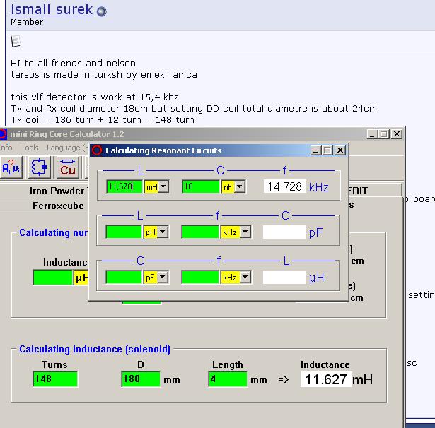

          • If I use the equation of resonant frequency of an LC circuit
            I find for a frequency of 15,4khz:
            - Rx: C=6n8 -> L=15.7mH
            - Tx: C=10n -> L=10.7mH
            Question! The coils RX and TX have to work at resonance point??
            If it s the case I don t understand the value of 6n8?
            • if I use this coil calculator:
              with diameter = 18cm
              permeability of copper = 0.999994
              I find theoritical values:
              Tx -> 14 mH
              Rx -> 16 mH

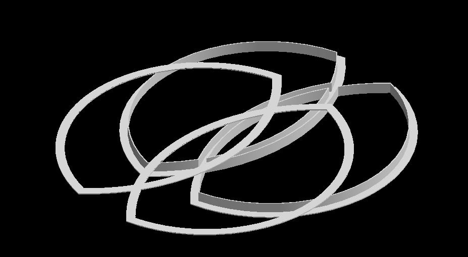

                      • ça y est, I finished to design the support for the coils with the correct dimensions. I attached the file.
                        Unfortunately to print this piece is more expensive that I believed,
                        39$ here: http://www.sculpteo.com
                        22.88$ here :http://www.shapeways.com
                        too expensive for me... pity I liked this idea
