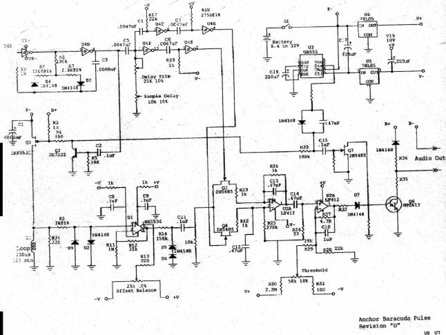

    Hello, regards to all. I am trying to mount my first detector, in this case it is a question of the Barracuda. I have been looking for the forum and have compiled all this information. Is it possible to mount the Barracuda with these components?.

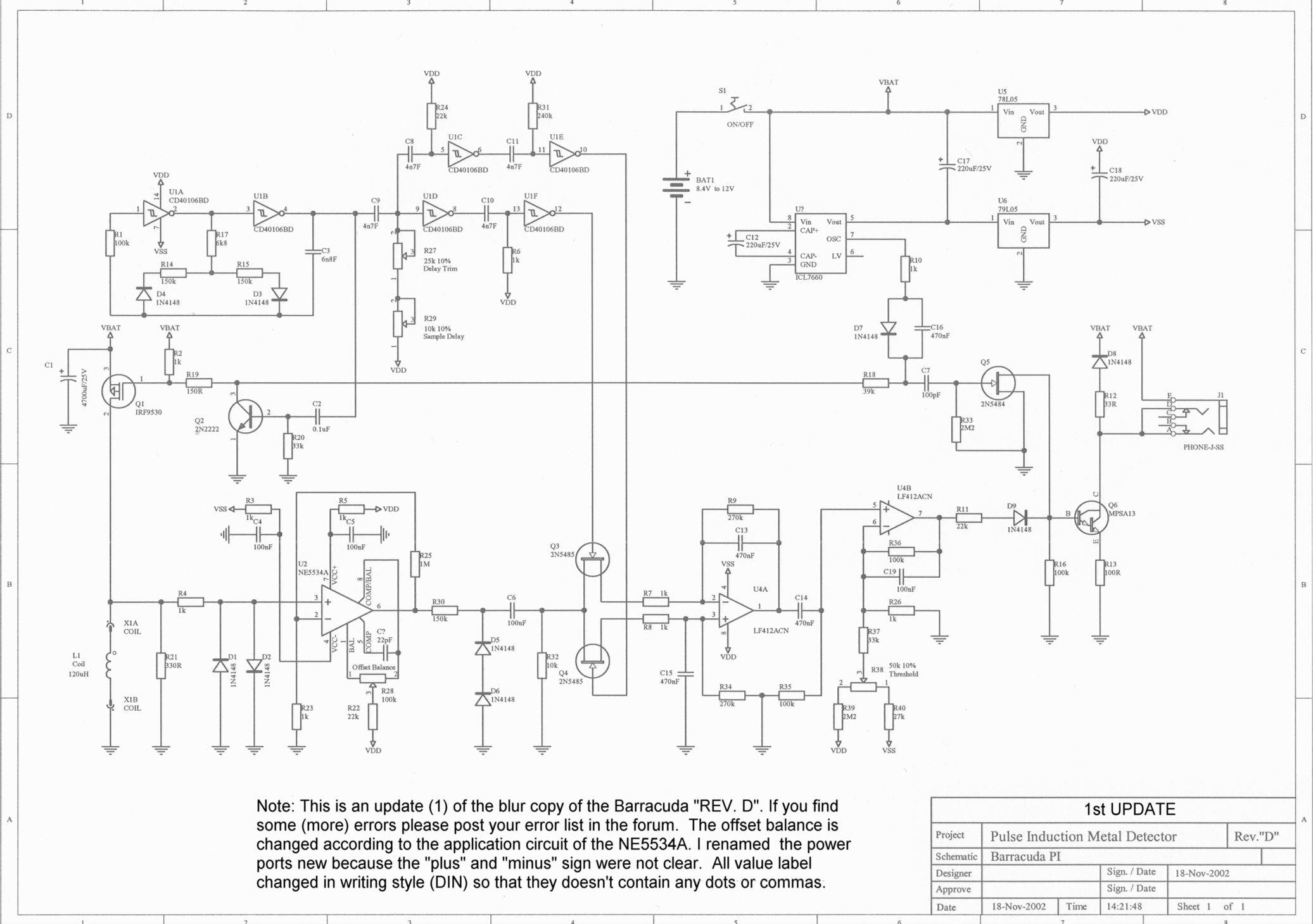

    have seen that exists habído some that another mistake in the value of two resistances. Has someone finished a barracuda?. Regards and graces(thanks)

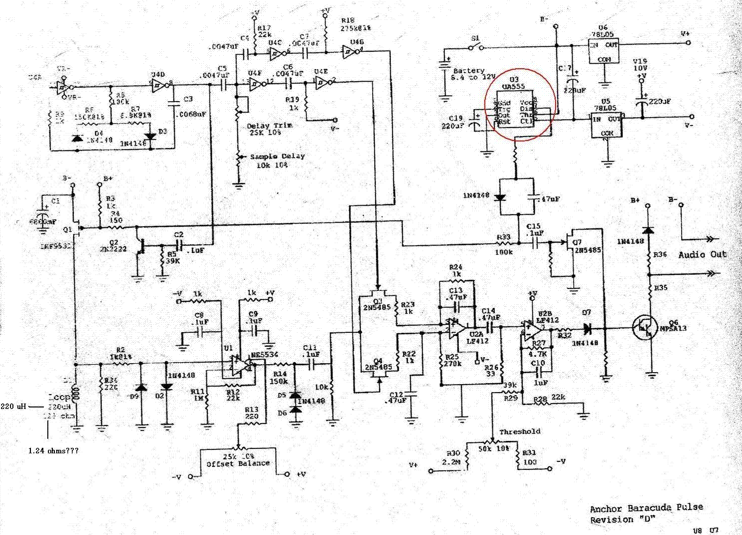

        Thank you Kt 315, but I do not understand what it(he,she) wants to say. On having returned to look at the schemes I have seen a mistake in LF412ACN.
        The polarity is reversed. Is it it?
          Ok, he(she) had forgotten to put the ICL7660. Thank you.

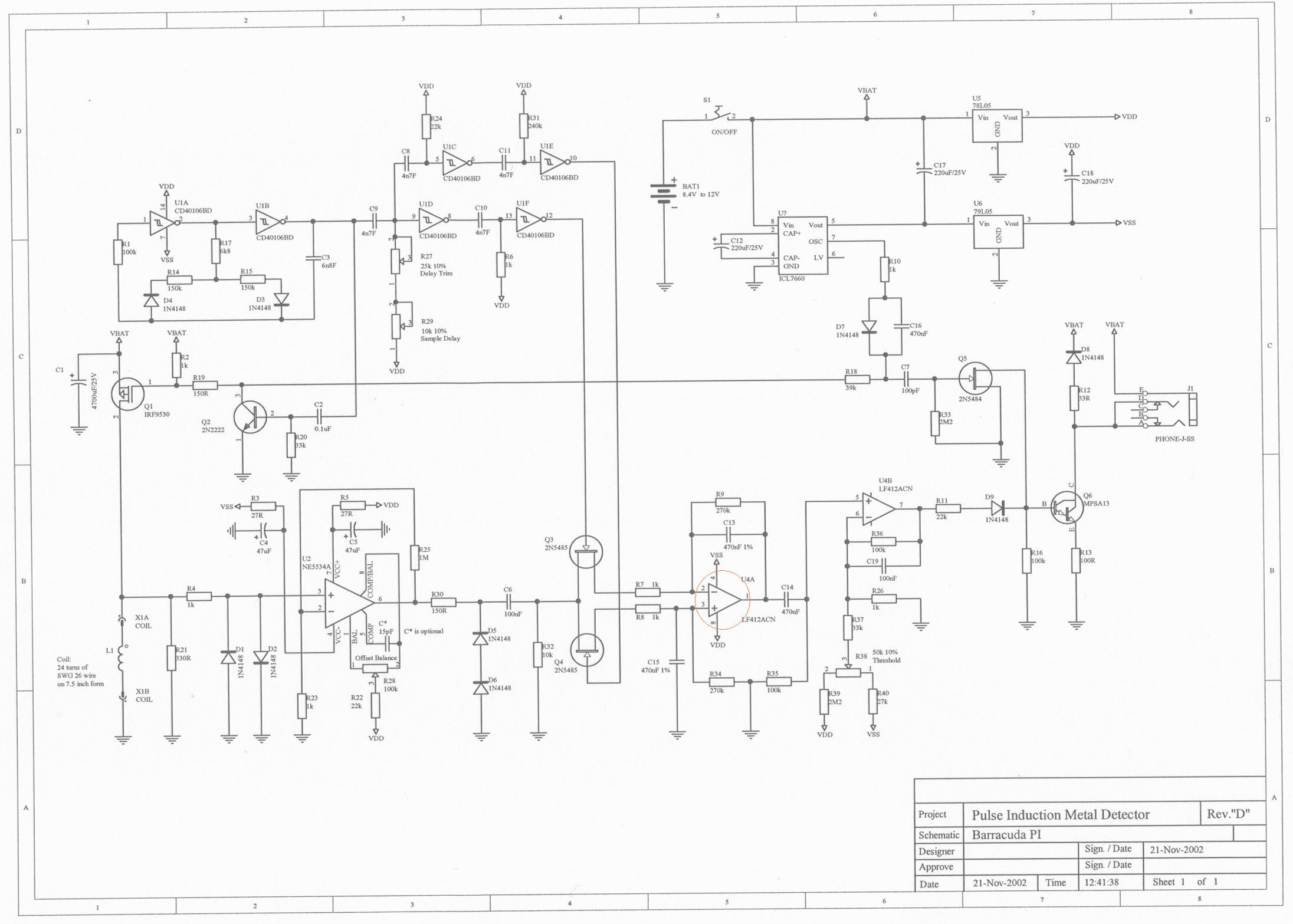

                          Hello Draco , 3 o 5 years ago i have experiment with this schematic of the geotech forum , with some adjustment in special in timing of the pulse the baracuda work fine, i say that years ago in the geothech forum ...yes i make it work ....in my homemade pulse i include some nice circuit like the modulation of the audio via pulse(via R18-R19) also the fantastick pulse control with the CD 40106 wich control wichth pulse and frecuency and delay etc..." all in one" no more lot of 4538 or with 555 ...and for the guy who say me the 4538 is more precise ...ok but no difference in the real life ...my Pi has a very stable and precise pulse with the 40106, circuit of the Baracuda..
                          Draco you must experiment 1 o 2 days and it is ok you will find all the small error of the scheme for exemple the 555 for the 7660 etc...but i cannot help you because for the years ago(my memory) and my notes very bad,and a lot of work for me actually ...What i can say this Barracuda work very well....
