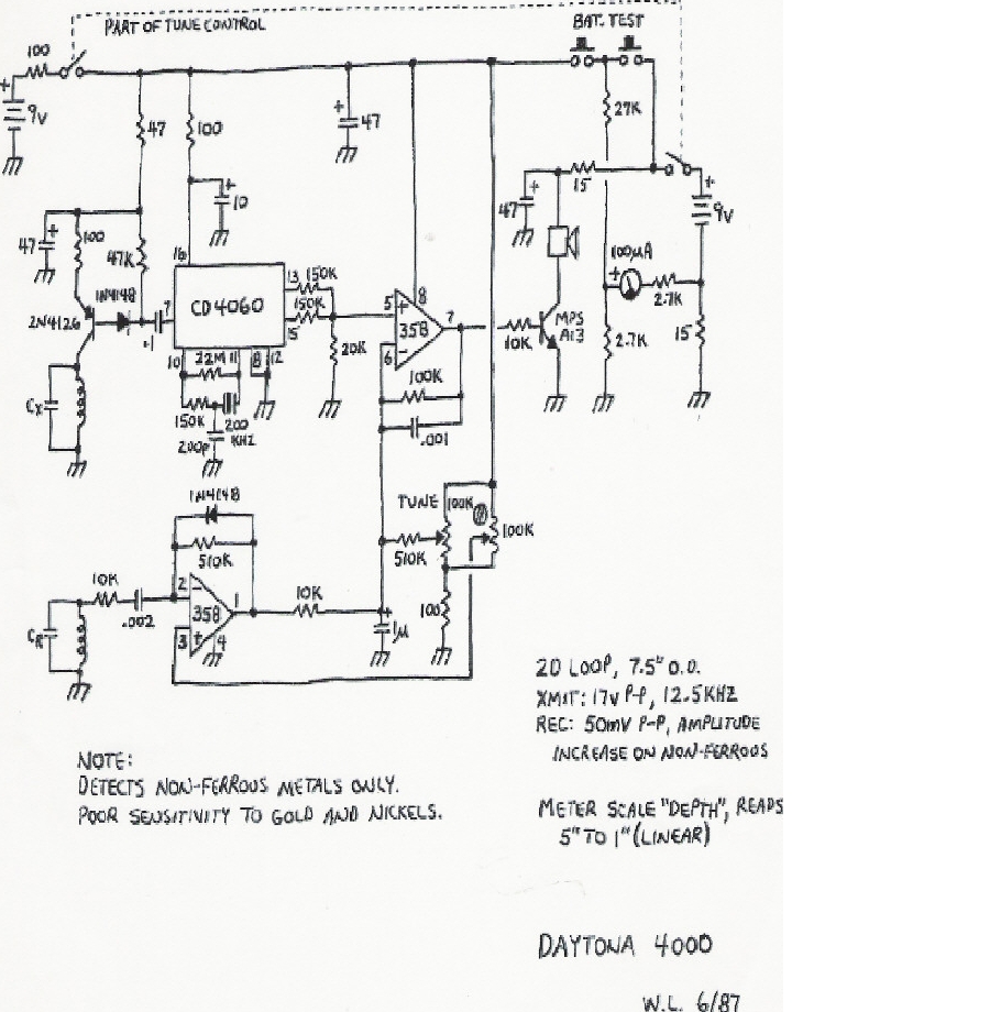

For only gold MD.
Daytona4000 gold MD
Yes... and what happening at the ferrous objects????? I believe that the amplitube increase again.Originally posted by kt315 View Post'amplitude increase on non-ferrous' is not a discovery. I see the effect in King Cobra and very clear that the detector was projected for non-ferrous IDEALLY, in my opinion.
Finally what happening ????
I just tested a DD coil. I gave signal 6.5khz with the generator and connected to the Rx coil the scope. I saw the opposite !!! Ferrous increase the signal to the Rx coil and 2 gold coins decrease it. So maybe Esteban has right.... with a little destroy of the null, we have the signal of coil to increase to ferrous or no ferrous objects.
, but i cant understand what you mean.....
