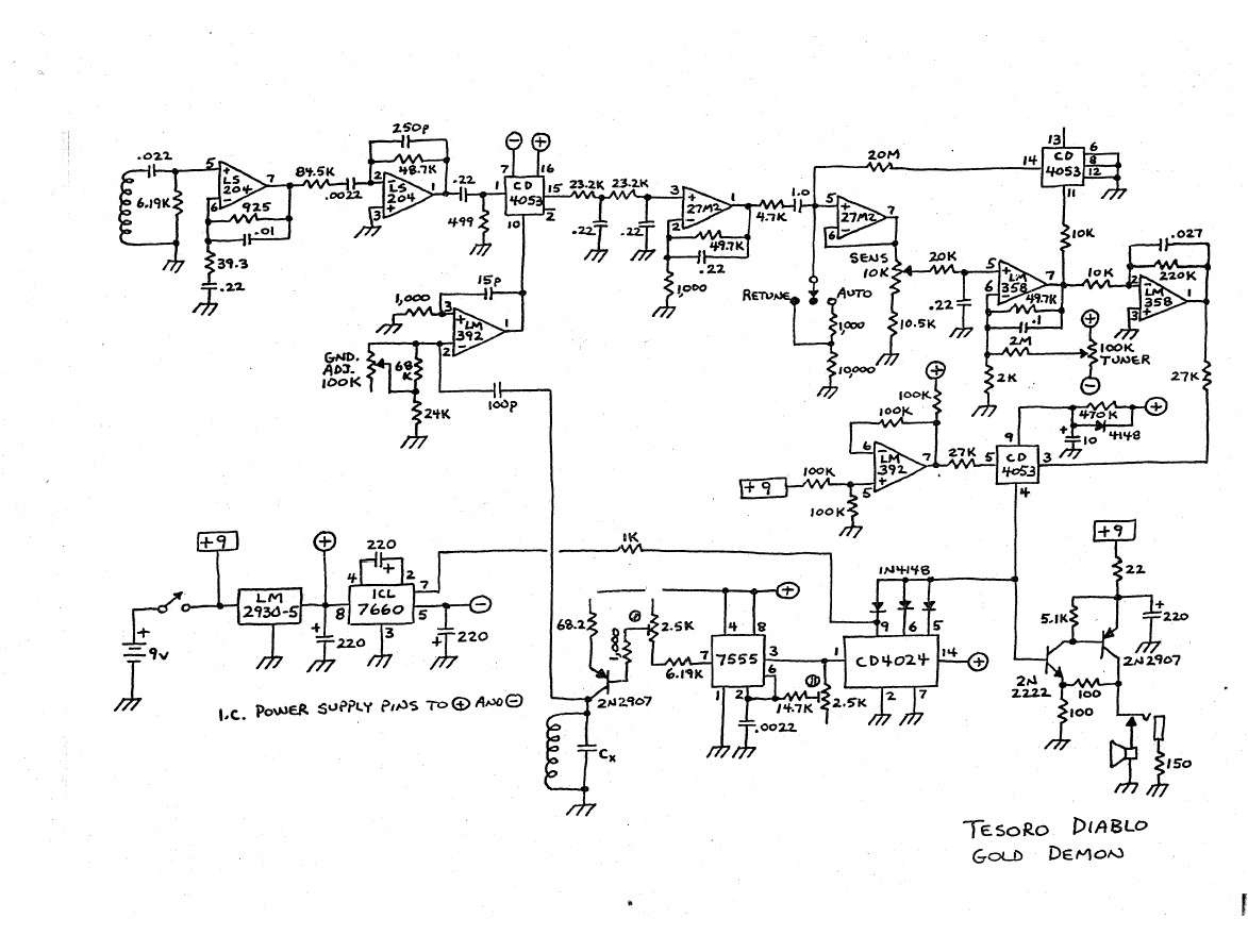

    Does anyone have the schematic for this particular model? I have a complete detector but it is virtually dead and one or two of the ics used here are not clearly legible and I need all the info I can possibly get to get it working.
    Cheers and Happy New Year to everyone on the forum.

    I have the schematic buried somewhere in a PDF Folder !!! I will post the schematic as soon as I find it . Join the forum and then you can post photos of your Tesoro Diablo . It is now a collectors item , it would be great to see some photos again of the case and the pcb circuit board. You can even post everything under the "Old Forgotten Metal Detectors Thread" of this forum ........So , I should have schematic posted tommorrow for you , I hope !!.............Happy New Year...........Eugene52
      Tesoro Diablo
      Here is the schematic from years ago..........Regards...........Eugene52

        Many thanks Eugene. I promise, as soon as I have the detector working I will post photos of the complete circuit board and the repair/s carried out. The detector is in great condition overall for its age, and would be a pity not to have it back in working condition.
