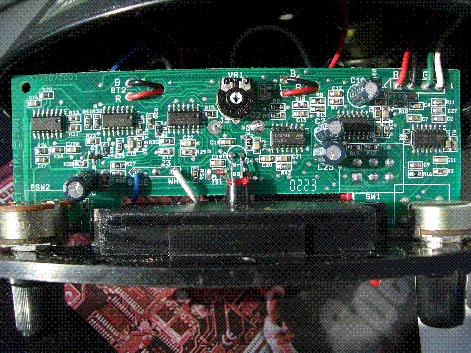

    Happy New Year Serg !! I have not seen a Tracker 4 schematic Yet , only complete pcb photos of its circuit board . And I have been collecting Metal Detector schematics since about 1999 or so . If a schematic of your model does not get posted here , you are welcome to tell us the problems or symptoms and chances are we can get it running . Especially if you have a good oscilloscope and volt-meter !!............Regards...........Eugene52

        I am still searching for a schematic , but here are two good photos of your machine which are almost identical to Wal-marts Pioneer 101 and Bounty hunters Prospector.........Regards...Eugene52

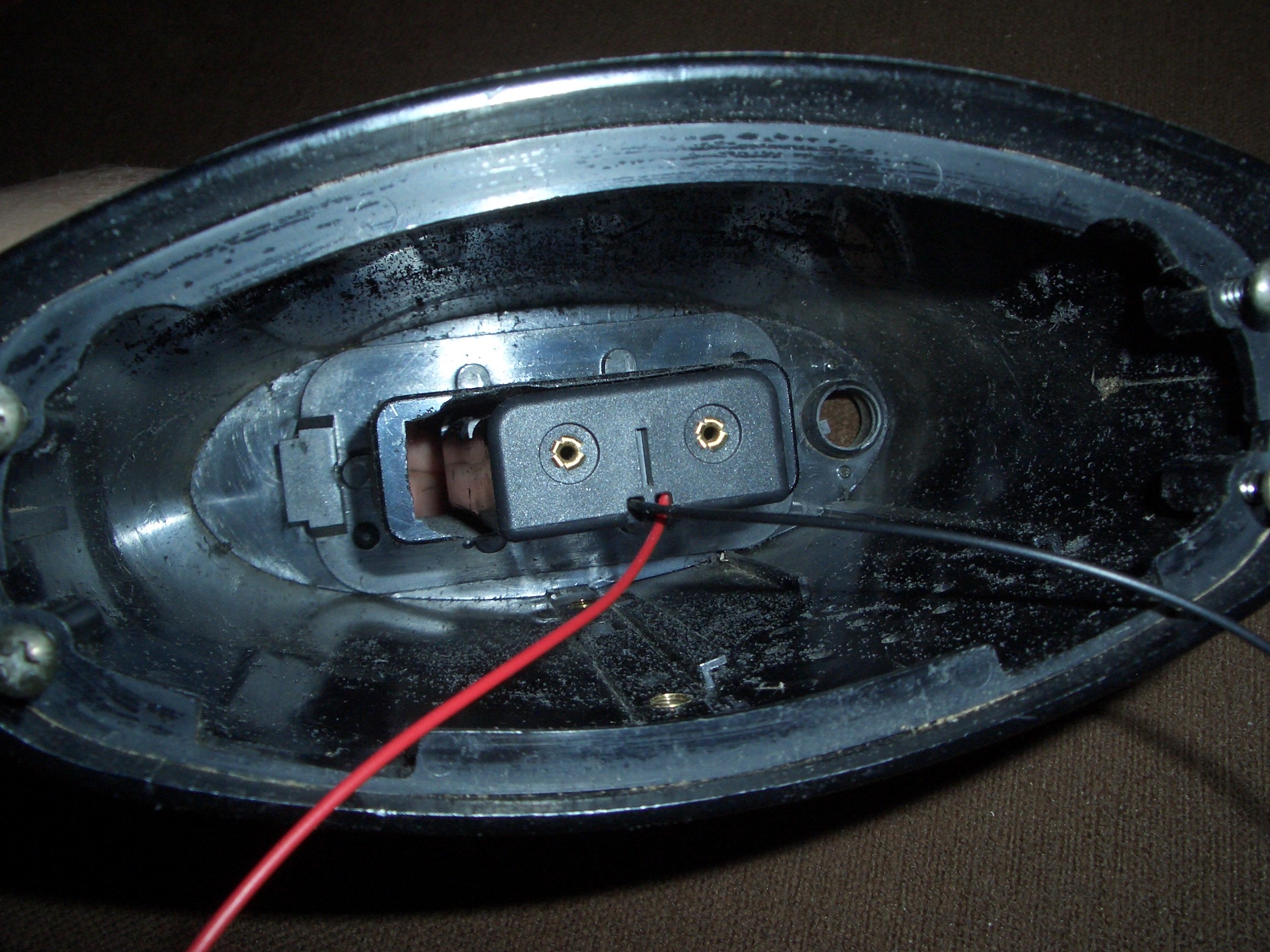

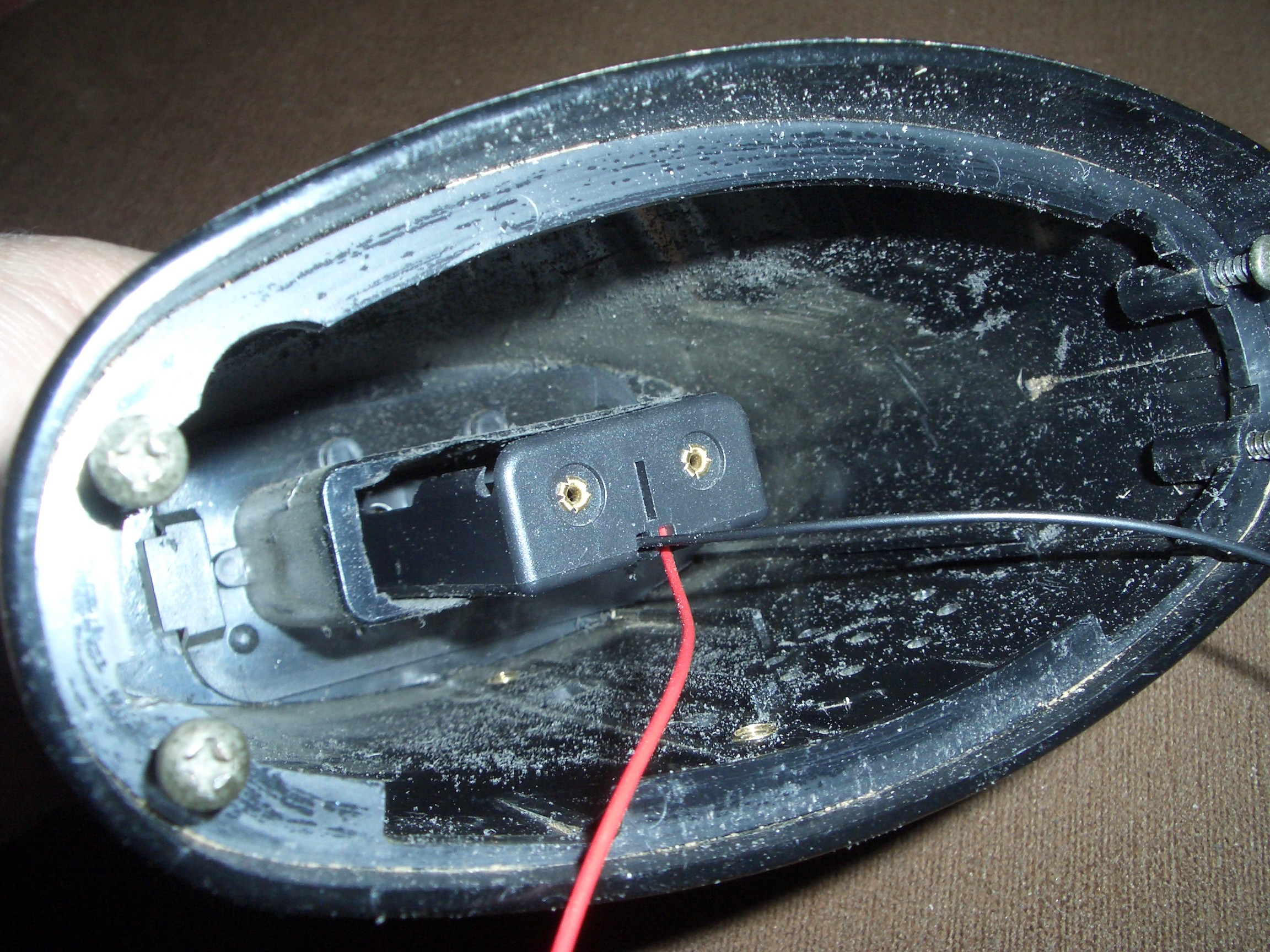

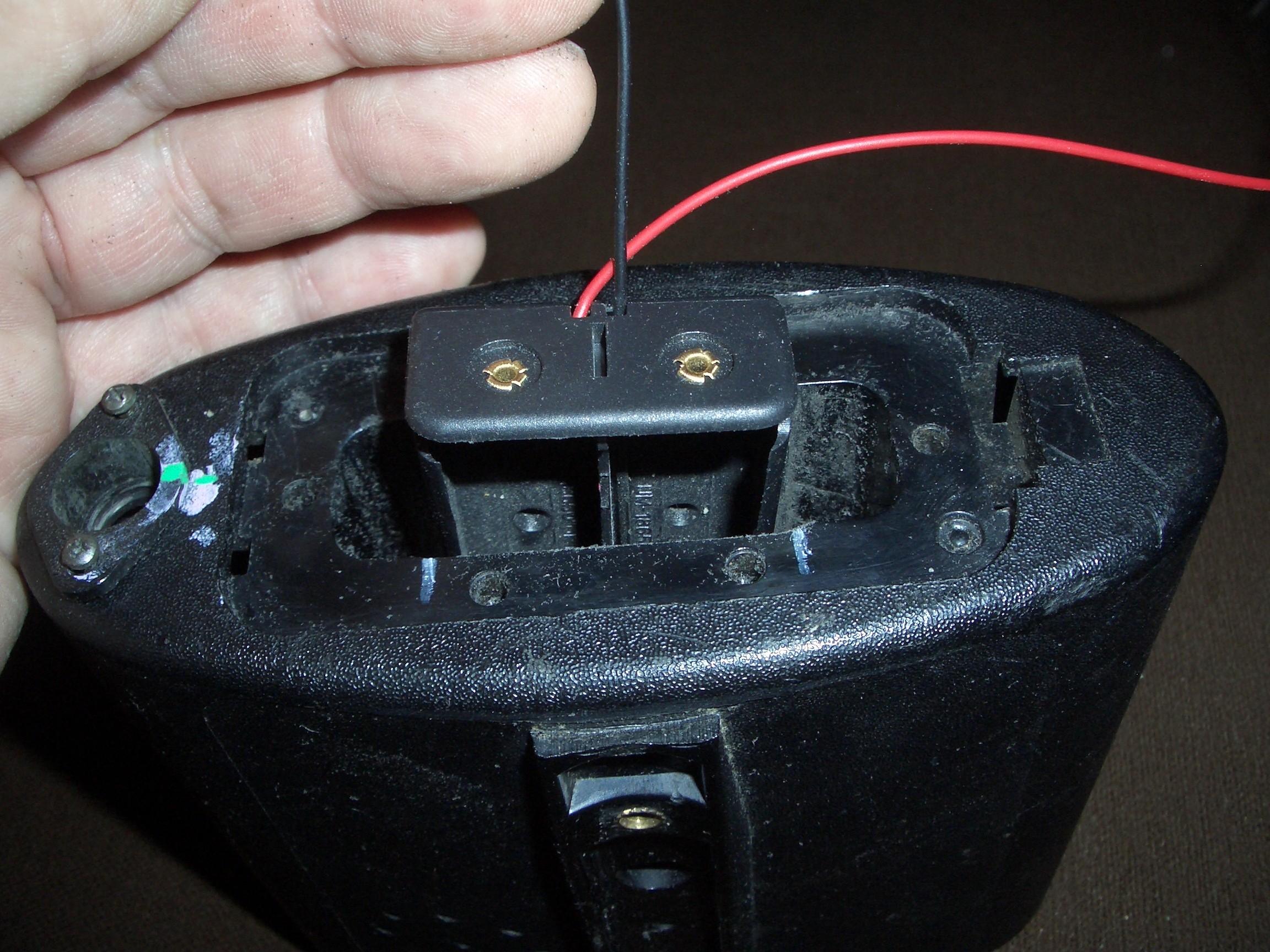

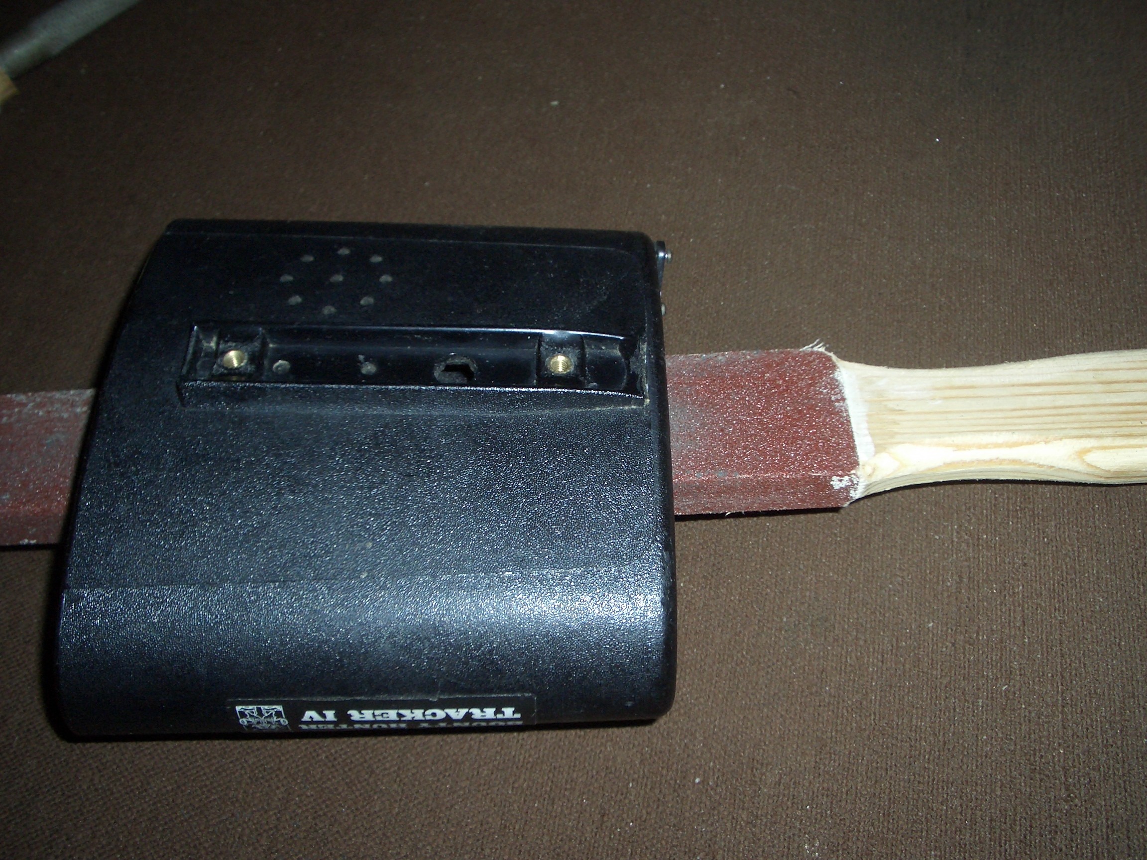

            filling i must tell you about my job. at first stage i worked by round rasp expanding batt housing/space.
              second stage. i did special rasp, from wood and sandpaper, of needed size on the place. plastic was deleted at place and holder 18650 hold up inside.
              you see result.
              the holder on two 16650s, NOT serial connected, PARALLEL. bought on ali.

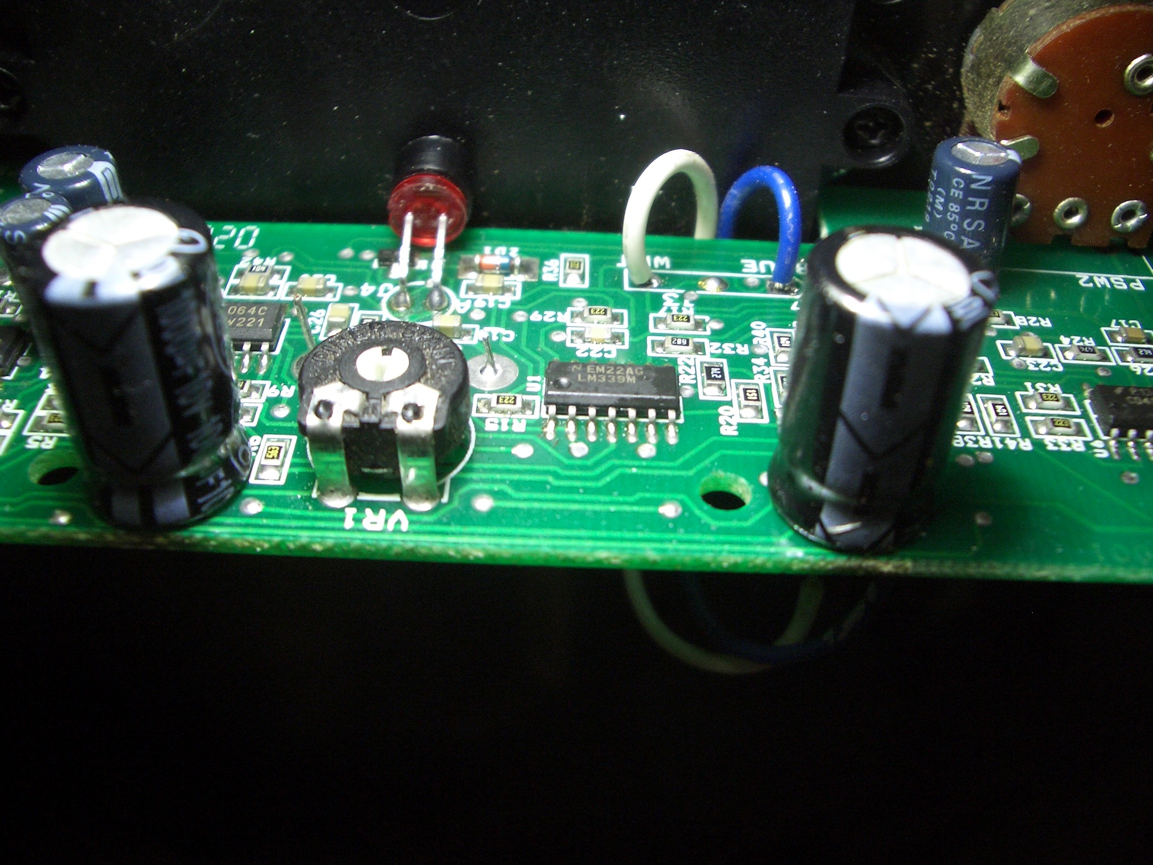

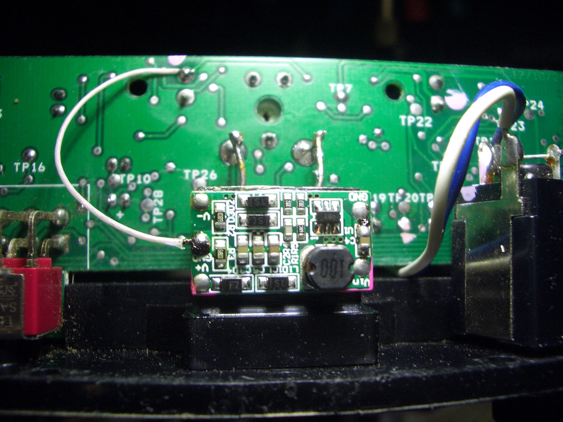

                i soldered electrolytics in pads of batts wires, 1000u 10V. converter board in the place, glued. Click image for larger version
ID:	416834 Click image for larger version
