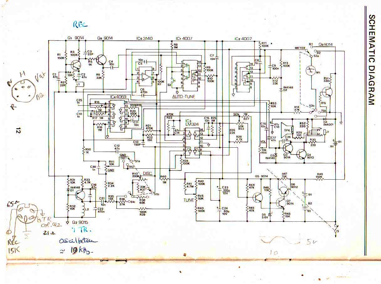

    Here is a schematic diagram for the Micronta :

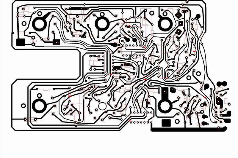

    Here is pcb for that Micronta!

          Just thought I would point out a couple of errors in the circuit.
          1. There should be no connection between IC3a pin13 and the V+ supply rail.
          2. R26 should be connected between pins 8 and 13, not between pins 10 and 14.

            On pcb or on schematic?
              It's the schematic that's wrong. It didn't look right as drawn, so I got the correction from tracing out the PCB tracks.

                I am right now in process of tracing MD3007 pcb. Tough and complicated (because pcb was drawn originally by some maniac - so bad it is), so i am using Micronta4003 and Magnum schematics also, to compare.
                Infos you gave here are of great value to me!
