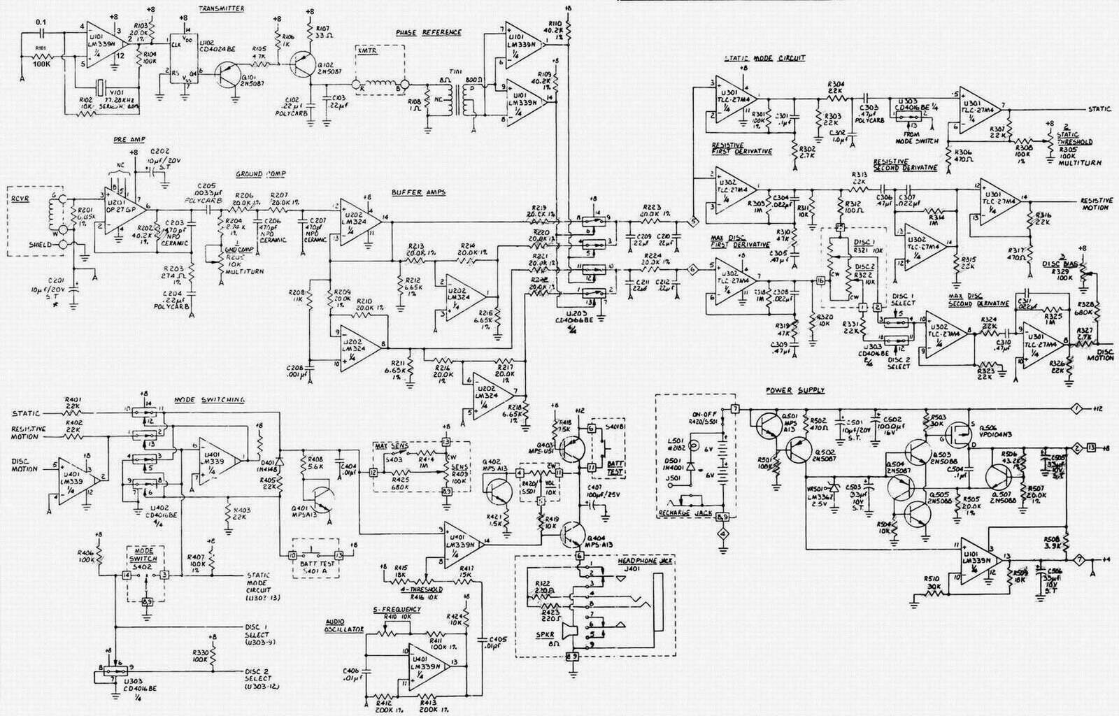

As already posted somewhere else on Geotech, I think the phase reference transformer can be completely omitted because the 339 comparators have common mode extended down to negative rail. Guess more people would build this rig if such exotic bits are removed.
