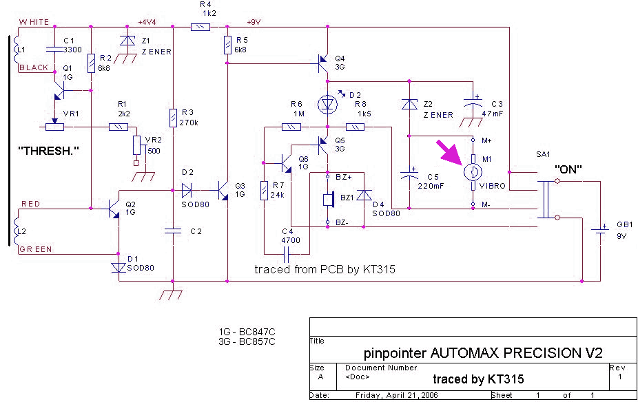

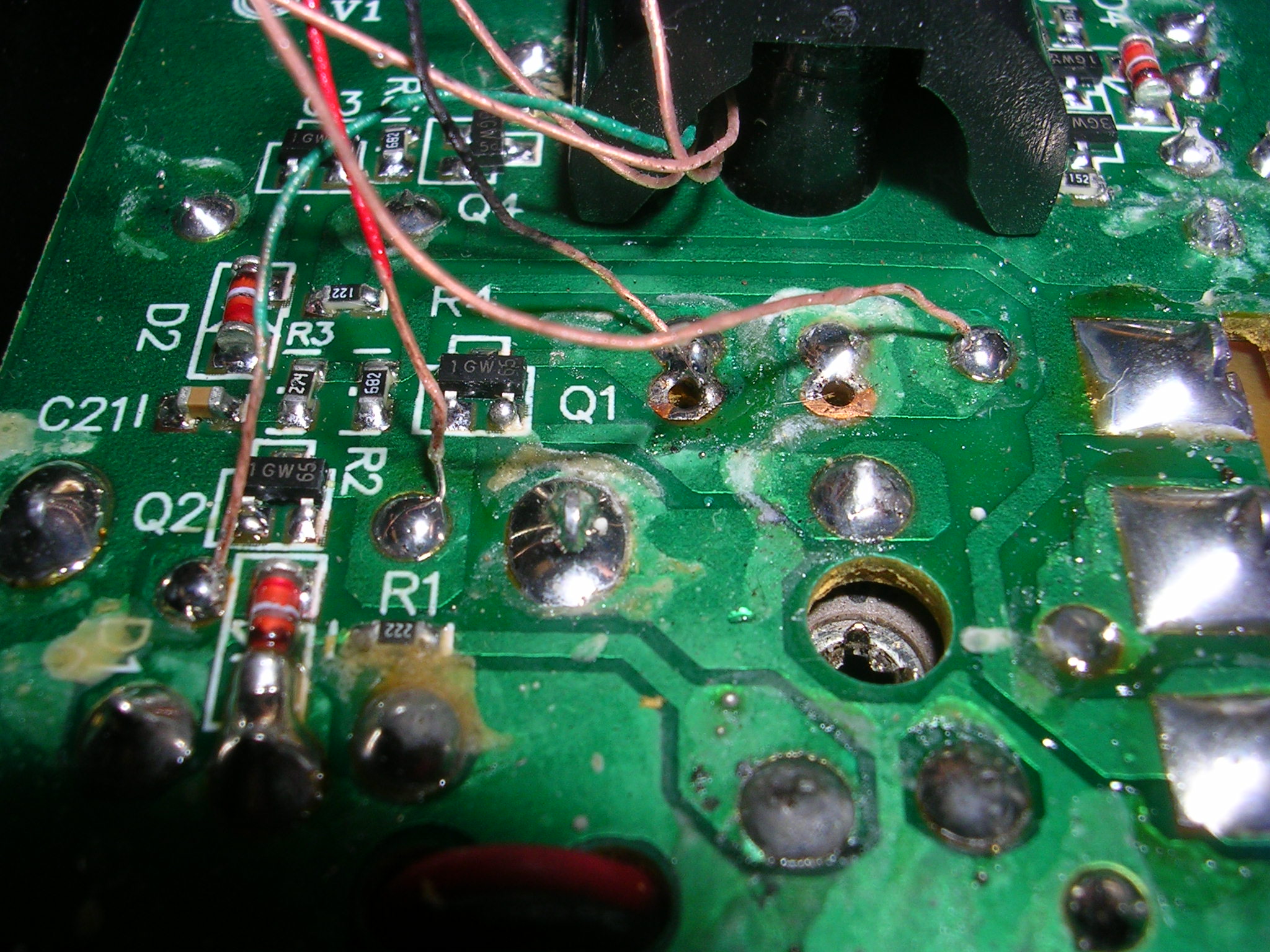

    hi i broke the wand off my v4 wich pulled the 4 wires off.can some one post a picture of one with the wires atached. thank you ahead of time
    I have one at home. I'll take a pic and post it tonight if someone doesn't beat me to it. It'll be a few hours.
        Here's the picture.
          thank you very much for the fast replays.that is exactly what i was looking for
