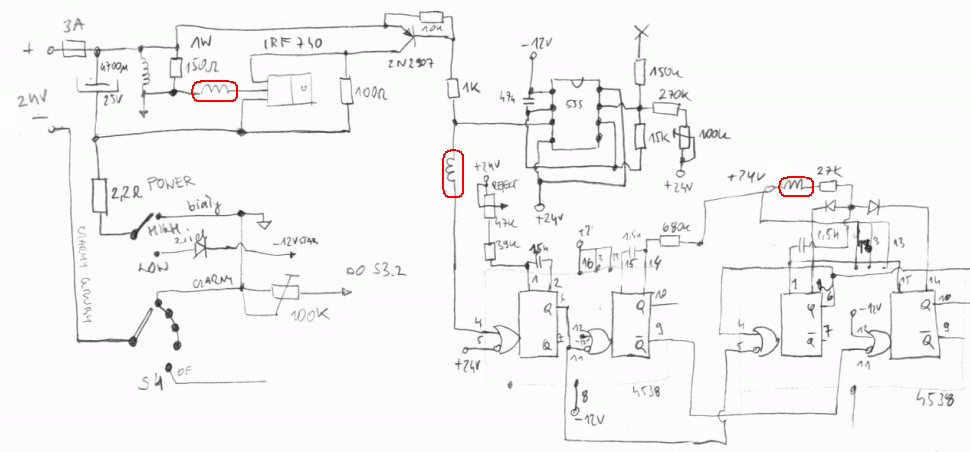

              Does enyone have a single side pcb for superscan ?
              Strujas, the pcb of Superscan traced by Rospy is single sided. Note that Rospy shows in the above circuits a lot of useless RF chokes. This is not true, the circuit contains no chokes. In reality these components are resistors with zero resistance, ie 0R0. They are used instead wire connections because pcb is single sided.

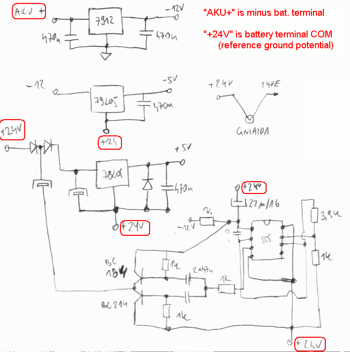

                        Hello Forum,
                        Before to have PCB , let draw a decent schematic because many notations
                        it is not understanding because not English...and many connections you did not know where they goes.....
                        i did propose to draw slowly a good schematic together....
                        and after it will be more more easy to draw the pcb !!!
                        have a nice day,
                        Alexis.

                            That drawing is a bad joke. I want to hear about what happens when somebody puts +24VDC into one end of an LM555 device and -12VDC on the other end. Same goes for the CD4538, CD4066, and etcetera.
                            "Oh I built the Superscan according to this drawing but it does not work. What could be wrong? Something smells funny when I turn it on."
                            Bwaaa haaa haaa.
                            • #44
                              Bwaaa haaa haaa.
                              Porkluvr, Supply schematic is designed correct.
                              The circuit is powered by three regulated rails: minus 12V, minus 5V and +5V. Incorrect and misleading is only the designation of battery terminals. The plus battery terminal instead +24V should be noted as GND, COM or zero. The minus battery terminal should be noted as -24V or more correct as -Bat.
                              • #45
                                Well. That's just plain crazy, but I know you're right.
                                It appears that according to arithmetic of the schematic artist, 12V + |-12V| = 12V, or something like that. That's about as clear as mud, but I can live with it.
                                It would have made more sense to call the supply rails something like Marylou, Dietmar, and Fritz and thereby not defy basic laws of mathematics, but that's just an opinion.
