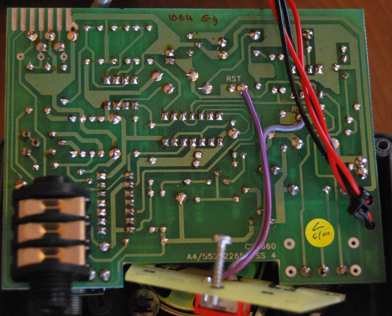

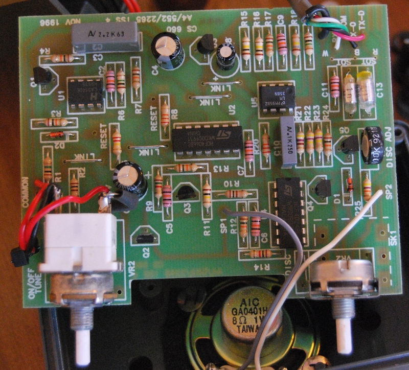

                        Hi Rumcajs,
                        You are right about the R12 & R13, they're 10K resistors.
                        But not for the other points, please see the photos of the pcb.

                          Hi Hugo,
                          many thanks for reply and photos!
                          Ok, making an error-free drawing from an panel is not easy, but very good gymnastics.
                          Im just interested, how does this circuit and unusual solutions to meet me. For example, still do not understand the operation of Q3 without power.
                          It seems that to reduce the cost of mass production have been simplified to the extreme.
                          In the second photo, I found a capacity of 0.1 microFarads (100nF) part (between the LM358 and 4024 -- C18?) did not find that the drawing.
                          Rumcajs
                            Hi Rumjacs,
                            Yes, I've forgotten to draw C10. It filters the supply of U1 (+5V and 0V).
                            About Q3, IMHO, the transistor is powered ... from 0V to -9V (Through Q2).
                            Hugo
