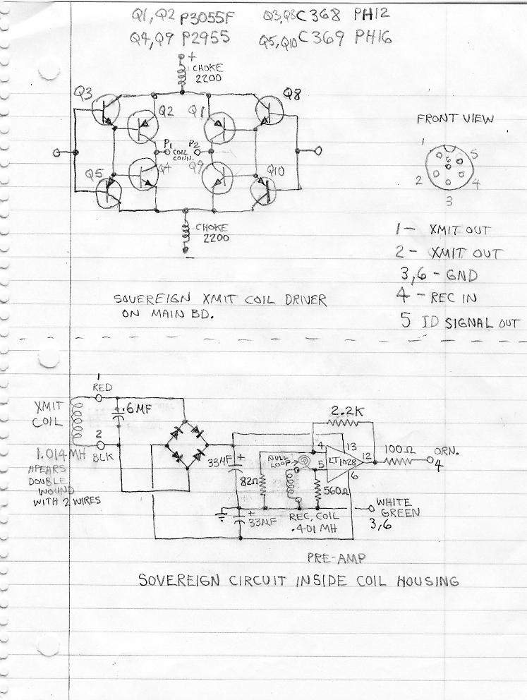

    I posted some partial Sovereign schematics back in 2004. Has anyone else added any post since then? I really want to get back into this project. I went to Ukraine in 2006 and found a new wife so I have been side tracked for a while now. I was recently laid off and I can not believe how hard that it is now for an experienced Electronics Technician to find a job. It is something that I have not had any problems with before in my life. The way things are going it looks like I will have a lot of free time for a while and I am going to continue tracing out the old Sovereign and try to produce a complete schematic. Is anyone else still interested in this detector?

        Count me interested!
          Me too. I am mostly interested to se analogue part!
