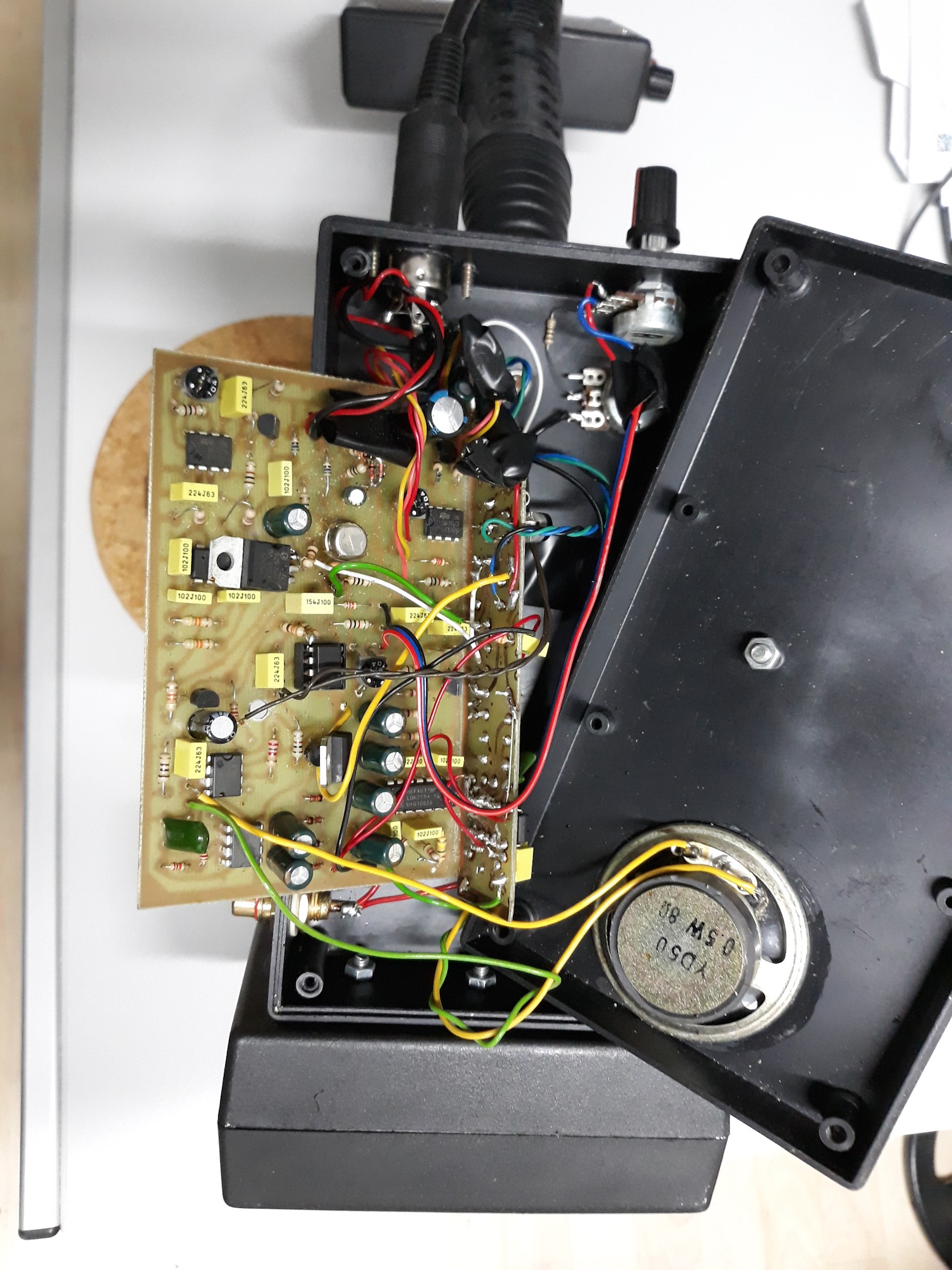

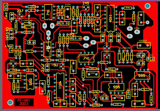

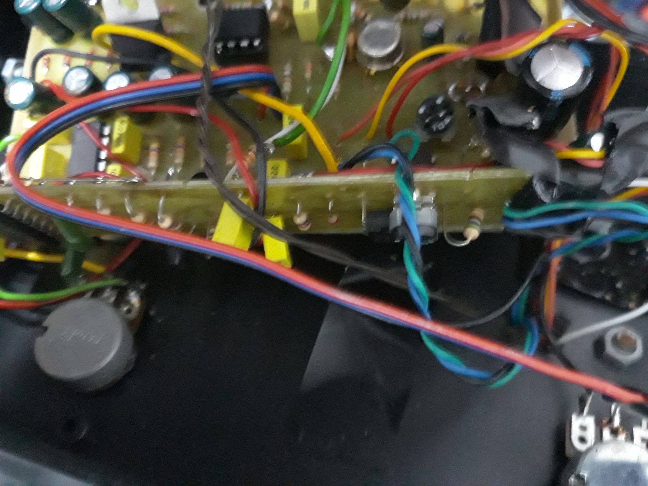

              Here are two images of the actual PCB.... The detector, I guess was sold under the name "RAMSTAR I" from Poland. It is actually a "PI Polones" with a kind of "discrimination" feature.
              The detector PCB is very crude made but it works fine. The component positions from the image is almost identically to the PI-WKL 2003 PCB.

                Most PI metal detectors that I have seen do not have good discrimination .
                They have an approximate discrimination.​
                  PI do not discriminate .I have not met any pi that discriminate,it is always a deception, get the distance of discriminate ok and it you moves a few centimeters the result change....

                            Hi ZOUjiarui,
                            what complete information do you want? I have actually not much information on this detector at all. I purchased this used detector from an old lady in the neighbourhood for a few bugs here in Germany. I only saw one very similar detector on YouTube and this one called Ramstar 3 or 4. This was almost identical in making like the one I have and this came from Poland. Inside this detector is nothing much as a PI-Polones circuit with some kind of “discrimination features”. But of course it is not a real discrimination feature, just some delay in the timing circuit.
