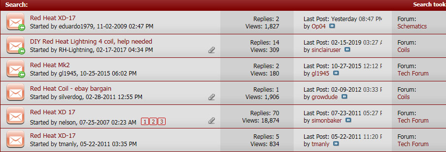

    do not be so nerve... there have been people who asked kinda you... get your head up... find by eyes a word Search... use...
      I've been searching for this xd17, does anyone has schematic / PCB for this?
        good searched?

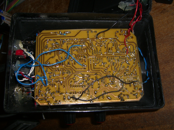

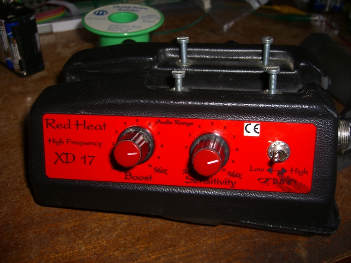

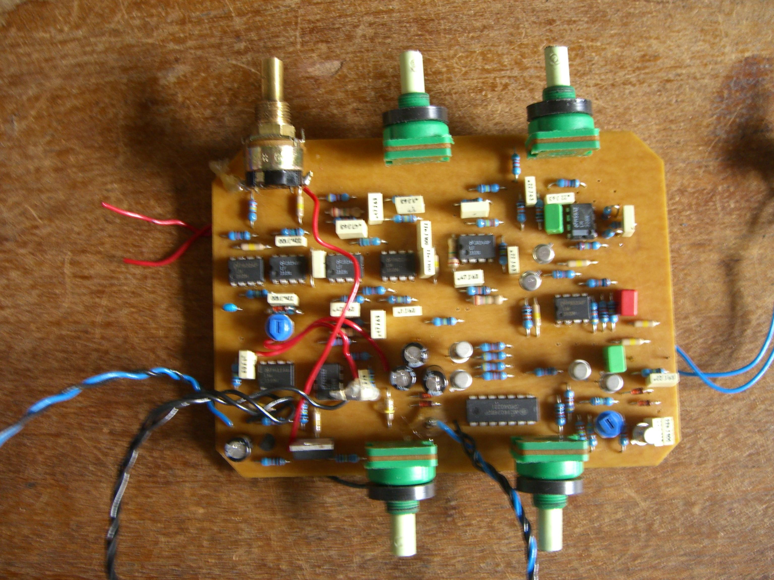

                Thanks. That schematic must be on the Geotech forum somewhere, as I already have a copy in my archive.
                However, there is no associated PCB layout.
                The problem with these Red Heat detectors is that they were all custom made by the designer Vic Fiveash, who passed away in 2007. The PCBs were not made from a set of Gerber files, but were etched by Vic using nasty chemicals. As a consequence there are many variations around.
                As an example I've attached some photos of an XD-17 which I repaired for someone. The detector did not match the schematic exactly.

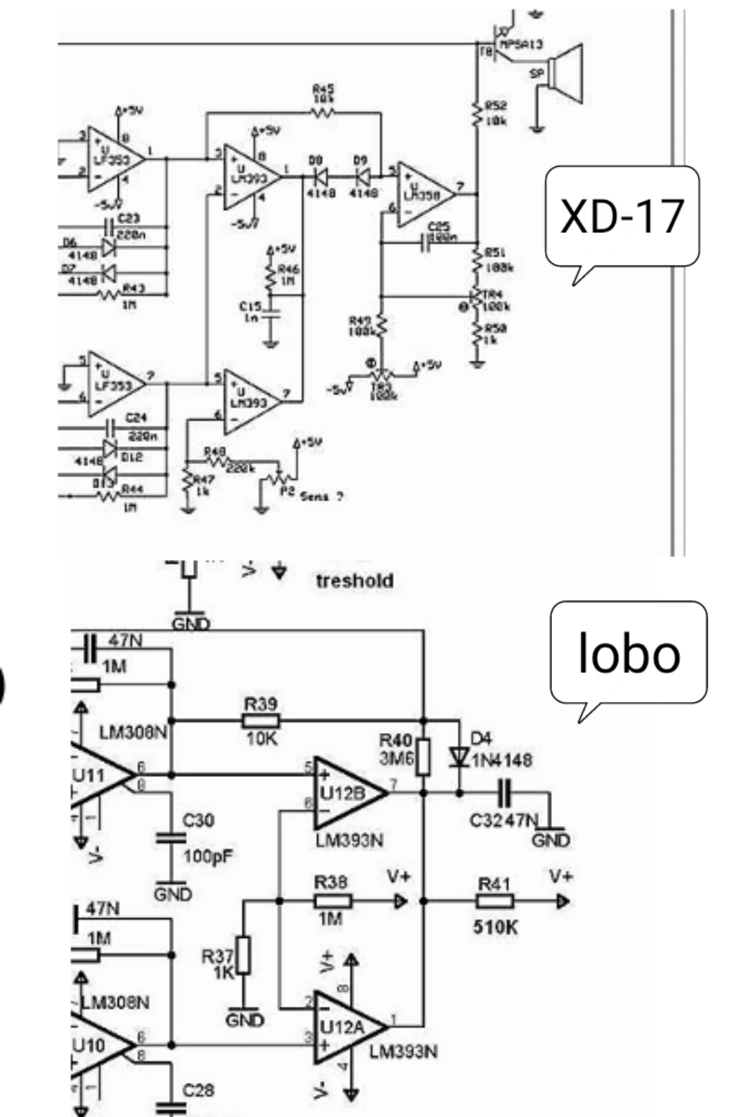

                  That's really cool!! Thank you so much, I really appreciate it. From the sch, I think there are wrong connected between last section of comparator, I put comparison between xd and lobo. I still not much time to trace with dxp, this will be saving for future project, unless someone here trace it.

                    Legendary and a prized detector in the UK, in the day.... The builder past away a number of years ago and he took everything with him.
                    Red Heat Metal Detector- made by the world famous technician Vic Fiveash. Every detector was custom built to perfection by him. Red Heat first started manufacturing metal detectors over 20 years ago in Great Britain. Their first detectors were designed to go thru the Thames foreshore area. This site was not for newcomers, only the most experienced detectorist would even attempt it because of the thousands of years of trash, coke, and iron. When the Red Heat detector functioned so well in such contamination they knew these machines were special. Very Rare Metal Detector and extremely hard to come by. One of the best see thru iron machines ever made. Vic Fiveash passed away in 2007. .

                      Looking at the diagram, this HEAT XD-17 looks like it is a Tesoro metal detector.
                        That was my conclusion as well, that all Red Heat detectors are derivatives of Tesoro designs.

                          Definitely a tesoro clone.
