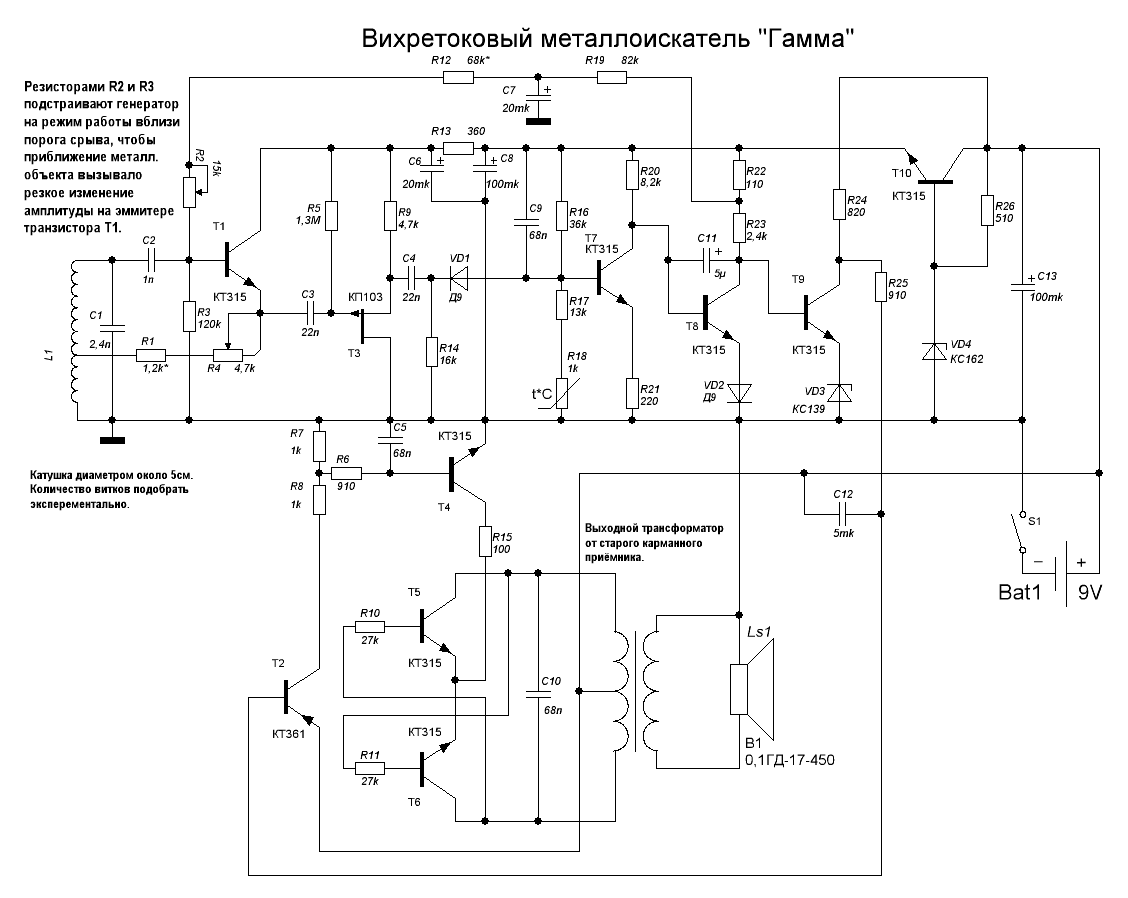

    It`s old but sensitive russian pinpointer. I made it several years ago and it worked. May be this sircuit will be useful for somebody...
    fantastico, veamos que dice esteban de esto, creo que con algunas modificaciones, ahora resultara superior a muchos que andan por ahi
      creo que este le va a gustar a esteban, hey gervm, i quest, have this falses'? what range? ground effect? is stable? is critic? what comsuption? what ohms transformer, what ohms coils, etc, thanks brodhy in advance for attention
        time after i think this is very critic for put in function, what you say? very much components,
          This devise was made for needs of the soviet state. It`s enough stable and sensitive. This detector was made as handset, it had litle coil (~5cm in diametre) at the end. As you see they even made termocompensation - R18. This detector is very sensitive to litle targets as litle coins etc. When I was making it I used transformer from litle poket radio. I think it`s "construction of sunday morning" but it can be useful for archeological needs.
