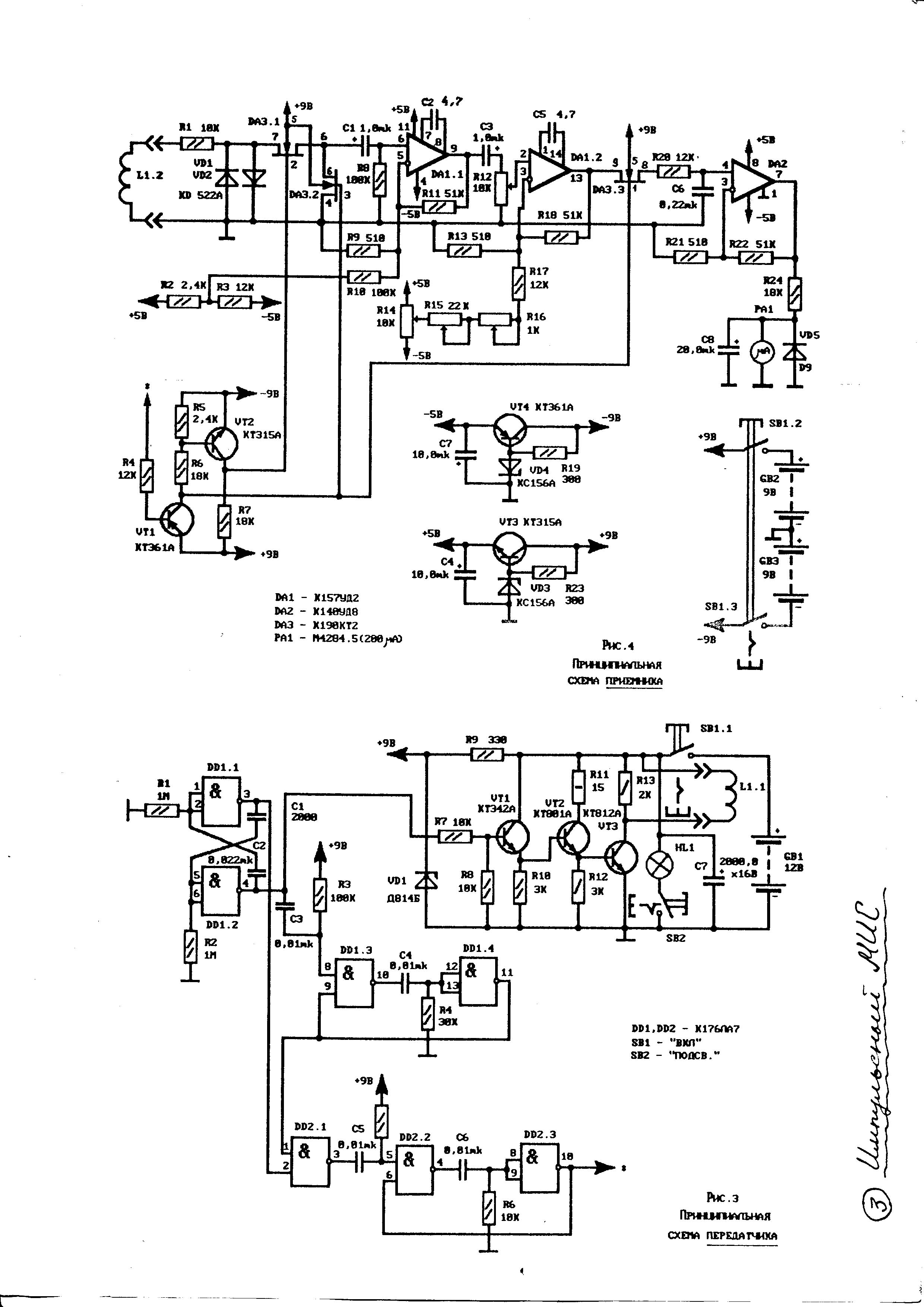

The transmiting and delay part of this circuit enough good but unit has not audio output. But I think it may be interesting when you designing your own.
